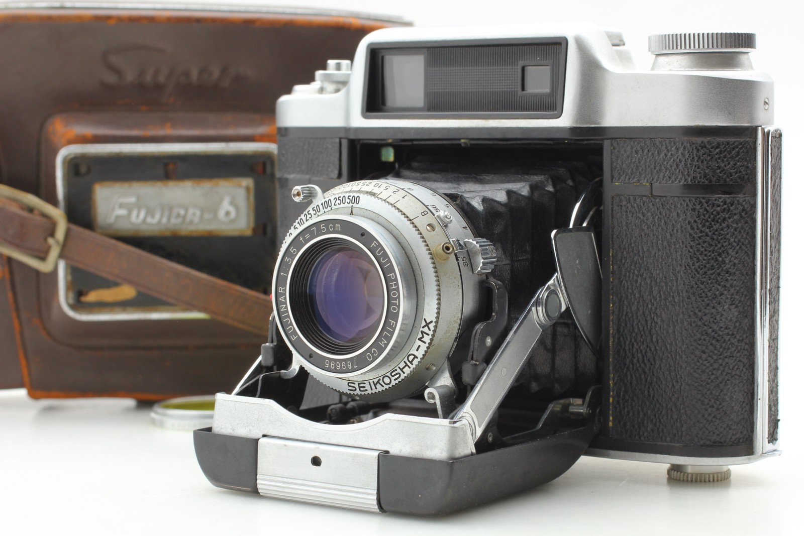

Super Fujica Six?

What is lower cost range for your budget, and how portable, is portable? I have a late model Yashica 124 that has a MC lens, I think the later Minotla TLR are also MC with great lens. As mentioned the Bronica SQ, then there is the Kowa 66 and Super 66, the Mamiya 220 and 330 TLRs, all can be hand held, lens are MC, are less expensive than a Mamiya 6, the late interchangable lens model not the 50s fixed lens version which I think was well signle coated or Hasselblad. I like my Yashica 124, but I had to flock the interior to cut down on interior reflection. For portablity and cost, as also mentioned the Fuji Super 6. the rangefinder model.

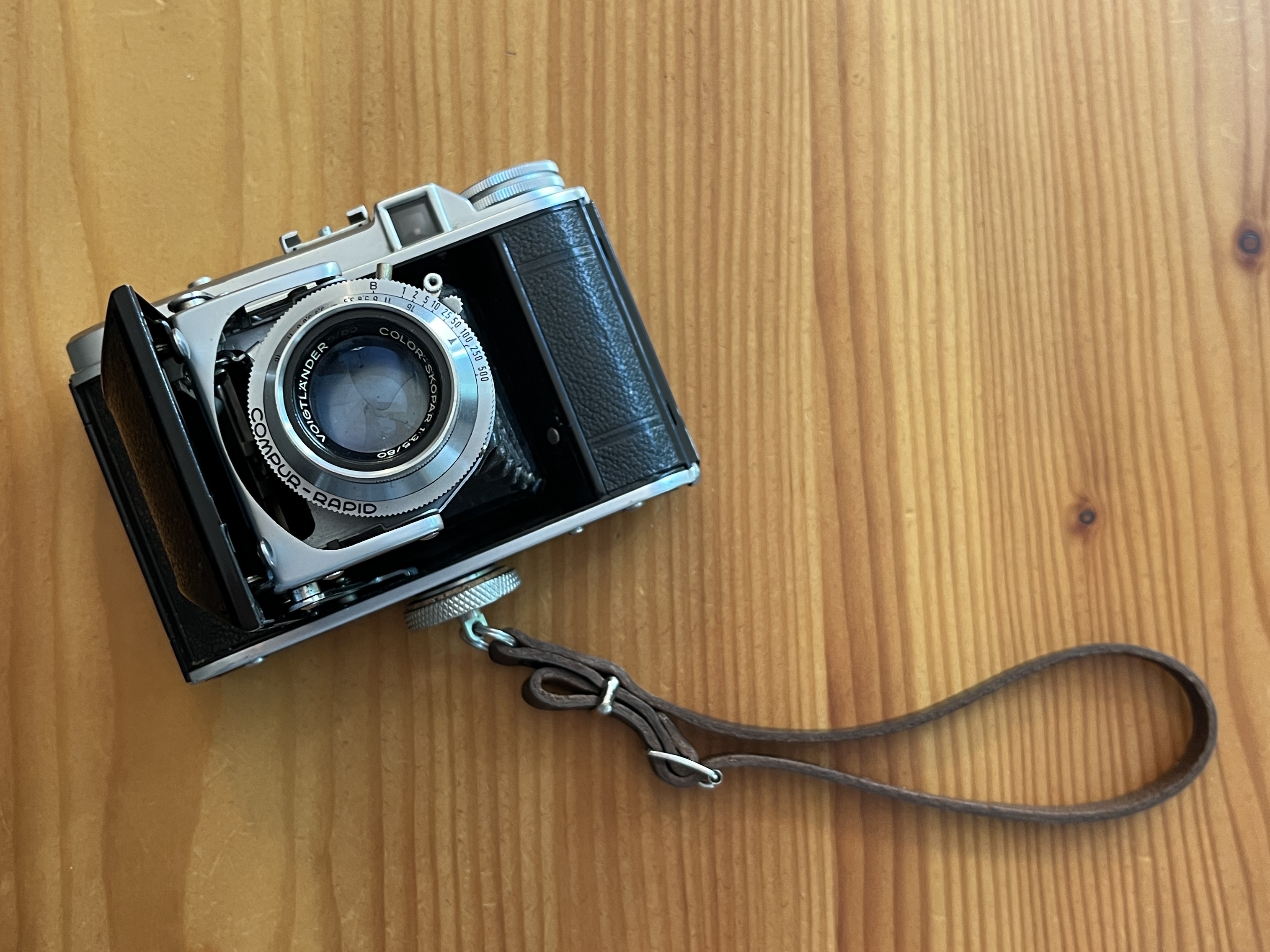

I shoot only B&W in my Zeiss Super Ikonta III, but I've always been happy with the results.
Voigtlander Perkeo ll, Color Skopar....
