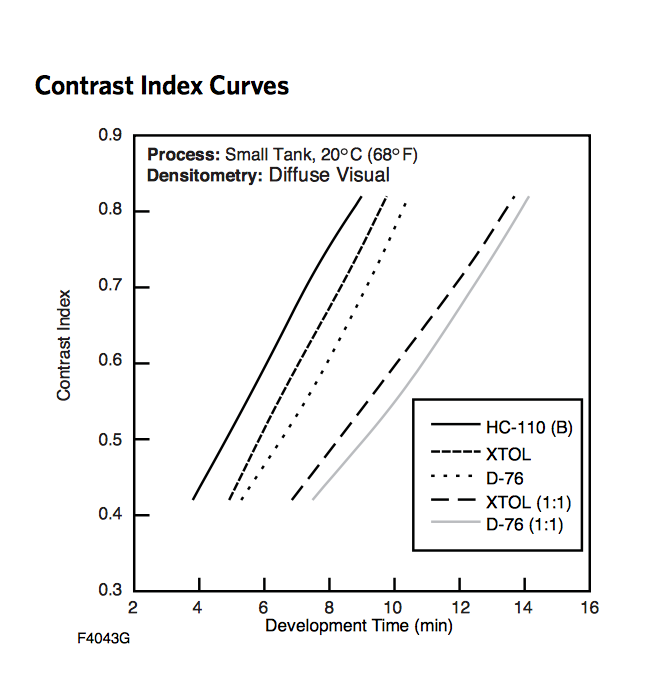

If I give more development time than the recommended, will that improve the result and if so, by what percentage should I increase the development time?
This graph is for T-max 400. It might provide a rough guide. It shows roughly 1:1 ratio for development time and contrast index for non-diluted developers. So, if you want contrast index up by 20%, increase development time 20%.

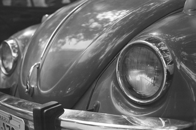

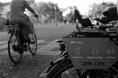

Hi, I thought I'd report back with some test photos at ISOs 25 through to 400. The following are raw scans (made for scientific purposes only!) of the 400 ISO film developed for 30% more than the recommended time. I think the best negative is at ISO 25! I wonder if you agree and if you think I should go up to 50% extra time on the next roll to increase the contrast even more? The camera was a Minox 35 GT. Here they are:
ISO 400
ISO 200
ISO 100
ISO 50
ISO 25
pentaxuser
May 9, 2005
19,909
Daventry, No
If these are a true reflection of the negs at various speeds then I'd pick the EI 25 as the best. If your developer time is correct for this no name 400 film then this stuff is in no way 400 film. Unless you are happy with losing 4 stops I'd ditch this film. A film rated at 25 for most of the time in the U.K. has severe limitations but in sunny Brazil may be OK. This stuff looks as if it would fail to meet the U.K.'s Trade Descriptions Act as 400 film :D.
If it were I, then unless this is was the best I could get without creating severe money problems for myself, I'd buy a decent fresh film and fresh developer and enjoy my photography even if it meant taking less photos
pentaxuser
Thanks and well yes, I won't be using this for anything too important, but with seven rolls left, it may come in handy for something, on a sunny day! It was in Paris that I bought the film - I'm sure it would break a few EU regulations as well....

I should have added that in picking the EI 25 as the best, it was very good at that speed. So if you have 7 rolls and the right light levels for an EI 25 film then, yes, I'd use it as well rather than throw it out. By ditching I meant that I would not bother buying more of it.

personally i think it looks really nice, smooth tonality.
having a lot of mid tones give you more flexibility than having higher contrast film.
having had the opportunity of printing ( in a darkroom and using a computer ) films that have less contrast
are easier to print than their higher contrast cousin...
the last batch you uploaded looks really nice, iso25 looks just about perfect ! :smile:

best neg at 25... and it's a gorgeous negative

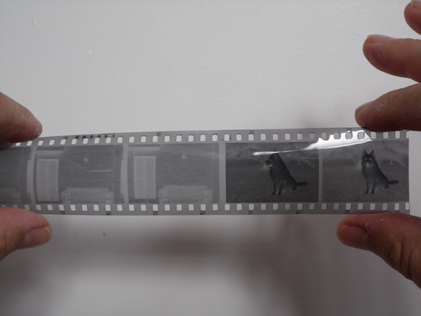

A bit late, but, as in all such threads (why are my negatives so...) you should show a straight (smartphone?) picture your negative (encompassing 3-4 frames), in front of (but not stuck against) a white wall. With the familiar reference of the hand holding the film, it would be much easier to judge shadow density, contrast, etc. Your experiment nicely establishes that your film is best exposed 25-50 ISO, but we have no clue as to the contrast.
Thanks:
From right to left: ISO 50, 25, 400, 200

Thank you for providing the photo! Looking at the EI 25 frame, and considering it was shot under an overcast light (no shadows), the contrast is not obviously wrong as far as I can see. I was curious, because that device that shall remain nameless can deliver surprisingly good results from thin negatives.
So you have a nominally ISO 400 film that performs like an ISO 25 film. See if you can find on your film canister, under the lip and above the barcode, a 6-digit number. If yes, go to: industrieplus.net/dxdatabase/ to find out what your film really is.
Well this is fun. The code is 013994, which shows up as the film of a certain French photographic store, but also, of the non-discontinued films, "Fomapan 400 ProfiLine Action T400" and "Arista EDU Ultra 400". Are all 3 the same film under different names?
