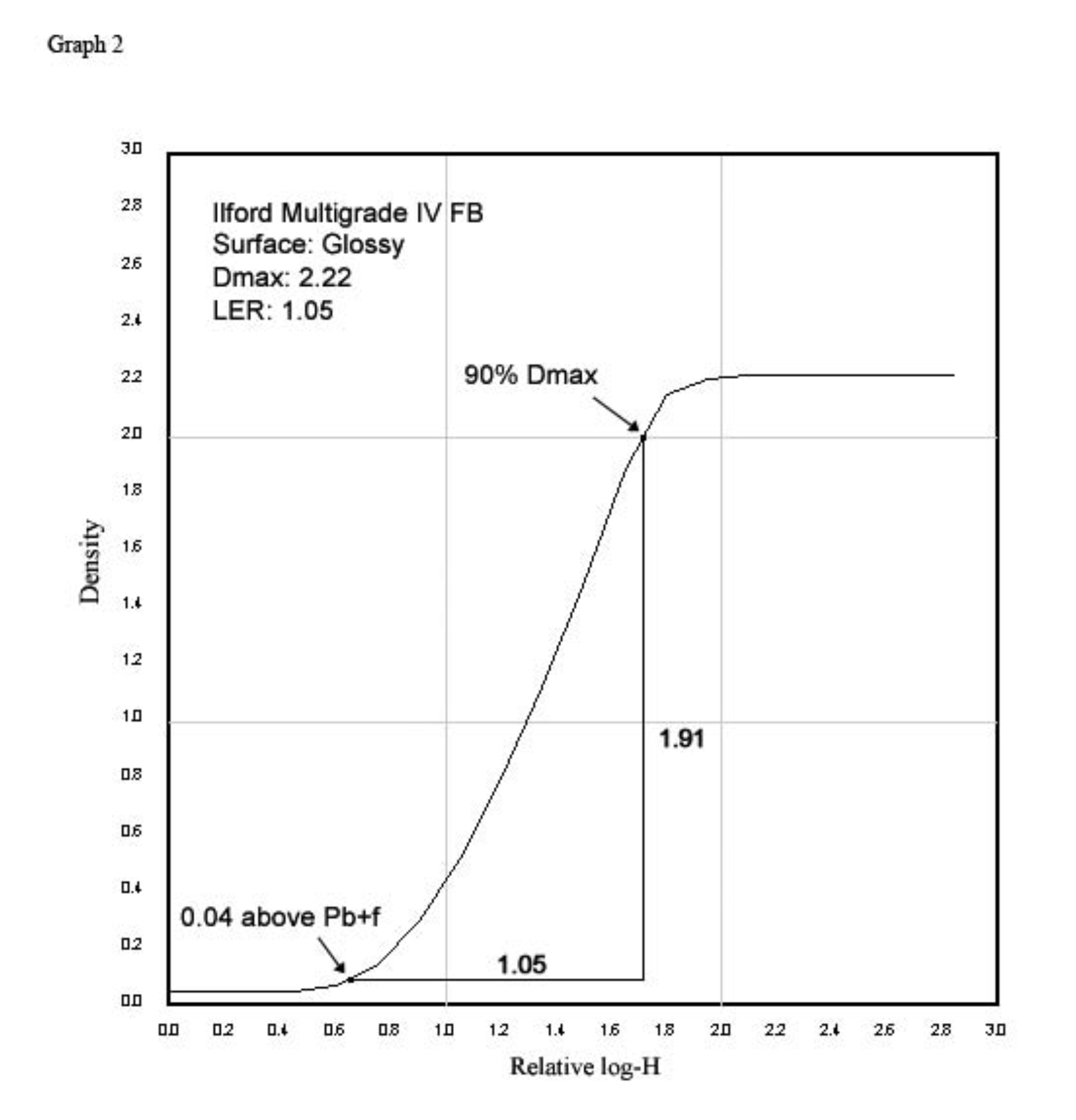

Frequently one can just eyeball the 0.04 step on your step-wedge contact test prints. It is just off white.

Yes, that is how I tend to do it. Changing the offset in reflection mode requires fiddling with adjust screws. The ease of use and the location of those screws tell me that you're not supposed to zero reflective readings for every paper you test.
