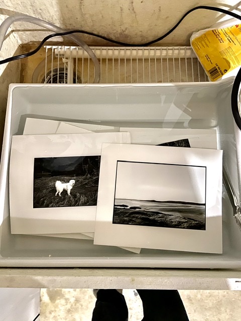

I think I got it going! I did have to re do the offsets for metering on the “focus” light. But the numbers all seem to make sense and the prints look right. Now it’ll be just about figuring out the workflow. It’s not so easy to always pick the right shadow target. I am enjoying the zone placement aspect though.
