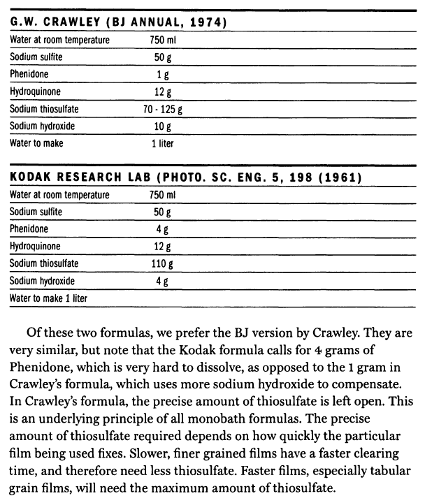

Both Anchell and Anchell/Troop have a few pages each on Monobath processing, including a few formulas.
