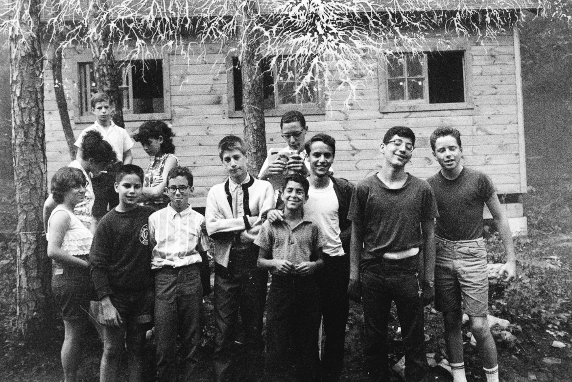

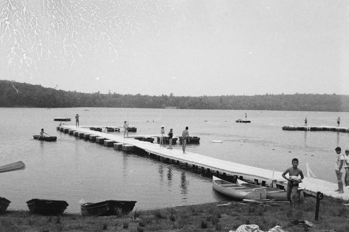

Howie P -- thanks for contributing that detail and the names of the players. But what about the second shot I posted? Looks to me like somebody got into a pickle between third & home. Any info about that?
Yes I figured it out by checking the play-by-play log: In the top of the 5th with the Dodgers leading 2-1, Maury Wills doubled, Jim Gilliam moved him to 3rd on a sacrifice fly and Willie Davis hit a grounder to the second baseman upon which Wills tried to score but was thrown out: the 2nd baseman threw to the catcher who threw to the 3rd baseman who tagged Wills out. Bobby Klaus to Jessie Gonder to Charley Smith. All immortals!

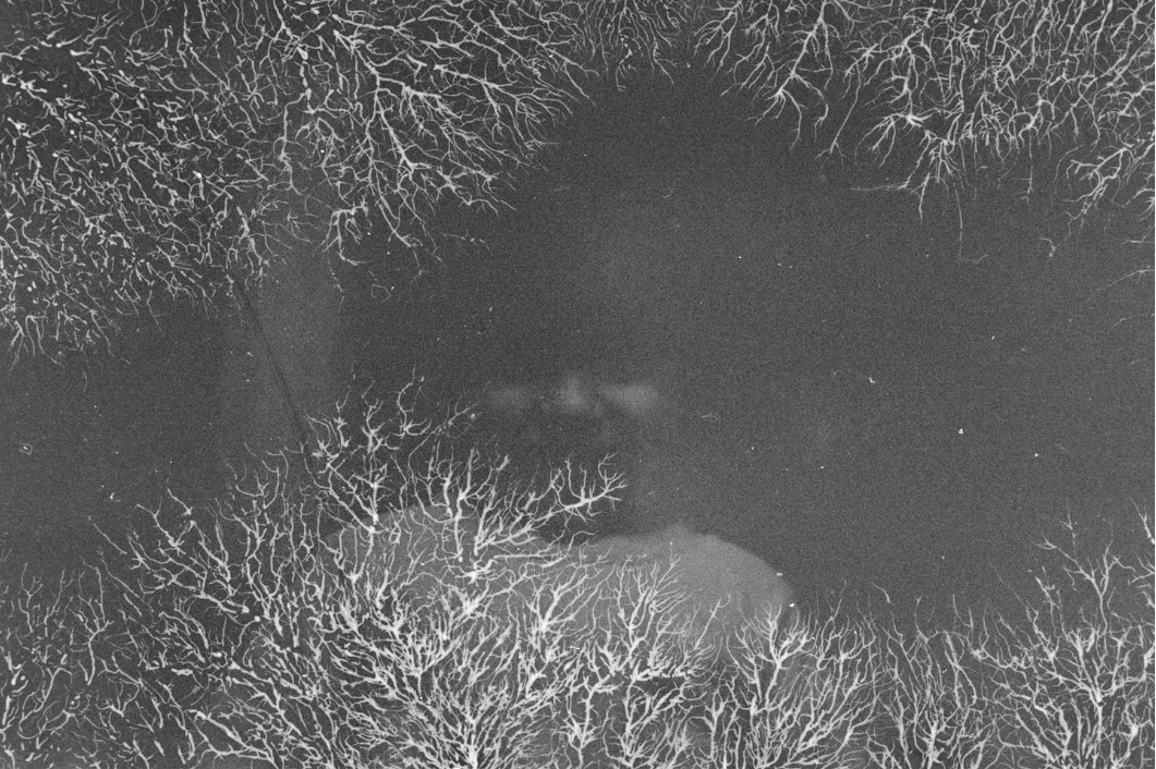

I developed four rolls this past weekend and scanned them with my Sony A7II. And, sadly, they all have mold. There are bulk loaded rolls and normal Kodak rolls. I was hoping that the bulk loaded ones were worse, but it's not the case. Also, the mold is completely invisible on the film before development. I pulled out that tongue on one roll and couldn't see a thing. But after development, the first frame on that roll had plenty of mold.
For what it's worth, the mold seems worse at the tongue end of each roll. The deeper in you get, the less mold. But out of four rolls only a handful of frames are clean. And needless to say, the images are very flat. I overdeveloped them quite a bit (in Ilfotec DD-X) and there's significant fog, as well.
I'm attaching a few examples, ranging from horrifying to not bad. These are not my finest work as a photographer! Just here to give you a sense of the range of the problem.

Here are a couple of additional samples. This is the first frame on the roll where I couldn't see any visible mold. The blow-ups are 100%. I'm struck by the lumpy-ness of the strands.

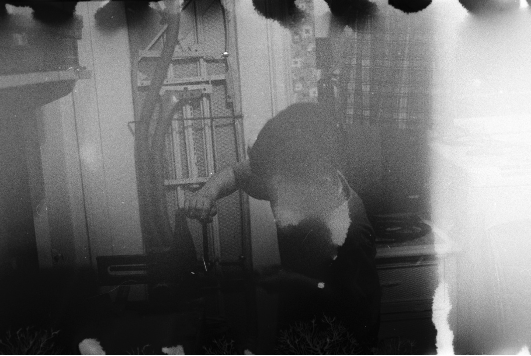

Hey folks, for those of you who are still interested, I developed 5 more rolls this weekend and scanned them all.
Based on your suggestions, I unspooled the rolls under water, and loaded the reels wet, hoping to eliminate the possibility of static. Not exactly an easy task. There were a few kinks but I was able to load the reels and get everything developed. Sadly, however, this did not eliminate the problem.
I did five rolls. Four Tri-X, one Plus-X. One roll was blank. Of the other four, two had mold and two didn't. No idea why. They were all shot at roughly the same time and stored in the same box.
I still have a few rolls left to do, and I'll get them done in the next month or two, and report back here.
In any event, thanks again to all of you for your help with this. A couple of examples below.
