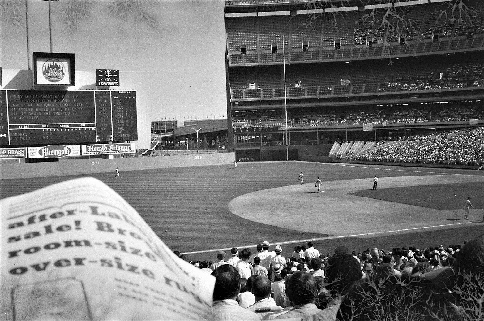

I've recently found a box of old, exposed, but undeveloped black and white film -- Tri-X. This stuff is likely about 50 years old! It was stored in the original canisters in an old wooden cigar box.
Hoping that there would still be an image, I brought two rolls to a local lab, and asked them to develop it. They ran it through their normal process, which uses something called F-76 (a knockoff of D-76) and we push processed it a bit (ie. over developed it).
And sure enough, there is still an image there. I chose to have the lab do a low-res quickie scan, rather than a conventional contact sheet. I've got a scanner rig based on a Sony A7II, which I'll use to do better scans.
But there's a big problem -- a spiderweb/tree-shaped pattern of lines creeping in from the edges of the film. One roll is much worse than the other, but they both have it. Sample attached -- from a blank frame at the head of the roll.
I'm guessing this is either mold or some kind of static charge that created a latent image.
Has anybody seen this before? Do you know what it is? And more to the point, I've got another dozen rolls or so that have yet to be developed. Is there anything I can do prior to developing to minimize it?
Many thanks!
Steve

Great. Thanks for the input. The lab where it was done believes it's mold and they are refusing to do any more rolls because they're concerned it will contaminate their bath. (I've got about a dozen more.) The image I posted here is by far the worst of all -- from the head of the roll. I haven't gotten the film back yet, to examine it directly -- they emailed me low res scans. So I'll be able to report back in a couple of days after I've had a closer look. There's a picture from a ball game which shows the scoreboard, and with a little sleuthing I figured out the date it was shot -- Sept 6, 1964. Yikes.
MattKing
Apr 24, 2005
53,097
Delta, BC Canada
Welcome to Photrio.
I would have guessed fungus, not mould, but it certainly appears to be contaminated. As gelatin is a major component of a film emulsion, it isn't incredibly surprizing.
If you were local, I would be happy to develop it for you, because as long as you don't employ replenished chemicals, it is easy to make sure that any contaminants like this end up going down the drain.
Even in a multi-use commercial lab, I doubt that there would be any damage to their process if they spaced the rolls out, but I respect their desire to keep as much mould/fungus away from their processing line as they can.
Look for someone who uses small tanks and reels and "one-shot" chemicals.

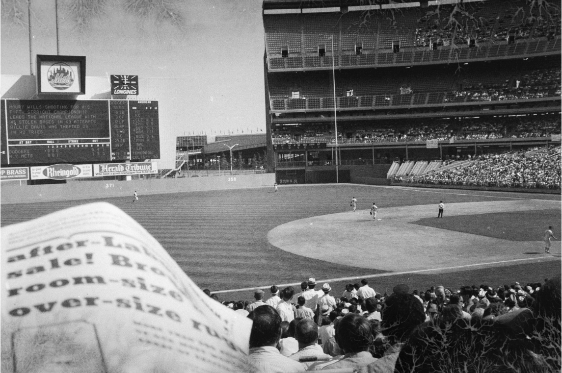

Thanks, Matt. That makes good sense. Do you know if there's any way to clean or sterilize the film before development? Or is the emulsion already damaged? And also, what I'm seeing is very low contrast even with 15-20% overdevelopment. Should the next batch be developed even longer? Any suggestions?
Here's an example. This frame has a lot less fungus, but it's still pretty objectionable. (From the scoreboard I have determined that this was shot on Sept 6, 1964. Yikes.)

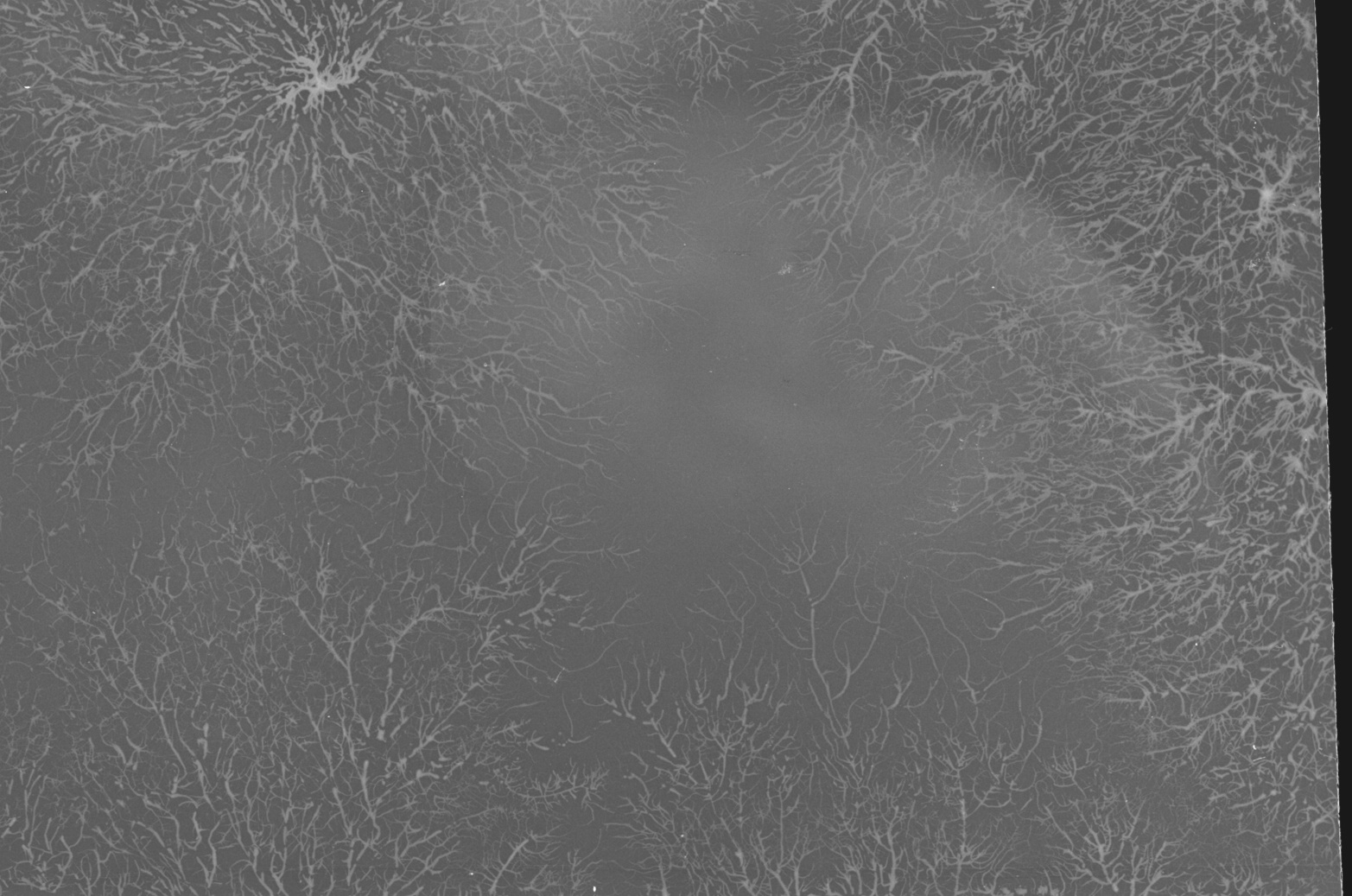

I picked up the negatives this morning and took a careful look at them with a loupe. The spidery patterns are in the emulsion -- as if they part of the exposure. Perhaps they were mold "on" the negatives before development but at this point the pattern is clearly "in" the negative. The patterns have no color, and they are not raised at all. Whatever was there before development, it has become part of the image, and if there was actual mold, it has been washed away. So, AgX, does that mean your idea of static is a possibility? The pattern is pretty much throughout the roll, and it is more present at the edges and seems to come in to the image area from there.
Regarding Matt's thought about fog, I think that's spot on. The clear film edges aren't really clear. So the blacks in the entire image are lifted. But still, there's an image present. I suspect that some of the images were underexposed in shooting, which, of course,would make the fog more of an issue.
Another problem -- after 57 years in the canister, they are very curled!
And finally, from the canister label, I see that the film was bulk loaded, by some company that took big rolls of Tri-X and put it in canisters. I don't know if that would influence things, but how the bulk film was handled -- whether there was moisture present, for example, might be relevant.
Next step for me, will be to scan some of the frames properly -- but that curling will make the scanning tricky.
Any thoughts?

The possibility exists that what you see is the result of what was left after the mould/fungi ate what they wanted to eat, secreted what they wanted to secrete, and then died.
Sort of like the trail left by a slug or snail, after the slug or snail is gone.

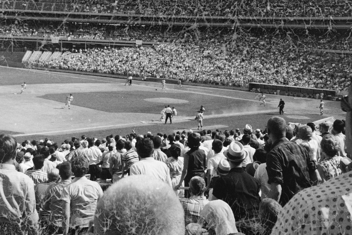

Hey folks -- if any of you are still checking in here, I finally scanned those old images properly -- using a Sony A7II with a Micro Nikkor attachment. Here's the result. Not bad for 1964 -- and left in the canister till now.

A person who would be likely to know passed on some information to me about what has been attributed here to mould (mold).
Apparently, based on the appearance of the images posted, that is not mould, but rather branch static that is forming because the film has dried out and lost much of its static protection over the many years. The film would have been wound for so long that it's all core-set, curled up, and most likely somewhat blocked. When the roll is unwound, the film discharges at the point of separation which usually begins at the edges and runs inward.
There really isn't a way to get out of this short of putting a humidifier in the camera. If one were to try to humidify the roll and then try to use it, the moisture being added might actually increase the blocking of the moistened emulsion to the base.
