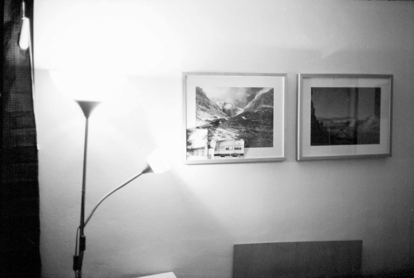

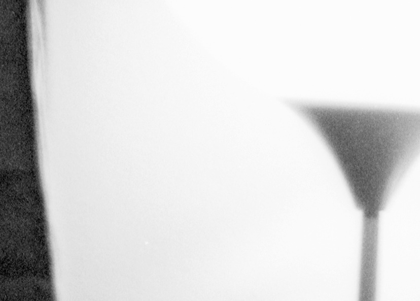

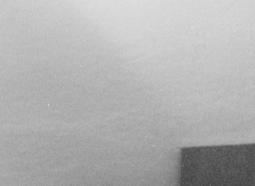

So, at least I found the time to scan the neg actually. The scanner was very busy handling the denser parts of the negatvie, as you can see, the highlights tend to blow. think print will handle the highlights a lot better.
As for grain I add two crops, scanned grain is often exaggerated an I scanned at 3600 dpi. No grain, sorry...
Sharpness I can't tell, this was a 1 second indoor shot :smile:
