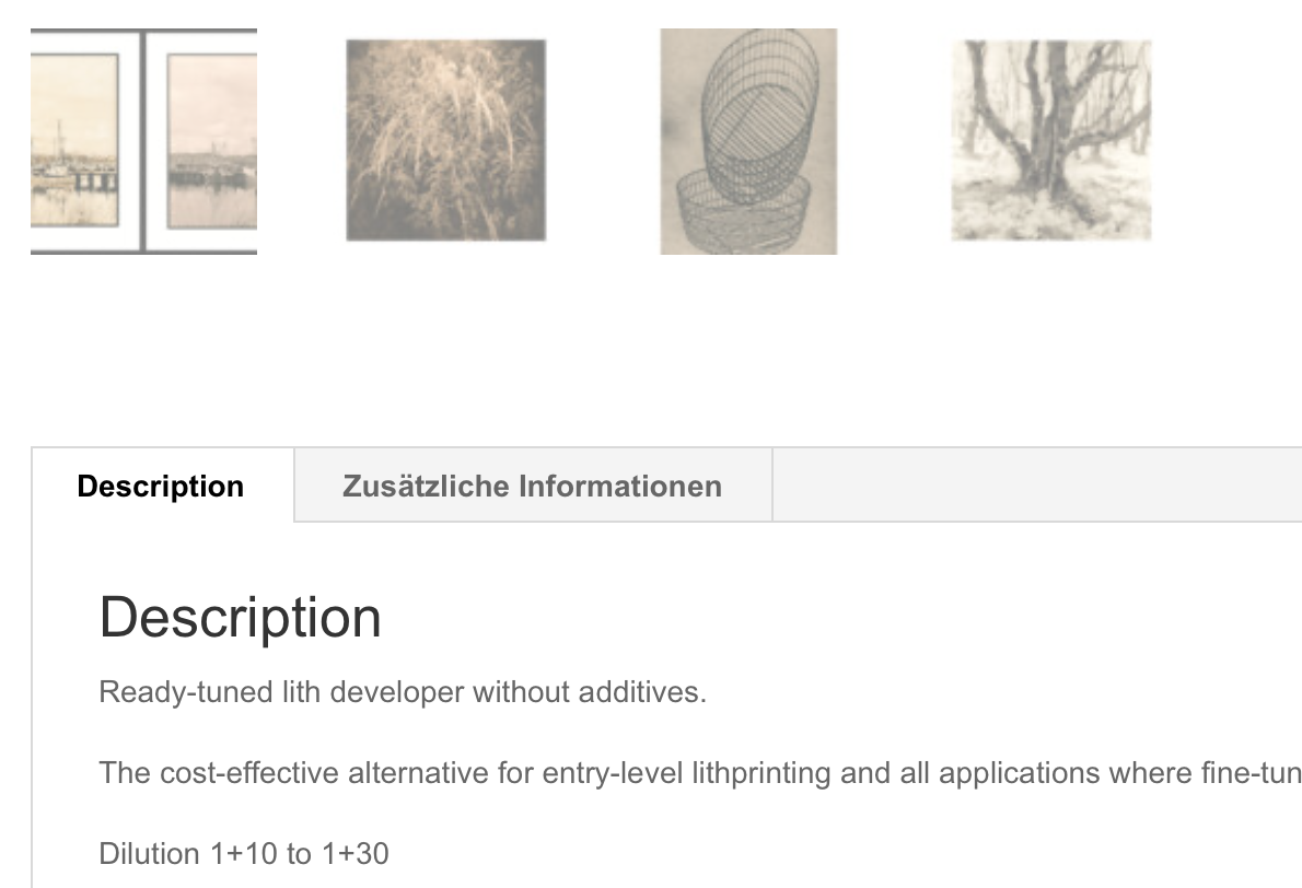

hi,
On the website of Moersch for the EasyLith developer i read this:
Dilution 1+10 to 1+30
Does this mean A or B?
A) 1A + 1B + 30 water
3,3 cl + 3,3 cl 1 Liter water
B) 1 + 30 water
3,3 cl + 1 liter water
(1,65cl A + 1,65cl B) + 1 liter water
Thx

If you read the documentation released by Moersch on this product, you'll find that when he mentions a dilution of 1+... for a two-part concentrate, this means 0.5+0.5+... (so your option 'B').
