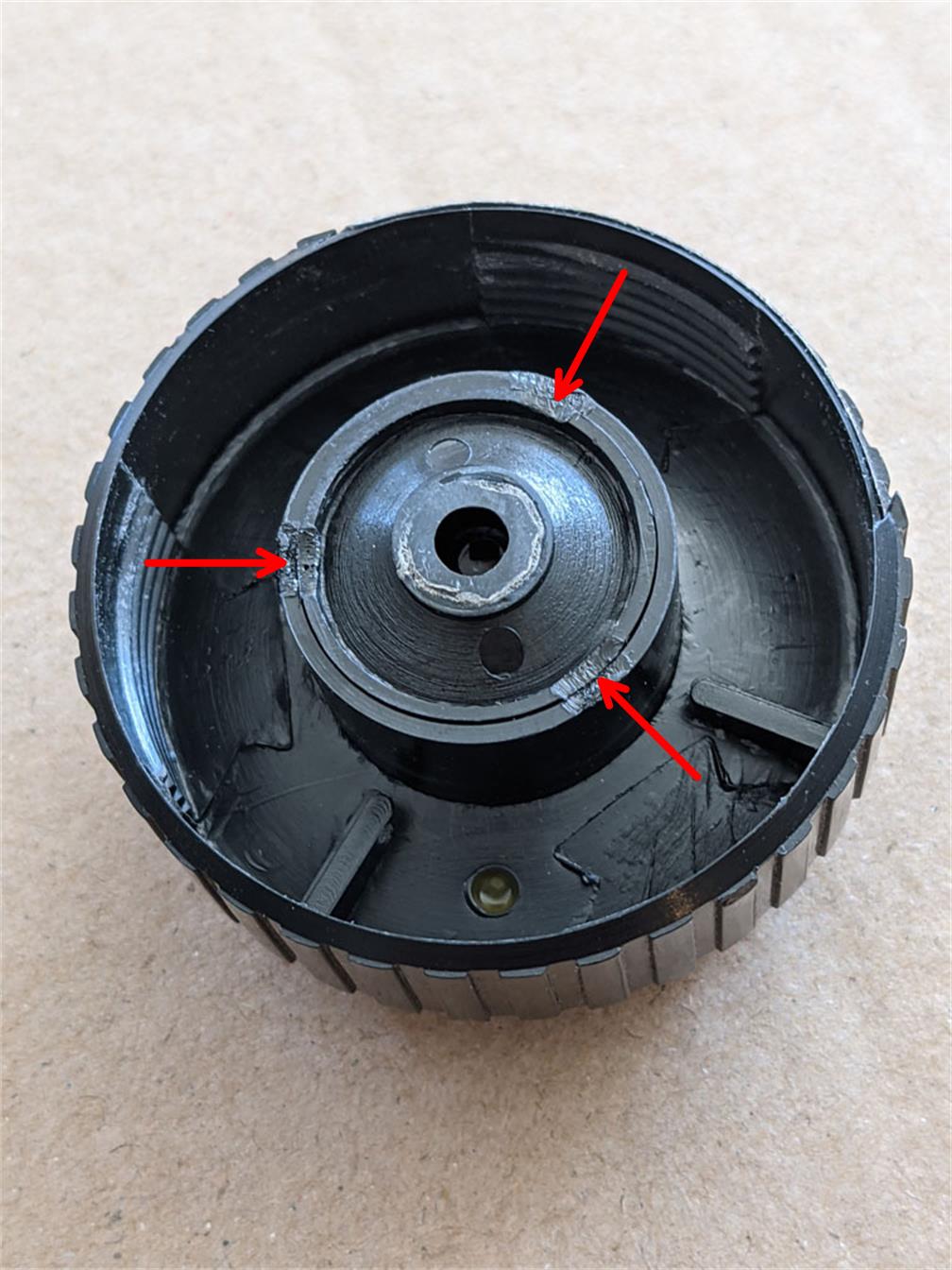

Jeff that's a great answer thank you very much.
Do you have a picture of the welds that you can share with me?
I'm not sure I'm seeing what you mean.
Much appreciated.

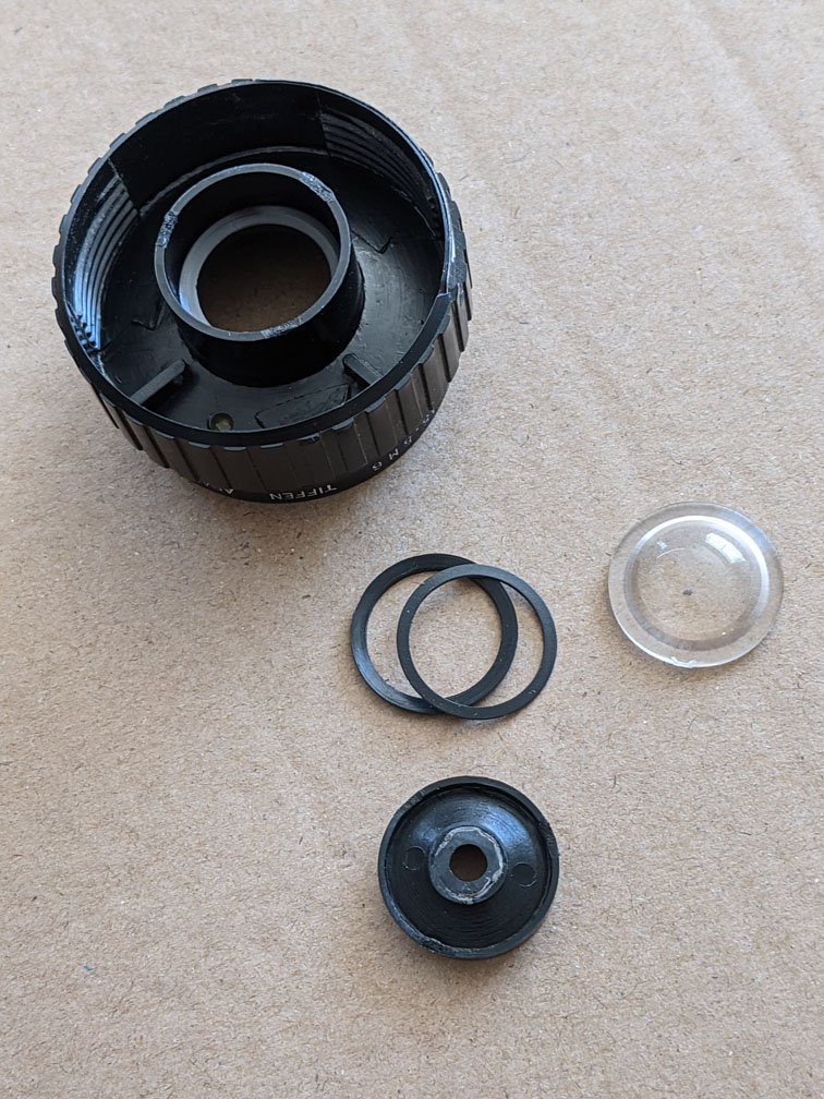

One of the pictures in the link I gave above shows them, but in case it's unclear exactly the welds I'm talking about, here is a picture of my own lens assembly with the red arrows pointing to the welds in question. Also, I added another picture to show what it looks like completely disassembled.
