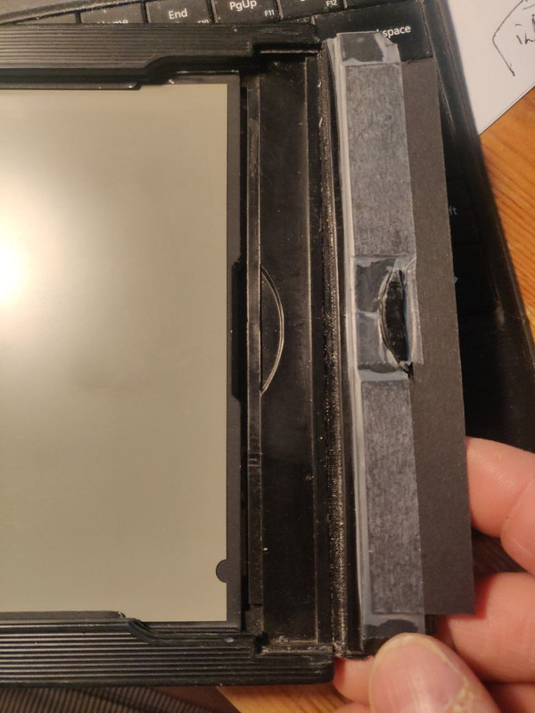

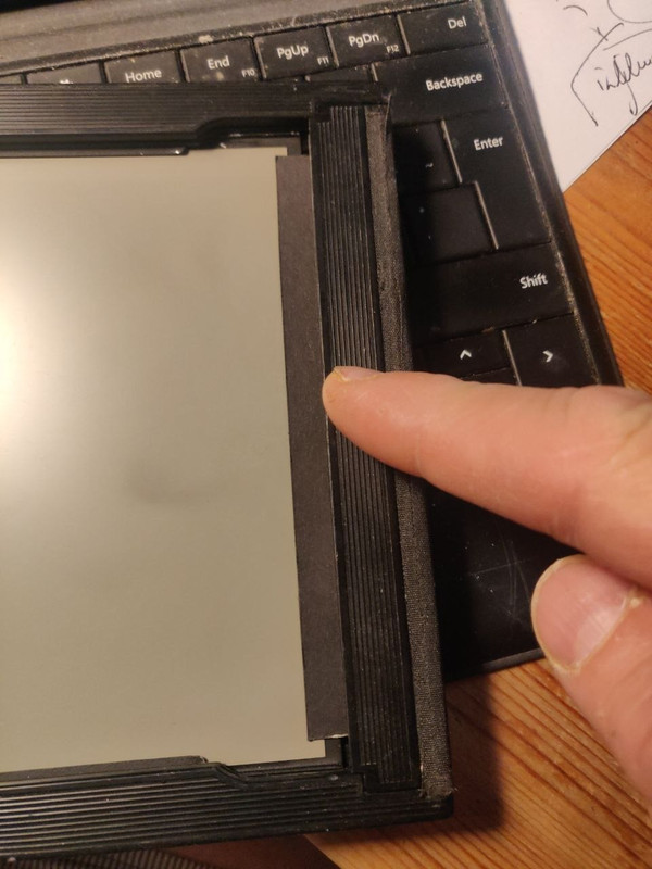

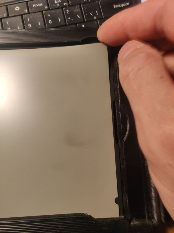

I had 13x18 holders before I had 5x7, because 13x18 were more available on 2nd hand market, as the former default format in Europe. 5x7 sheet is not secured, as is, in a 13x18. Once in a while it can become loose from one the long retaining rail, and if not getting on the way after dark slide is pulled, it can anyway hang out of focus plane from the loose edge.
the dumb easy fix I had was to lock the short edge with a length of thick black paper, in the 180g/m2, applied under the lock of the holder, with tape. It is clearer in picture.
A 13x18 Sinar holder and a 5x7 sheet of Fomapan:
when the sheet is fully inserted inside one of the rail, the other edge is loose:
a cut of 180g/m2 black Canson, as per the shape of the underside of the lock, hold with thing clear tape:
just be sure when loading the sheet that it goes all the way inside, then lock. Randomly each long edge is more or less partially inside the rails.
The added paper is not thick enough to avoid locking, but thick enough to pinch the edge of the sheet. It does not move, stays put.
Yes, that's the problem, the 5x7 film just slips out...
Thank you very much for the pictures, I'll try to fix the film in a similar way in the lower part.
