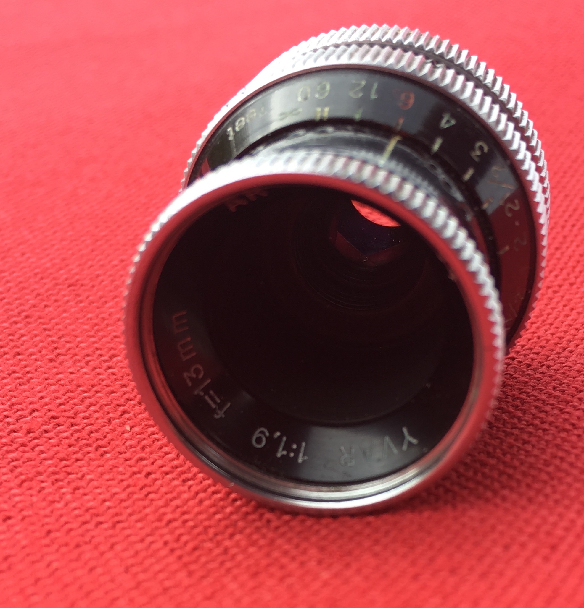

There are always 8mm movie camera lenses.
@Bill Burk Thats an interesting idea....where would one even look to find a facility that would do that ?

The other question I have is, I've read that flipping a lens board in an enlarger provides optical reduction, is this true?
Im rereading this thread,
See https://www.photrio.com/forum/threads/using-8mm-movie-camera-lens-in-enlarger.185187/ for some discussion around this.
To create them in the first place on film, I'd use something like a Nikon R10 (or any macro capable sub-mini format) then contact print the super8 negative to whatever. You could make enlarged internegatives for contact printing or directly via an enlarger (UV in the case of cyanotype https://www.photrio.com/forum/threads/making-an-uv-enlarger.92824/).
