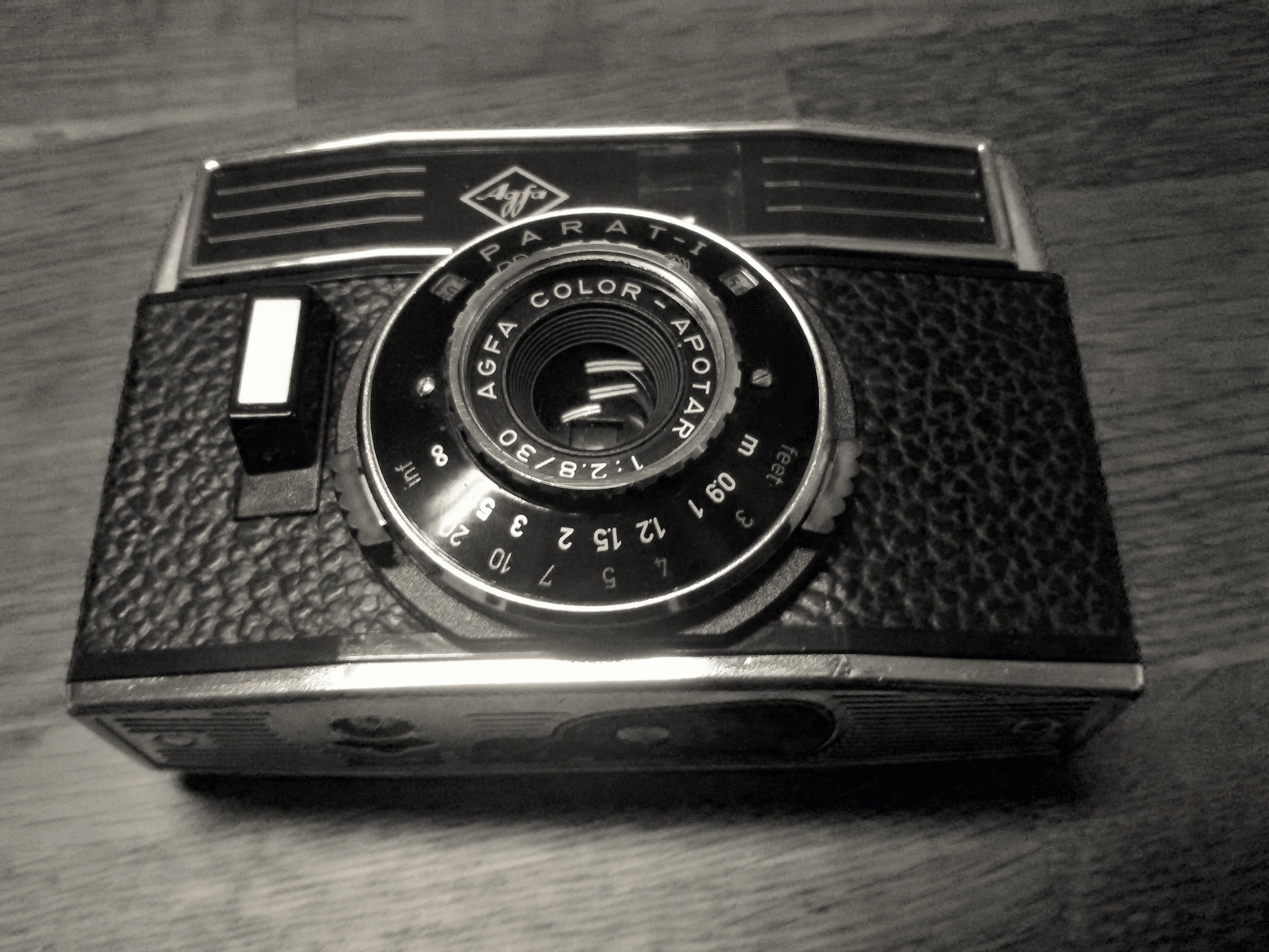

Its the smoothest of all the cameras I own. I have no idea how smooth the Leicas are but this camera is a joy to operate.
* I really adore those half-frame beauties from Agfa.
