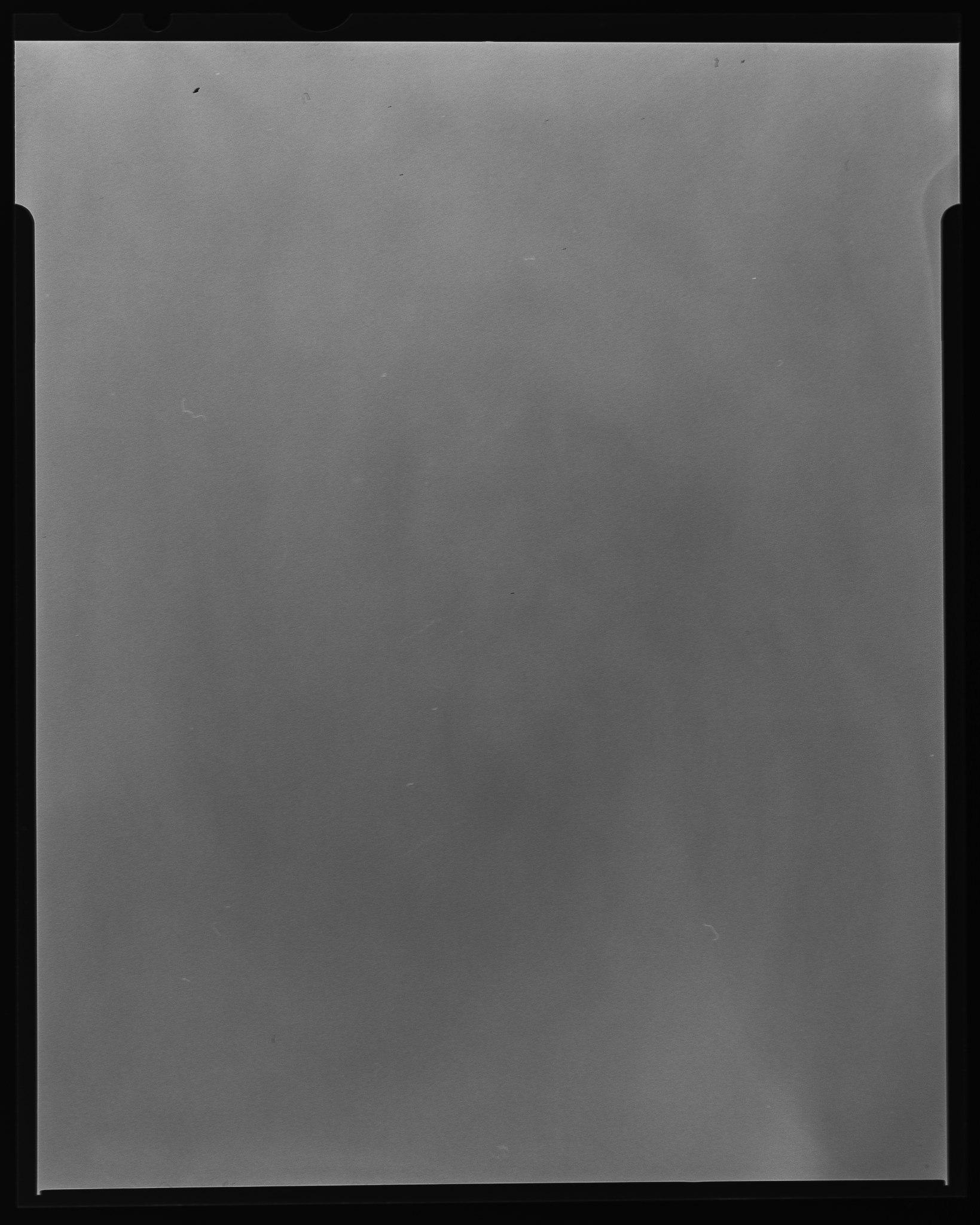

MOD54
The most obvious issues here are the over-development around the areas where the negative touches the arms of the holder; and the larger irregularity on the right side where liquid flow must be difficult (I do not believe the sheets were touching or loaded wrongly: they felt good before development, and looked correct after, during washing). Perhaps a different agitation technique could help the latter, but I don't know how to avoid the arm-marks.

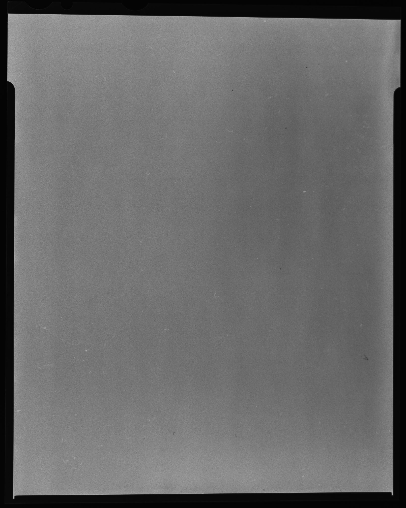

B's 4x5 developing reel Mk2
This reel shows some interesting swirl patterns, particularly on the bottom right, where I imagine the liquid flow is tightest due to the shape of the reel. Overall it's more even, and without the obvious issue of the MOD54's contact points. The test image developed this way looks decent.

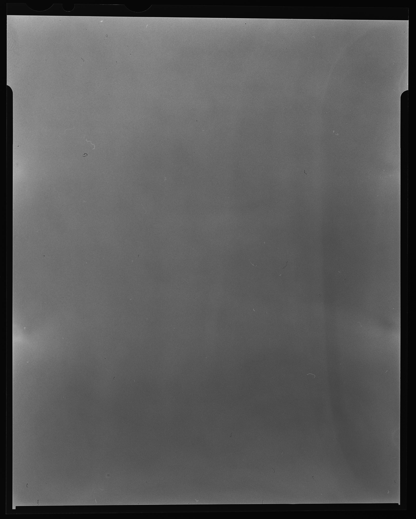

Stearman Press SP-455
This seems to be the best of the group, although it's still blotchier than I would prefer. I would appreciate any tips from SP-445 users on agitation or developers. But if I can refine this process, I love the size and convenience of the tank. And am excited for the forthcoming SP-645 6-sheet variant.
(There's a nasty scratch on this sheet, caused by an ugly bit of plastic flashing on one of the SP-445 film holders which I hadn't noticed. I'll double check them in future before use, but that's a minor detail.)

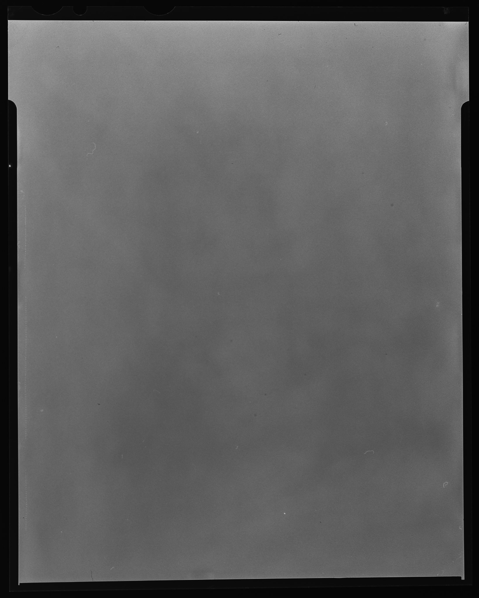

Tray
This was in ILFOSOL 3 at 1+9, 20ºC for 6.5 minutes (as previous tanks were). Agitation was by cycling the 4x sheets from bottom to top for the first 45 seconds or so, then one "shuffle" every 30-45 seconds, counting five sheets each shuffle (there were only four in the tray) to ensure they all got equal time on top of the stack. This does look about as even as I recall, and shows no obvious issues aside from slight overdevelopment on the edges.

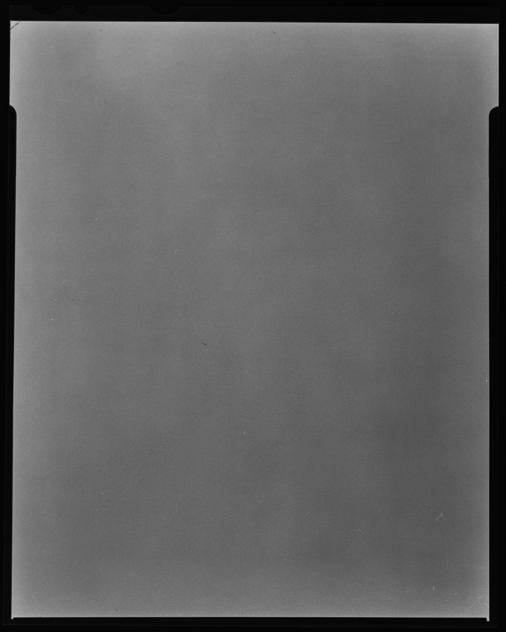

SP-445 with DD-X
DD-X 1+4 for 9 minutes. Agitation about 10-12 inversions for the first 30 seconds, followed by 4 alternating side inversions every 30 seconds. This felt like the best tank result, and closely matches my tray result. I think the longer standard development time of DD-X is probably a contributing factor, so I may ditch the ILFOSOL for 4x5. It's a little streaky in the direction of my inversions, so I'll add some left-to-right inversions as well as the front-to-back, and I think could get this to match the tray result, which is good enough for me.
