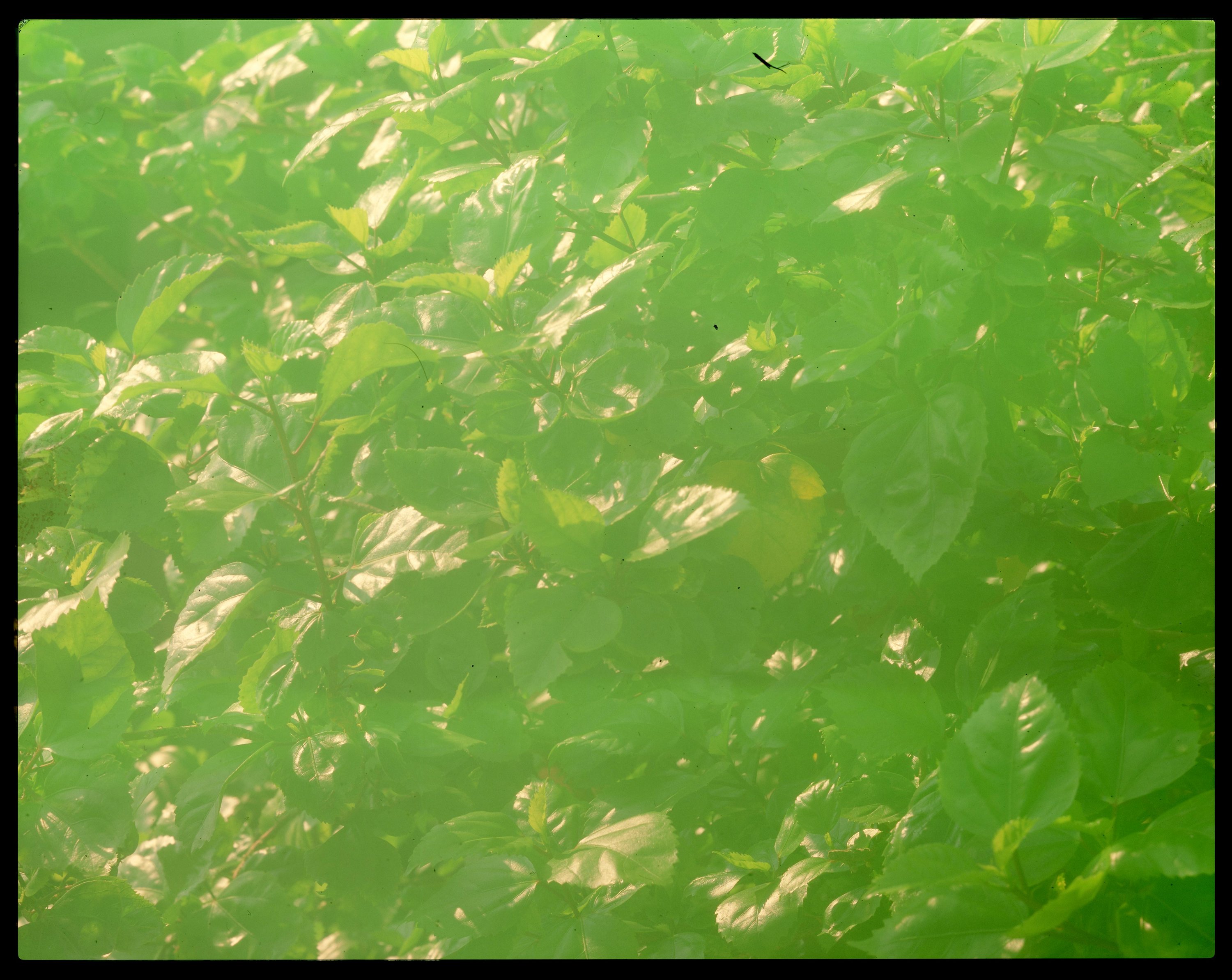

Friends,
I got this as a result off Developing fuji velvia in 6 bath chemistry mixed from constituent salts, there was no cross-contamination and the solutions had been mixed only the previous night and stored in air evacuation concertina bottles poured using separate jugs with first developer separately opened and closed. I will appreciate any comments as to the possible processing error, online articles mention exhausted color developer and reversal bath which seems not to be the case here,
thanks and regards Ashish

There are no edge markings visible. This marking is of help in diagnosing your problem.
If it can be diagnosed.
PE

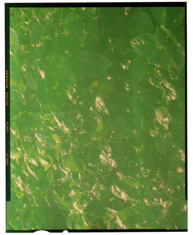

@Ashish Wakhlu : the reason Photo Engineer asked for edge markings is this: what you showed in posting #16 could come from incorrect development or from incorrect exposure. The only way to find out is through the edge markings: these were exposed by the film maker. If the edge markings look as expected, then your developer was good and exposure was bad. If the edge markings are messed up, then most likely incorrect development was the culprit.
Could you please also share, which E6 six bath formula you used? Or did you use a prepackaged E6 developer kit ?

Friends,
thank you very much for all your valuable inputs, sorry for the 8 hour hiatus (time zones) this is the complete slide, the edge markings seem to be OK, the film is fresh (exp 2020) I am making pictures of my formulae and will post them ASAP again will appreciate comments and criticism both ? regards Ashish
