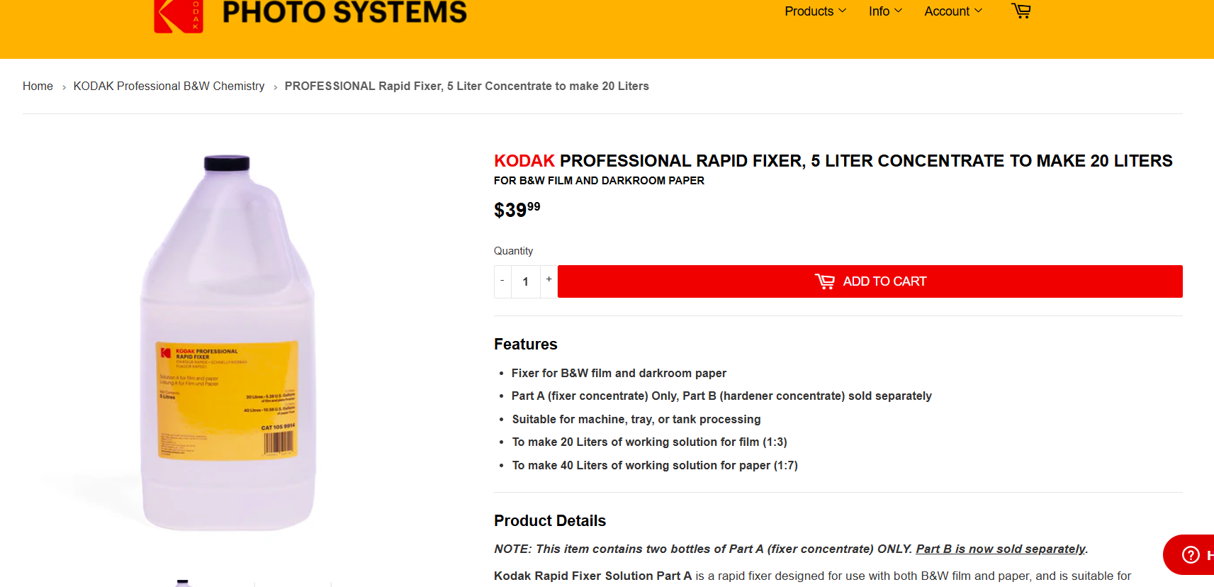

Bob,
If you can find a Canadian source, this might be another option for you:
https://kodak.photosys.com/collecti...ixer-solution-part-a-to-make-20l-cat-105-9914

The mat works out in favor of mixing it yourself, but let's take the $40 bottle that makes 20L working:
3.7L Ammonium Thiosulfate
2000g Sodium Sulfite
168g Sodium metabisulfite
Artcraft only sells the thiosulfate solution in 1L bottles, so you'd need 4 of them at $9.18 each. That's $36.72 just for this ingredient.
You're also up to needing 5lbs(2,270g) of sodium sulfite, which will cost you $18.11 with enough left over to mix ~2L of D76.
The sodium metabisulfite will still get done with a 1lb bottle, and that's not something I've seen in a ton of formulae in huge amounts, so I wouldn't stress over it. Still, it's something you need to buy and have on hand.
So my analysis just based on this is that it's a wash if you're buying concentrate to make 1 gallon, and the price shifts hugely in favor of commercial if buying larger quantities.
I'll also note that I can't seem to find the smaller bottle of Kodak concentrate without the included hardener, although I know I bought it last year.
For the closest Ilford equivalent, 1L bottle(5L working solution) is $17.87. A 5L bottle is $53.96, which is probably about a financial wash to vs. making it yourself, but diluting a concentrate is certainly easier. I'm a chemist who doesn't mind getting my hands dirty in the lab, but this is somewhere that I'm probably going to be analyzing the next time I'm looking to buy fixer.

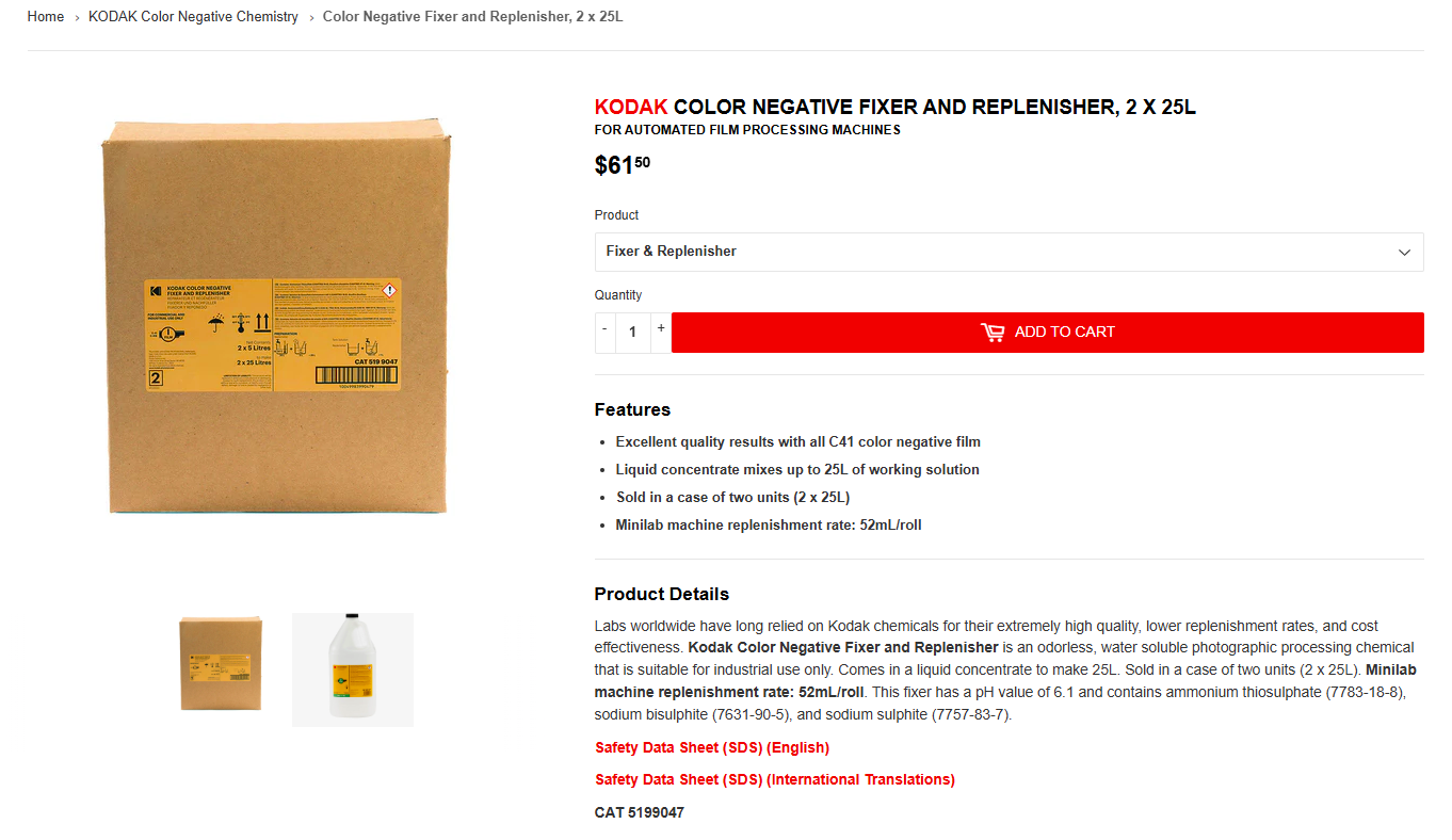

If we're ever able to get Flexicolor III fixer again in moderate-size quantities for home use without buying a full kit, I suspect that will blow any of this math away and make it a no-brainer for those who have in the past used everything.
Given the sort of volumes Bob might need, this might be a solution for 50 litres of working strength:
https://kodak.photosys.com/collecti...odak-color-negative-fixer-and-replenisher-25l
Again, subject to getting it in Canada.
