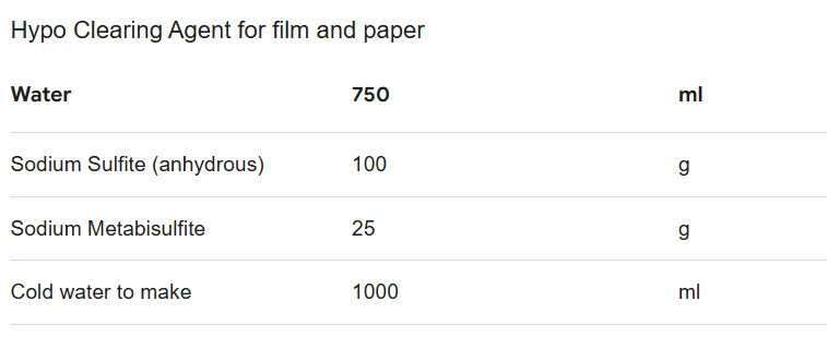

Hypo clear/wash aid (1 l)​
Ingredient Amount
Water 750 ml
Sodium sulfite, anhydrous 100 g
Sodium metabisulfite (Na2S2O5) 25 g
Cold water to make 1000 ml
Dilute stock 1+4 to get working solution

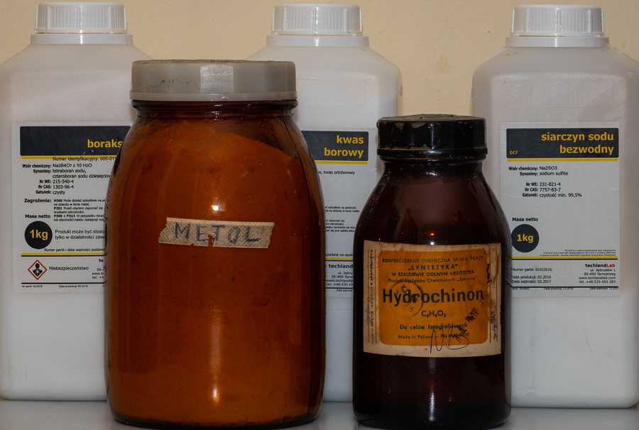

Here's a list of chemicals to buy to get started, which will allow you to mix the most common stuff, along with some suggested amounts. Supplement with the ingredients for the specific formula you're interested in.
  • Metol, 20 - 50g
  • Hydroquinone, 20 - 50g
  • Ascorbic acid, 50 - 100g
  • Sodium sulfite, 500 g - 1 kg
  • Sodium metabisulfite, 100 - 250 g
  • Borax, 10 - 50 g
  • Sodium carbonate, 50 - 200g
  • Potassium bromide, 10 - 30g
  • Sodium thiosulfate, 500 g - 1 kg
  • Acetic acid

For Hypo clearing agent use 1 teaspoon of baking soda per 1 litre of water.
Simple yes?
I don't think so.
Hypo Clearing Agent:
Note that the main ingredient is Sodium Sulfite.
Baking Soda is something entirely different: Sodium bicarbonate

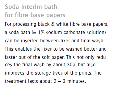

Matt, a correction: A 1% solution of Sodium Carbonate is recommended as an interim bath after fixing, and before washing for Fibre based papers in the Aga "The Black & White Manual" on page 70.
Sodium Bicarbonate will work as well as Sodium Carbonate, alternatives are Citrates and Sulphates, according to L.F.A. Mason, Photographic Processing Cemistry. .
I think it's more important when using Carbonate that the print goes from the fixer to the Interim bath. The "Fixing" process is a complex sequence with many equilibrium balances, and it's important to break weak bonding of residual Thiosulphate with the Gelati and paper fibres in the base.
