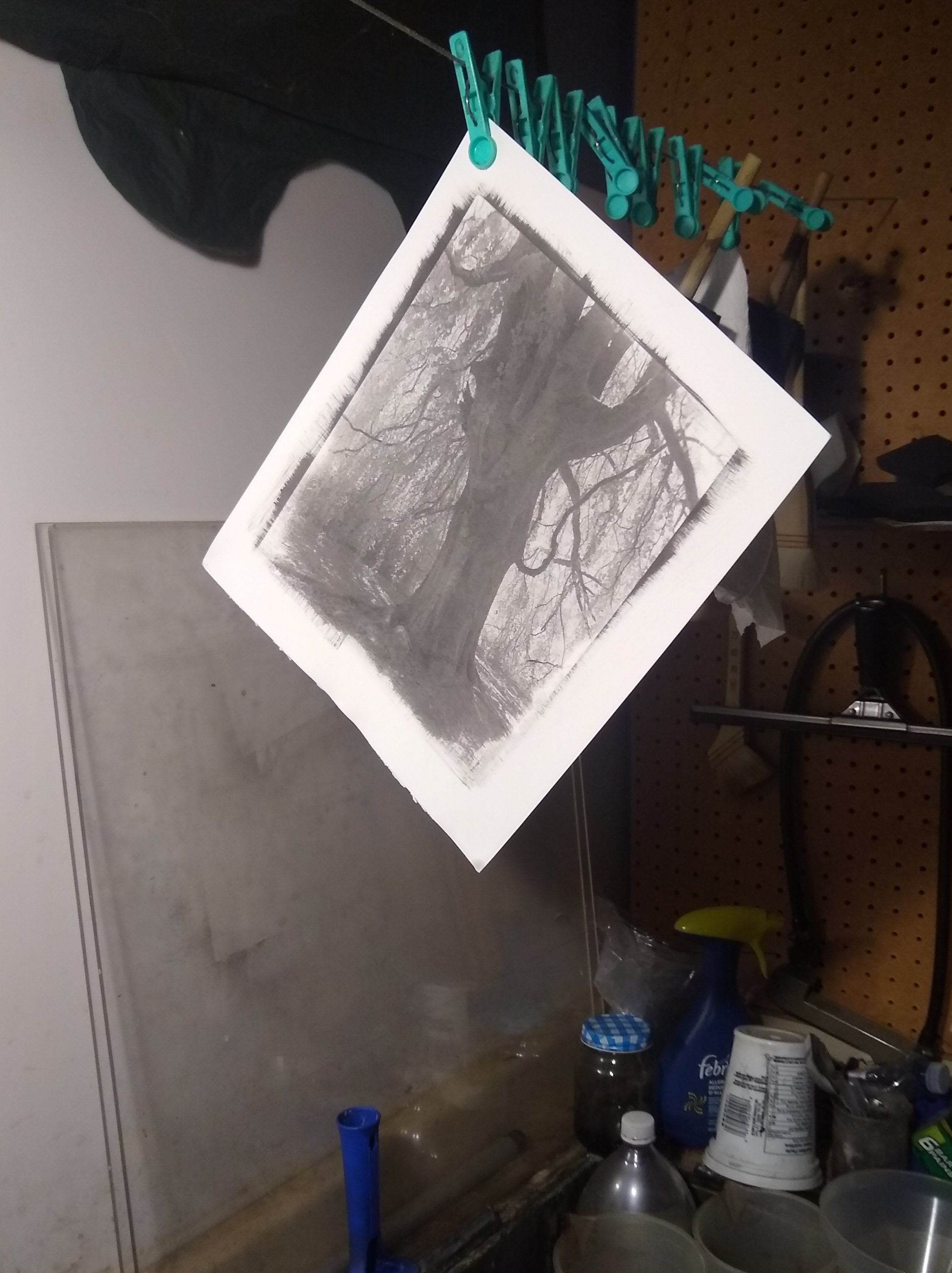

Mixed up a batch. 1+3. Used my wife's mixer :smile:D). All went into solution easily in a few minutes. Let the frothy batch sit covered in the counter until all froth gone. Added a measured amount of sodium benzoate, which eventually absorbed into the gum solution. It wouldn't stir in, so leaving it in the gum solution for an hour or so, absorbed it.
Made a test print this morning. Very satisfied.
Good to hear all went well. Proof is in the pudding, That is a good looking print.
