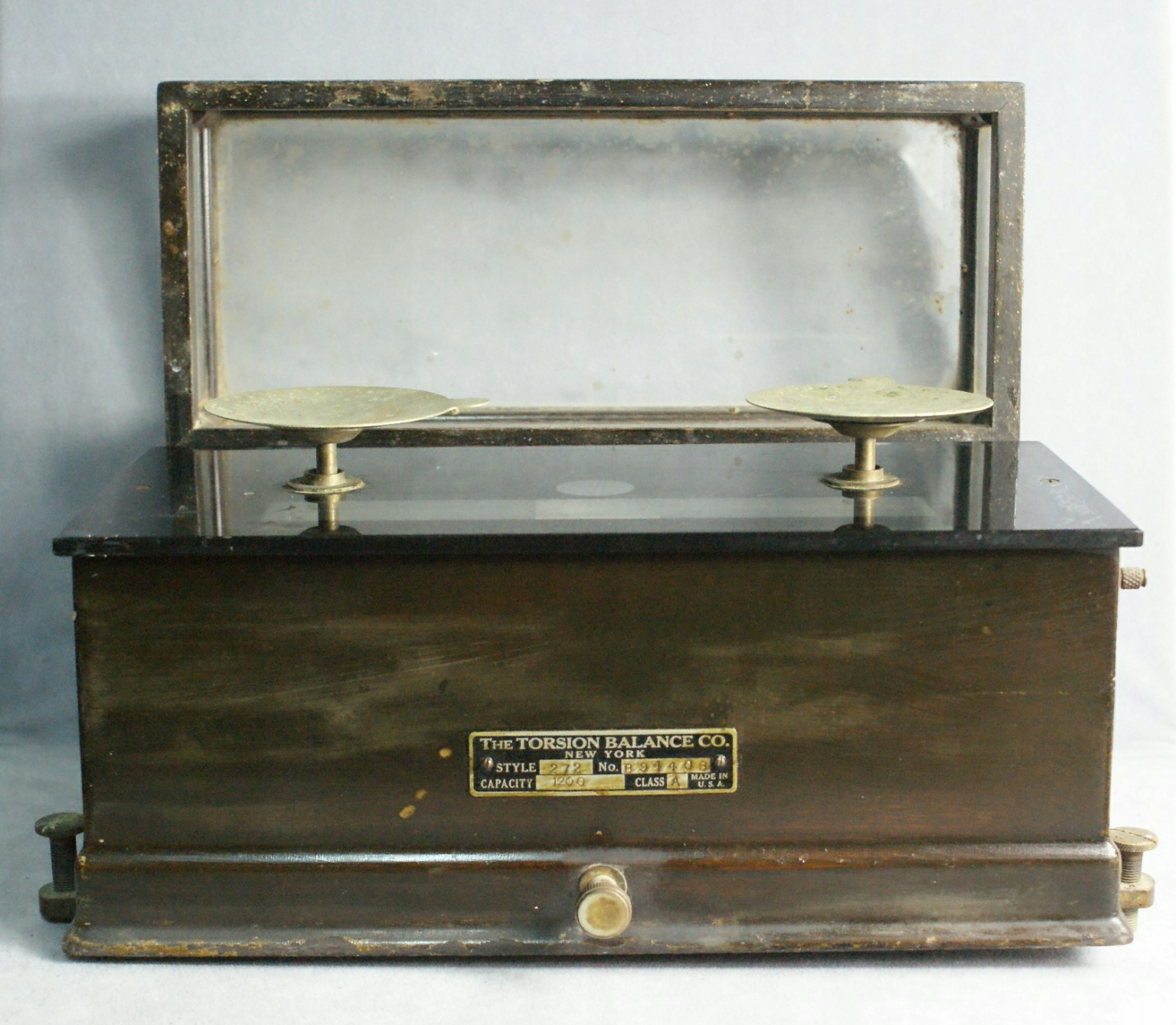

But, got myself this . Digital is convenient so I will likely have that too, this makes me smile.
