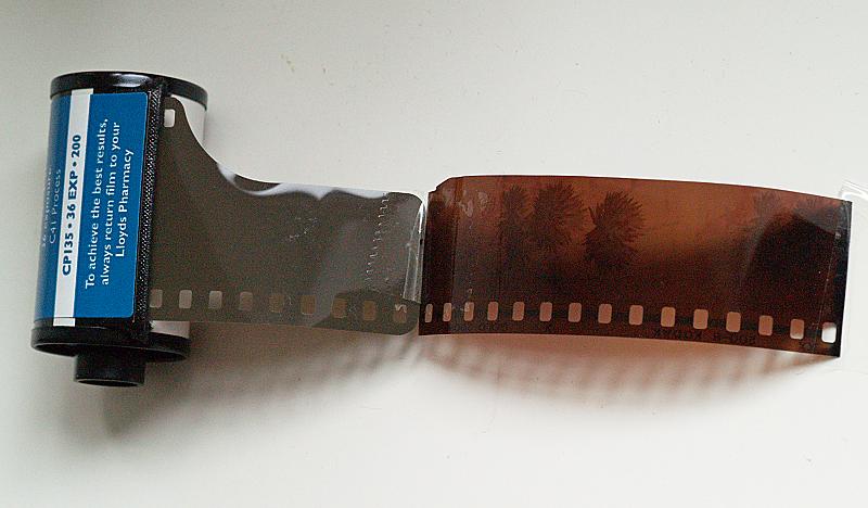

How I get around the waste of 'auto-load' cameras, and even for 'manual load' cameras -- I cut a strip of spare waste film to the width of the 'leader' and tape it front and back with narrow strip of 'sellotape' being careful not to get it over a perforation hole as it CAN mess up on auto-load cameras -- then I
have had 40 frames from a 36 exposure film.

How I get around the waste of 'auto-load' cameras, and even for 'manual load' cameras -- I cut a strip of spare waste film to the width of the 'leader' and tape it front and back with narrow strip of 'sellotape' being careful not to get it over a perforation hole as it CAN mess up on auto-load cameras -- then I View attachment 195438 have had 40 frames from a 36 exposure film.
The leader even has images on. You'd have to line up your leader sprocket holes with the film sprocket holes exactly to avoid snatching, or going into Err mode for automatic cameras?
