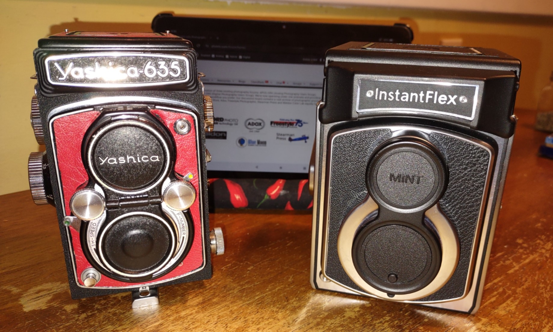

Not too much discussion about the Mint TL70 plus camera. I just received a used one with the ND and close up lens set for fairly cheap.
The seller did say that she was having a problem with it indicating the exposures left, I'm guessing this means I'll get to waste one here and there if it resets. Anyone experience this problem and know of a fix?
