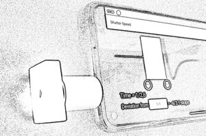

Perhaps you checked your Minox and it passed the shutter test. The times run plausibly, which means that longer times open the shutter longer than short times. So far so good.
So are the times correct? Of course not necessarily. “Dare to know” Kant tells us in this context.
So let’s measure the shutter speeds of our Minox. But how? Most methods send light through the lens and measure the opening of the shutter through the open back cover of the camera. Oh no, not with a Minox!
But yes, it works. I found out a simple method to accurately measure Minox shutter speeds:

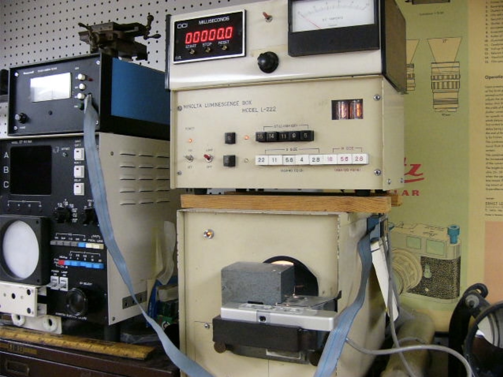

I was inspired by the one shown on the DAG website, but I never got arround to making a module for my tester.

That is very nice!
I was inspired by the one shown on the DAG website, but I never got arround to making a module for my tester. View attachment 370618
Impressive devices.

Today I tested my Photoplug setup to find out whether my previous shutter speed measurements were accurate enough.
I think my setup delivers good accuracy. If you want to know how I tested and what specific results I got, you can read it here:
