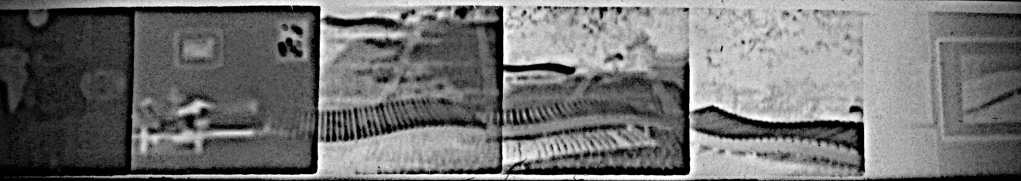

When this mechanism fails, the negatives on the film look like this:

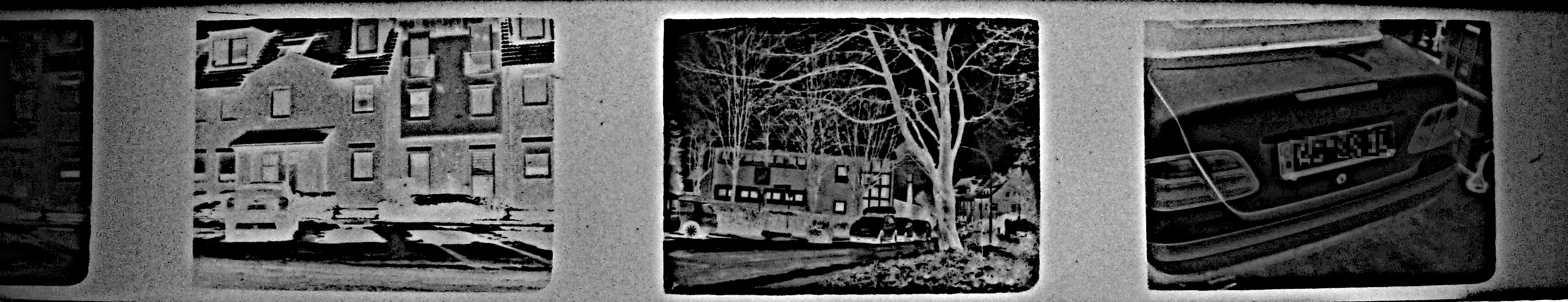

The photos overlap because the distances during film transport are not correct. Instead it should look like this:

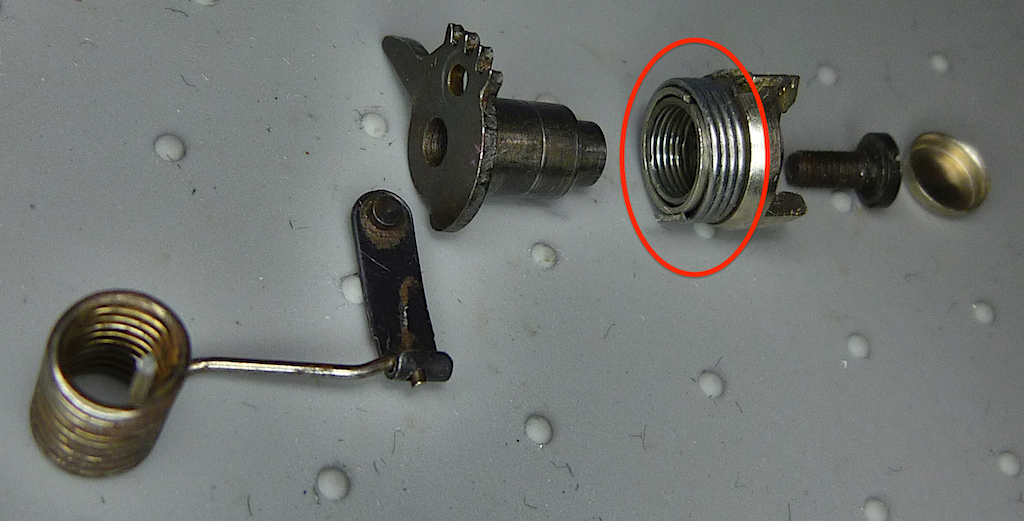

That's very interesting! But I'm not sure if I understand you correctly. Which part do you mean exactly? Is it one of these:

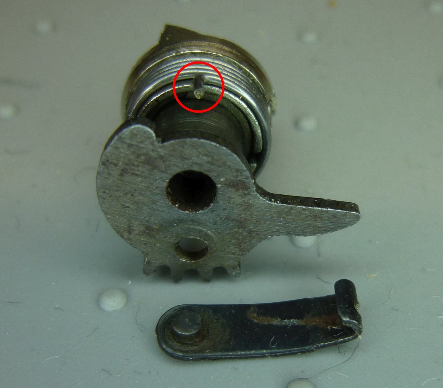

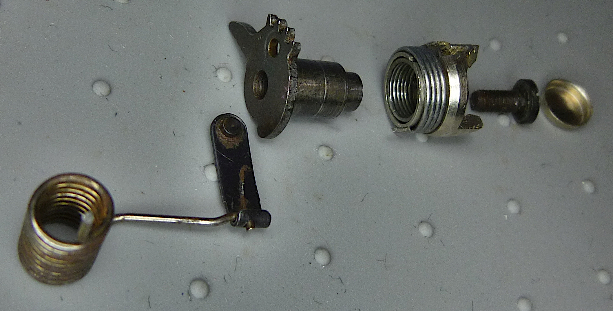

The claw may be slipping because the spring is not properly seated in the housing. The end of the spring (see picture) must engage in the drill-hole of the housing.

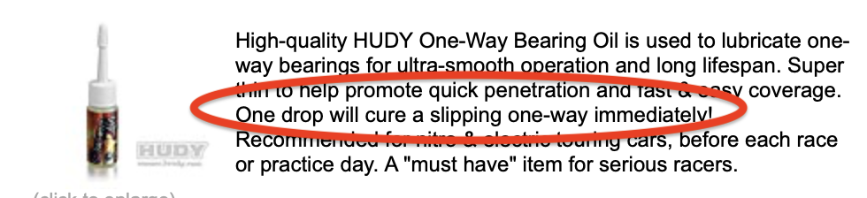

Yes this part circled. I just wound up just cleaning mine and it worked fine, but there is special oil for sprag-clutch one-way bearings, I wonder if that would work on a slipping wrap spring clutch.

I would not recommend any lubrication of the two springs at all. Reason in my article, see below.
Only the bearings should get lubrication. But I would not recommend the HUDY oil for the following two reasons:
1. The oil is intended for high-speed parts and is therefore "super thin". The film spool drive is an extremely slow-moving part. It is also easy to disassemble and the parts can be lubricated separately. So it is not necessary for the lubricant to flow into hard-to-reach corners by itself.
2. The ability of this oil to creep everywhere is actually a danger here. We are very close to the lens here and we want to avoid oil getting on the lenses at all costs.
I would therefore recommend a grease. I use GunCer gun grease (Ballistol) for slow-running sliding pairs with emergency running properties. Because of its very good adhesion, even at high temperatures, it is also suitable for use near lenses and shutters, as the risk of migration into these zones is low.
