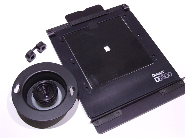

This is my Minox printing setup for a 4x5" enlarger. That is a 5x5" glass carrier with a mask. Though I recently re-purposed a medium format enlarger for Minox use: https://www.photrio.com/forum/threads/setting-up-an-enlarger-for-16mm-and-minox.180333/
Excellent! I do the same with my Saunders 4x5 these days. I use the 35mm condensing mixing box. Works pretty good but a little slow. I'd like to make a mixing box just for Minox. I have a mask I put on top of the glass for Minox cut from aluminum. I've used rubylith tape before as well. Before I started using the Saunders I used the Focomat 1c with a 30mm Minolta Rokkor-X lens. I use that lens on the Saunders as well. I also have a Minox enlarger but I don't really use it anymore because I only have space for the Focomat or the Minox, not both. Switching them is a pain so I use the Saunders. I also have a Mamiya Enlahead around here somewhere. That gave really sharp prints but man they took forever. Exposures were a few minutes. I don't have the patience for that.

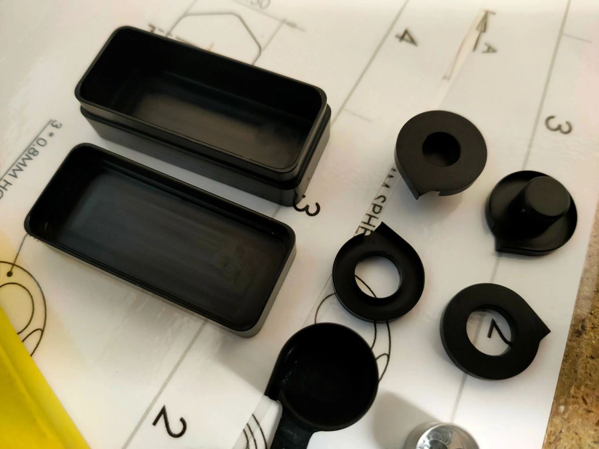

MS Hobbies in the UK are selling new aluminium cassettes:
I'm just about to enter the world of slitting and loading my own film and am considering these cassettes.
These look quite all right, I believe I will purchase a couple. I like the appearance of those grey ones :smile: . Any Minox users out there using these already? Any thoughts on them?
These look injection moulded. How often do we see injecion moulded 3rd-party spares?
