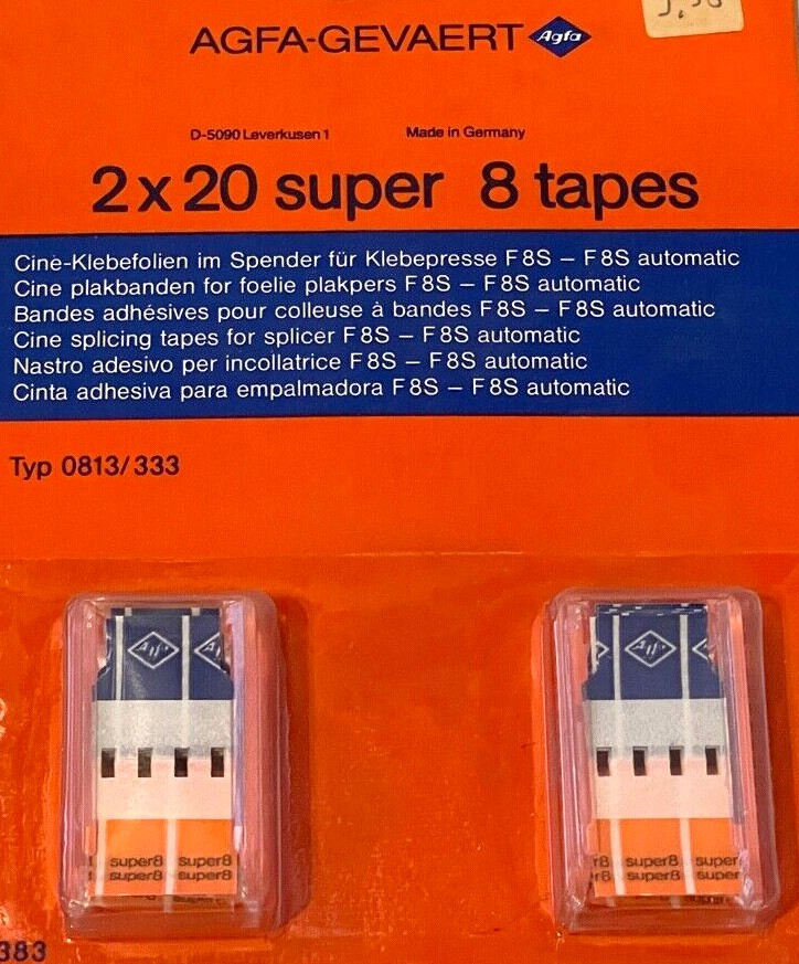

Just a thought: would the tape used to join the ends of the film (after splicing it) work? I mean, the tape would have to be extremely thin, so not to catch when the film is rolled in the projector. I know Agfa made some of this tape, certainly other manufacturers had their own.
Perhaps it would be worth checking out the Agfa Klebefolie, made for 8 and 16mm film. I would say that if the thickness of the tape is satisfactory, then the 8mm version of the tape would fit the height of the cassette spool (together with the cap), so you do not have to cut the tape in half.
There is a possible issue with the age of the tapes, probably the very old ones would not have the glue active.
Hope this helps!
Similar tape is used to splice audio tapes. But I also got super thin household tape. One has to look around.
