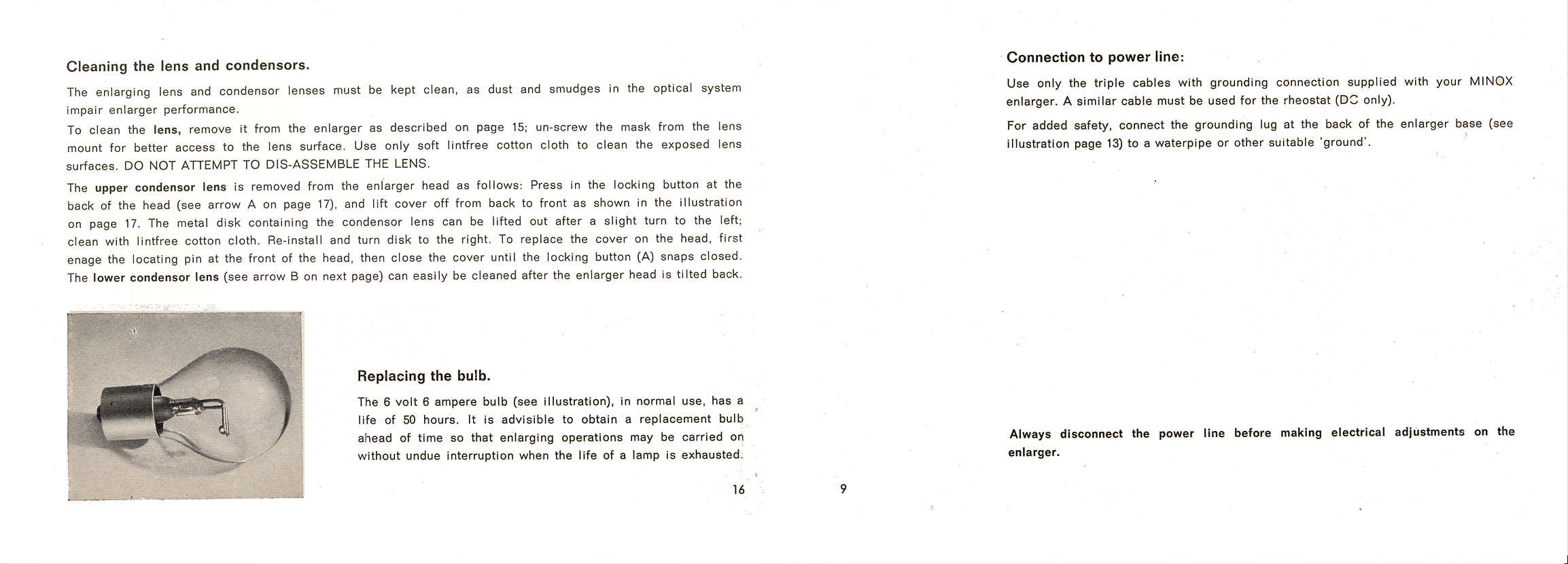

Thanks for the questions about the Minox lamp. According to the Minox manual, the lamp operates at it's rated 6 volts and is therefore rated 36 watts. It is a bayonet type lamp with a single centre contact. The stange thing about the lamp is that the two filament supports are "L" shaped so that the filament is positioned off centre. This is apparently quite important as it is required for the optics of the condenser system. I have attached the page from the manual which shows the lamp.

I come across some Minox camera or some accessory but have not come across an enlarger so far. I looked at that lamp and though knowing a bit about lamps and even ones with excentric filament position, still I am puzzled by yours.
In case you cannot find a spare, you could
-) use a standard 6 Volt lamp with Ba15S foot
-) use a halogen bulb (maybe with new power source) where you place the filament in the old position
-) modify a 35mm enlarger for 8x11

AS it happens, I have one of those to spare -- this one is in a box that says it is 6v 3a, and says BA15s, which I suspect is the description of the base on it -- it is the proper type of bulb, with a bent-right angle filliment mount and would probably work fine, just not draw so much amperage so it might not be as bright (i am just guessing here -- ask someone who knows electricity).
In any event, if you think it will work, and are willing to pay the postage from Utah to wherever you are, it is yours. It was given to me and I'm happy to pass the savings along...

I guess that problem is solved.
If now someone could explain the idea behind an excentrical filament position in this application.

the design of the L filiment post is to make sure the light is positioned precisely where the optics of the condenser require it to be for maximum illumination...or so they claim.
I had an earlier minox enlarger that didn't use this bulb -- just a straight bulb with normal filiment, and it worked fine. The later enlargers are nicer, though, and use this bulb.

A more standard lamp with the filament in central position could be put in the right position too. All other point-light enlargers work that way.

No, they are not like automotive lamps. The lamp shown in that manual is definitely, as any other enlarger lamp, overrated and does not stand long.

I know of people that tried to use a car headlamp bulb, but it left a shadow of the filament on the print. The Minox enlarger is a very specialised item, developed for the tiny 8x11 mm negative - approx. 1/10 th size of a 35 mm negative. It uses a special 15mm lens wheras 35mm enlargers tend to use a 50 mm lens. I think Leitz manufactured a 25mm enlarger lens but have not seen one. With the Minox negative you would need a long distance from the lens to the paper using a 50mm lens. Durst used to make a carrier for 8x11 film but I have not seen one. Minox reckon the lamp only has a life of 50 hours. It has been suggested to use a 12v LED lamp fitted into the housing but I do not know what wattage to try.
