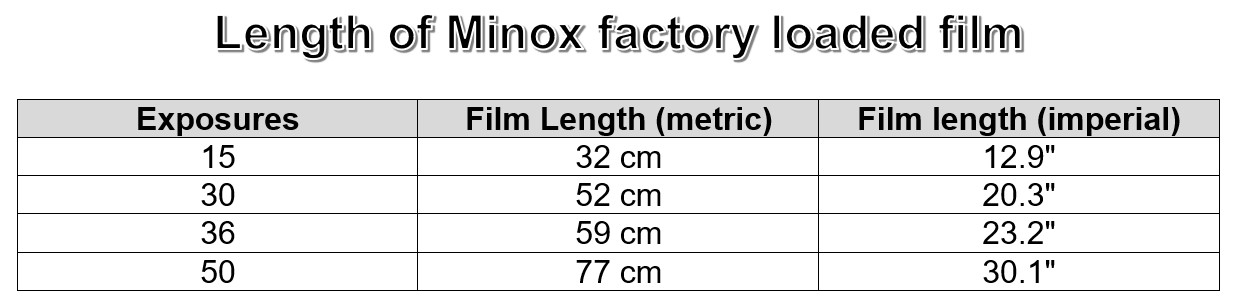

Oh yes, if one put a motor on the J-Li cutter, one could cut the worlds supply of Minox film in hours :smile:
This is my cheat-sheet showing how to get four 36 exposure loads from a single 36 exposure 35mm roll.
I found it easier to load first in to 35mm cartridges, rather than cutting the bulk film on its spool.

The original Minolta film strips (I have some still) were about 24" long. Before cutting Minolta strips I put a clamp on my benchtop 2 feet from the wall, so I can measure it out in the dark.
For Minox, it turns out the strips are about 1/2 the length of a 36 exposure 35mm load.
