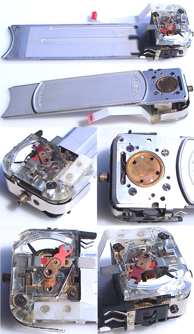

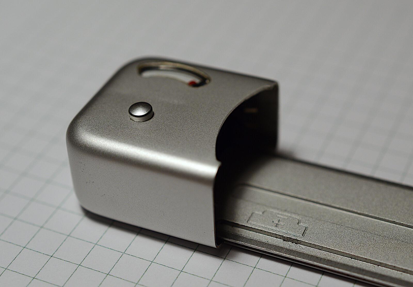

My Minox BL lightmeter got buckled. The needle obviously is blocked at one end. As the meter is one of the nice features of this camera, I would like to get it working again. Is anybody experienced with opening the aluminum cap with the meter. I'm rather sure, that a repair of the meter itself cannot be this complicated. Of couse a service manual would be welcome.

Well, once I inquired here on camera meter repairs. It seems no one here ever repaired meters of that size.
A meter needle hardly blocks at one end out of nothing. I rather assume a bearing fault.

I have tried a few galvometer repairs in the past, but never with success. They are so fragile, I think sometimes one can destroy them by just looking at them wrong.
If the meter needle is physically stuck at one end, it is usually caused by either 1.) coil is off the pivot or 2.) the magnet that the coil pivots around has attracted a metal particle(s) and the coil is prevented from moving or 3.) hairspring is damaged. While the movement is not complicated, it takes careful surgery to repair these as they are quite delicate.

I have a BL with broken meter. DAG sent it back. No replacement meters for BL. Luckily I have a backup BL.

I already started a thread in this matter long ango. To no avail. But as there is no commercial or other repair, we only got two choices: try to repair oneself, or put it away for better times and a repairer to show up.

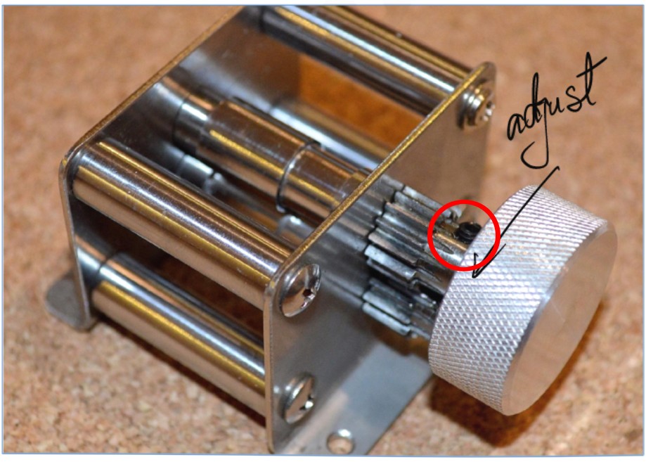

Jimmy and I befriended while he was researching the 8x11 film cutters, prior to build them. Very good machines, steel all over. Have reviewed the cutters here:
http://juliantanase.com/minox-film-slitter/
My own cutters made by Jimmy, in both formats. Best of both worlds of submin photography, as it were :smile:
In you review of these slotters you say:
"The adjusting screws are doing wonders, if and when we need to adjust the width of negative or the pressure of the cutting rods."
I do not see any of such miraculous adjusting rods.
-) the width of the strips is machined into to the two cutting rollers
-) the rollers are basically selfguiding, regarding lateral movent
-) the distance of the roller axles is fixed by the holes, "bearings" in the metal sheets
How much the rollers dive into each other could in principle be controlled by a respctive design, I myself got a roller contreption that does so in a great way. But for roller slitters this makes no sense.
At best/or worst there may be some wobble in the metal sheets and if the sheets should press against the rollers, by adjusting those screws you might not only add breaking friction to both rollers, but induce some lateral shift employing a residual play between the roller incisions, but this would not affect the cutting width.

Thank you for letting me know, this is a typo,. I meant modifying the distance between rollers, so it can accommodate a different thickness of the film negatives. So instead of width (which is obviously the wrong word here) one should read thickness. How is this useful, I believe it rests with the users.
So please disregard the word used. It was clearly not the right one, thank you.
LE - I am not talking about the 4 screws that hold the plates together; I am talking about the screws which are embedded into the milled end of the rollers. I guess the next picture (the one with the pink highlights) is easily confusing.
