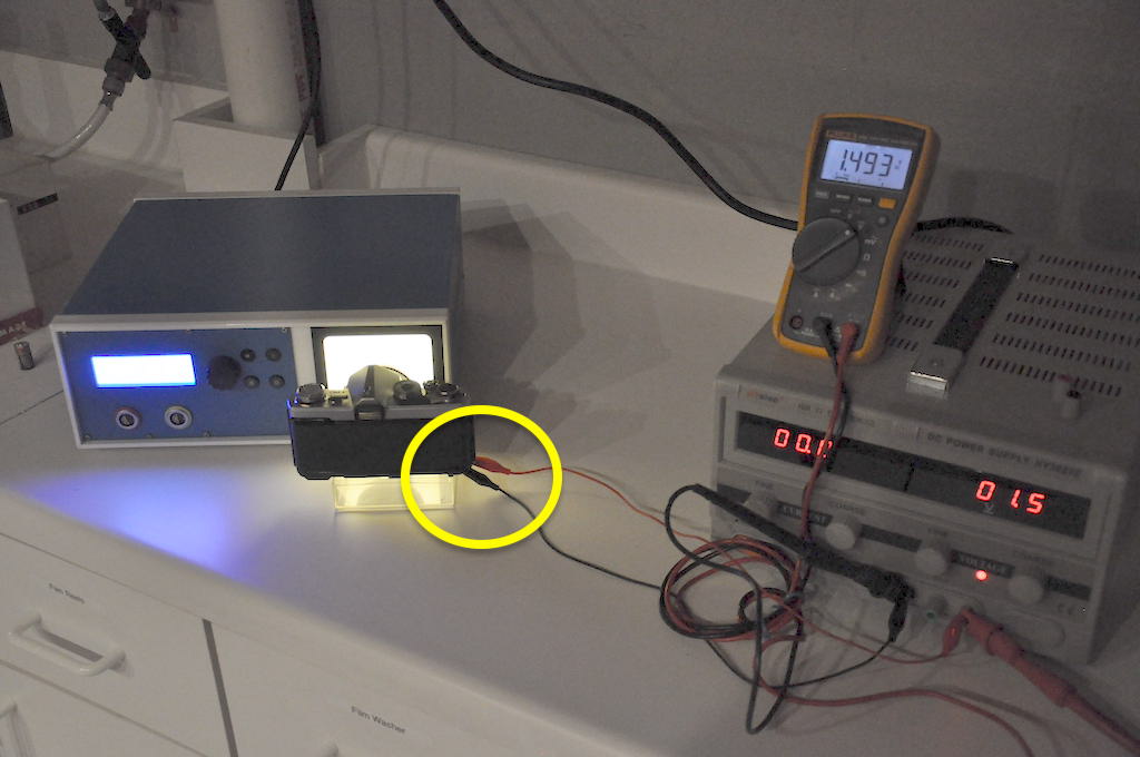

A variable power supply is nice for these situations. You can jumper right to the solderd contacts for the battery holder. You can get one for $25 on Aliexpress or other sites.
A variable power supply is nice for these situations. You can jumper right to the solderd contacts for the battery holder. You can get one for $25 on Aliexpress or other sites.View attachment 391377
What camera is that? And what kind of power supply? Do you have any tutorials or instructions you can link me to?
This is a very appealing option, because battery reliance is my biggest enemy. I'm reminded of my endgame computer mouse hunting where I was looking for ways to mod my mouse to make it rechargeable, because having something rechargeable is infinitely better.
That is an OM-1 with 1.5v applied to the battery contacts. The camera is getting calibrated for a 1.5v battery in that case, but in cases of corroded battery box, the clips can be attached to the wires coming out of the battery box to power a camera for testing.
