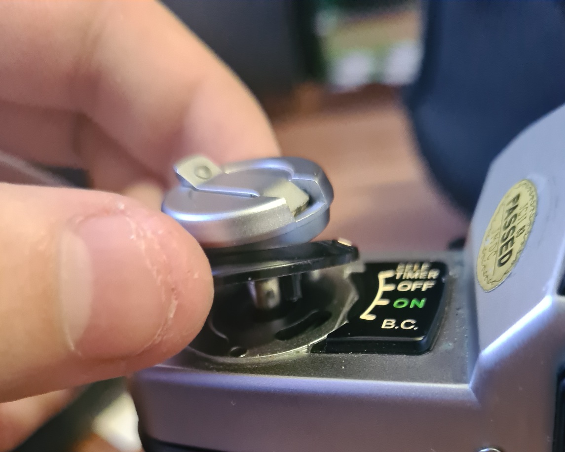

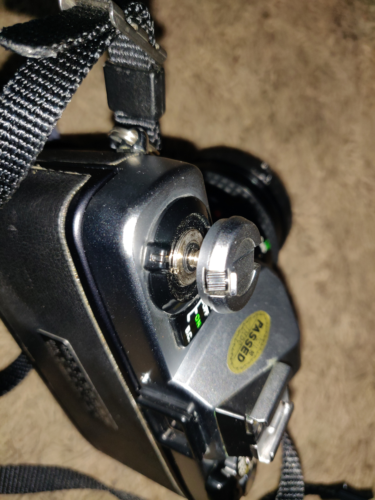

I lifted the thing to open (sorry I don't know the name, I put the photo) and the "on off" lever came off, and I can't put it back. Do you know how to do it?
There's a reach nut that should have been under the rewind 9knob. It threads onto a plastic shaft that may have snapped. The little hole on top is for a small spring and ball bearing that is the detent ball for the switch. The plastic shaft on mine broke but seems to work so far just using super glue to put it back together.
thanks, at the end i took it to a repairer, i hope it doesn't cost too much :0
