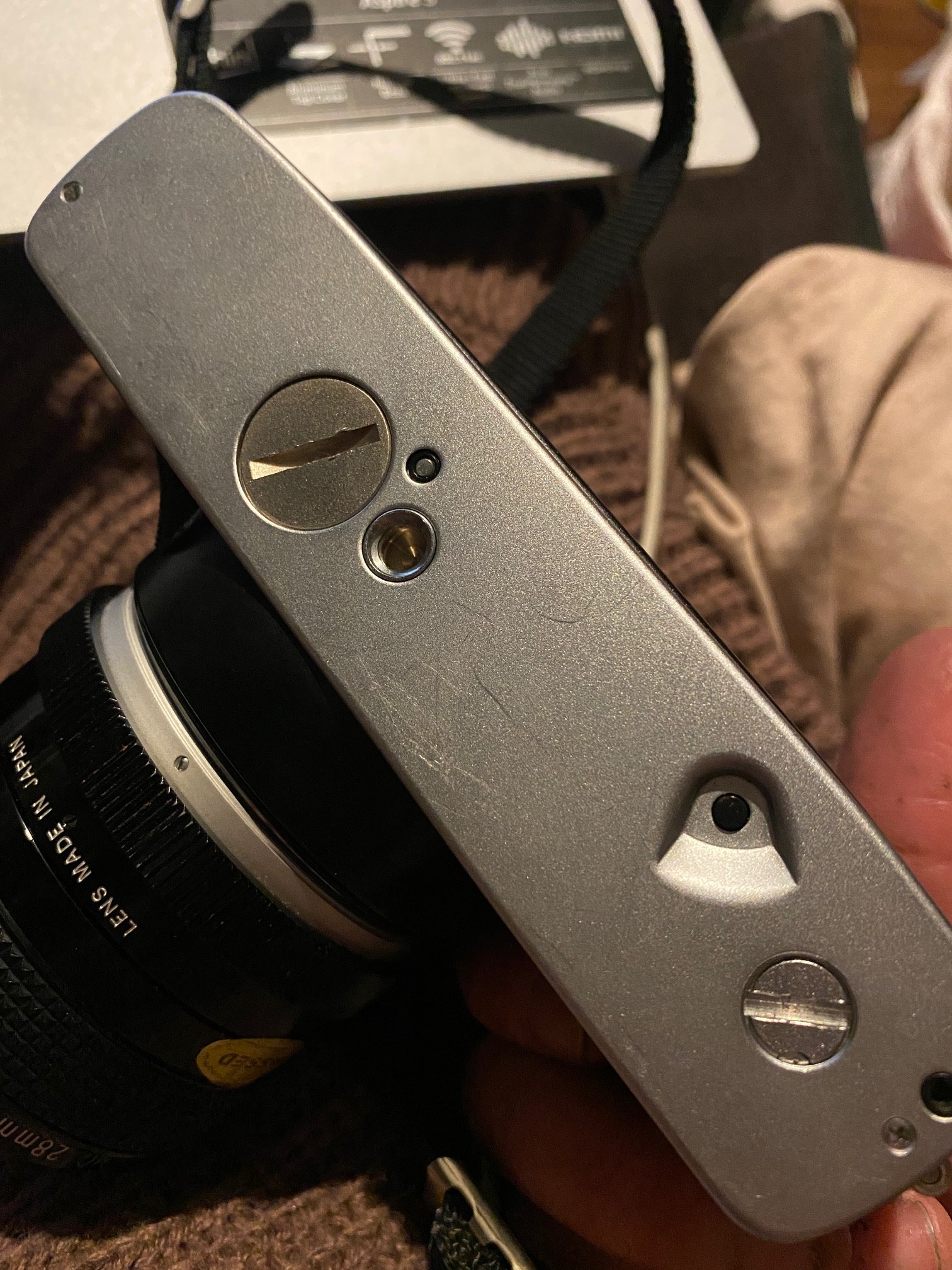

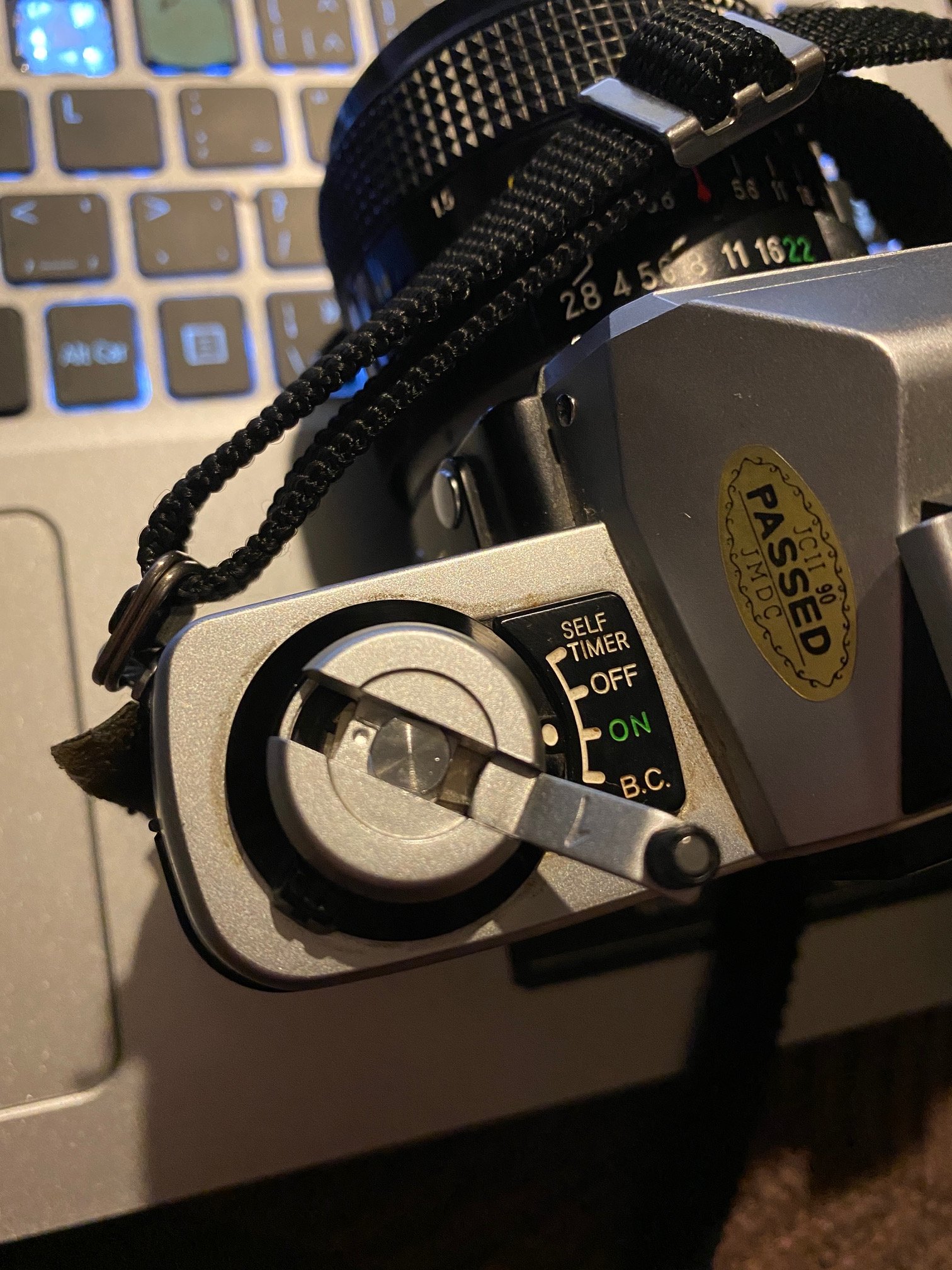

*I NEED HELP*
So a while ago (probably last summer), when I was rewinding my film I believe, I ended up taking the whole rewind knob off. And then reassembled it incorrectly.
I've reassembled now, and I believe it's correct, but I cant get the current roll to wind up into the canister and I don't want to ruin this roll!
What do I do??
Camera is Minolta XG 1.

if I understand correctly, you want to remove and not lose a roll of film that you cannot rewind into the canister, for whatever reason.
You need a light tight environment, either a film loading dark bag, a darkroom, or a place such as a room or closet you can make entirely dark.
In total darkness for the camera and film, make sure the rewind release on your camera has been pressed, open the camera back, remove the canister from the left side of the camera and carefully start to rewind the film by hand into the canister. It should come away from the right hand side of the film take up.
If you develop your own film you may as well load the film onto a developing reel while in the dark environment, rather than rewinding it into the canister.
Good luck, it's a real pain to face losing an exposed roll of film because it can't be rewound.
I hope this replies to your question.
