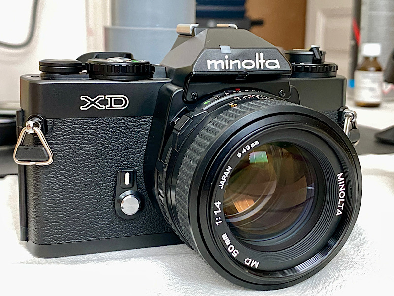

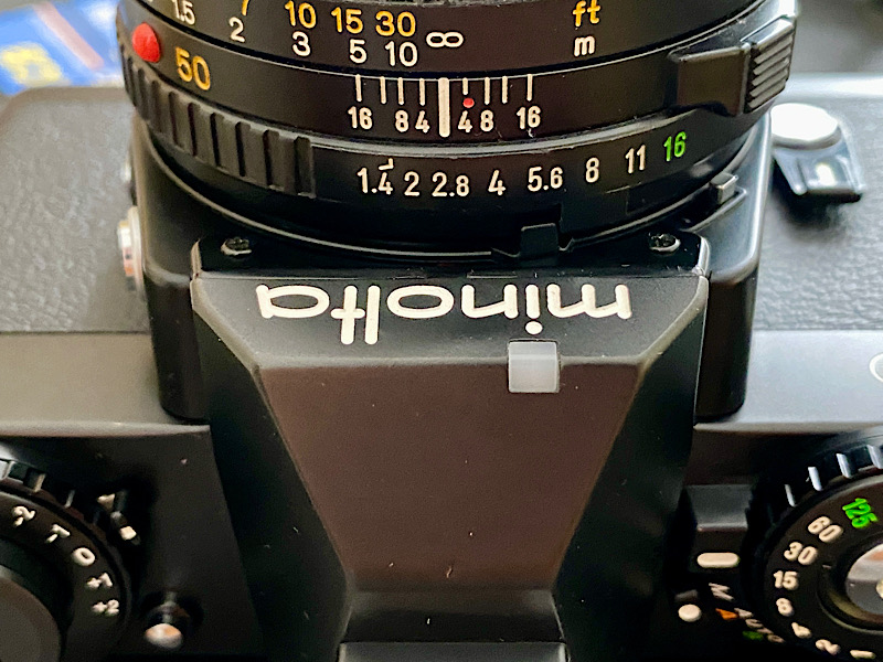

I just purchased a mint XD whose top cover is dented.
I am informed by the seller (who kindly provided me with these photos) that it was caused by transport damage.

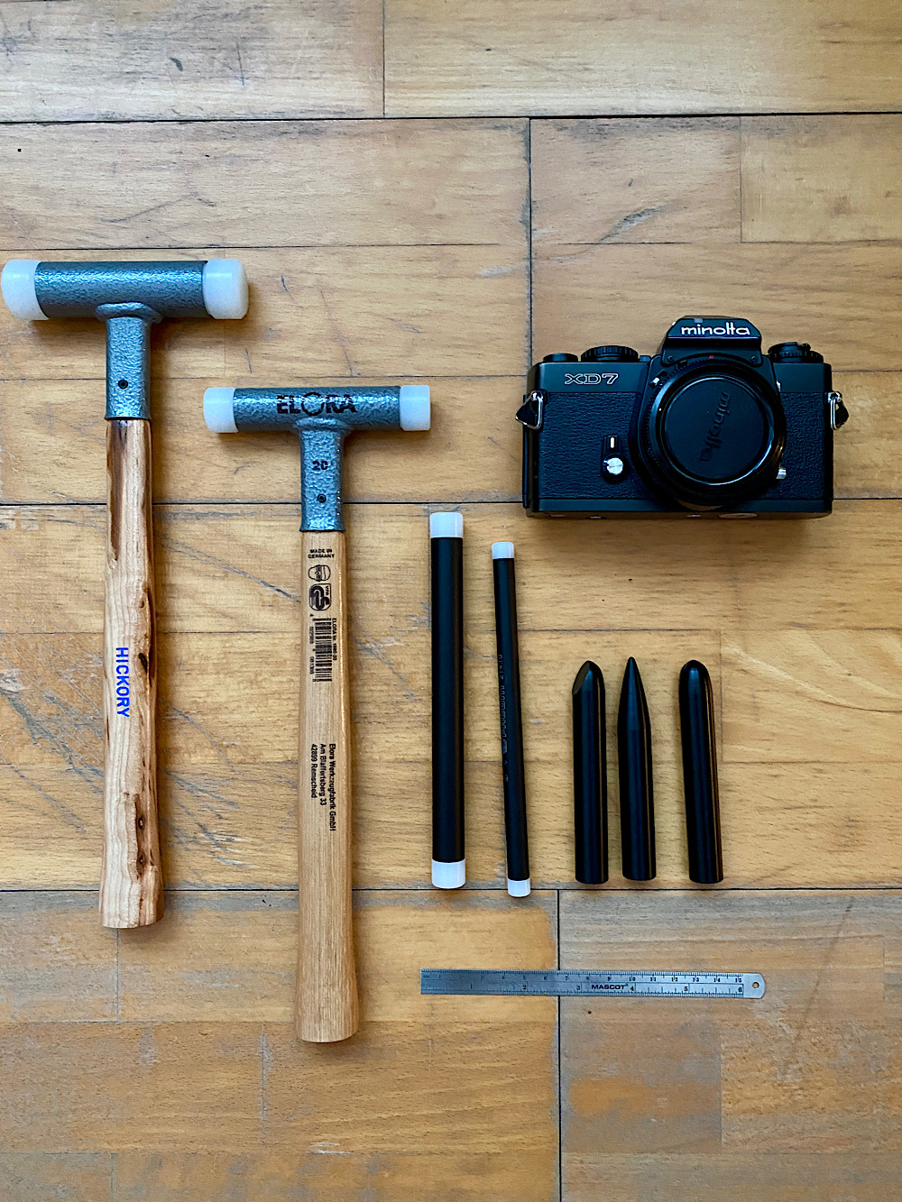

These additional tools were delivered today.
Two hammers with shock-absorbing hickory handles, metal rods to hit with plastic caps and plastic rods. For size comparison an XD-7.
The tools could be a little smaller for the work ahead, but I'm confident 👍

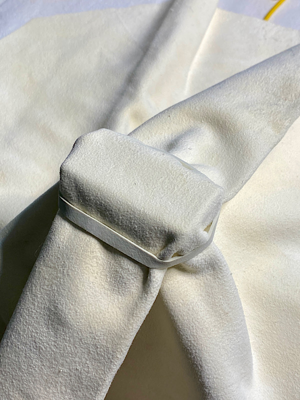

My wife was so kind to get me this chamois leather.
I will use this to cover the steel vise on which I will place the bent cover for alignment.

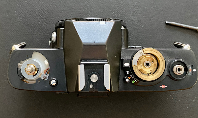

Since I haven't worked with the Minolta XD (XD7, XD11) yet and this XD is - apart from the dent - as good as new, I'm watching this video to find out how to remove the top cover:
Dismantling the top cover to remove the dent

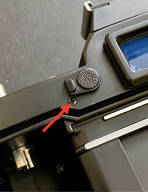

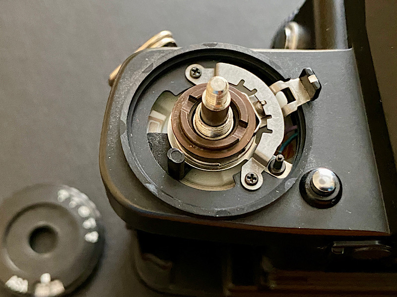

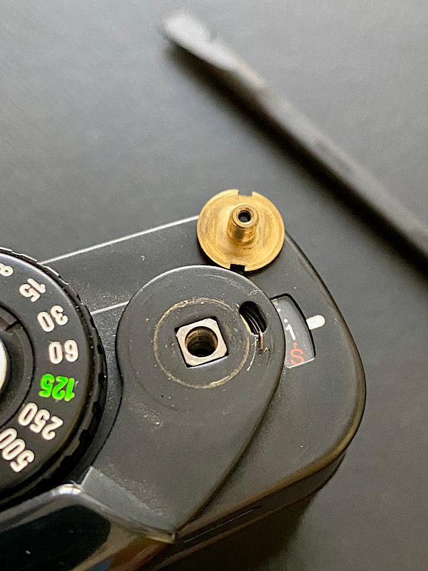

I carefully unscrew the cover above the winding lever using a rubber cloth, which increases the friction and thus provides a good hold.
Obviously this cover is not screwed in, but glued on.

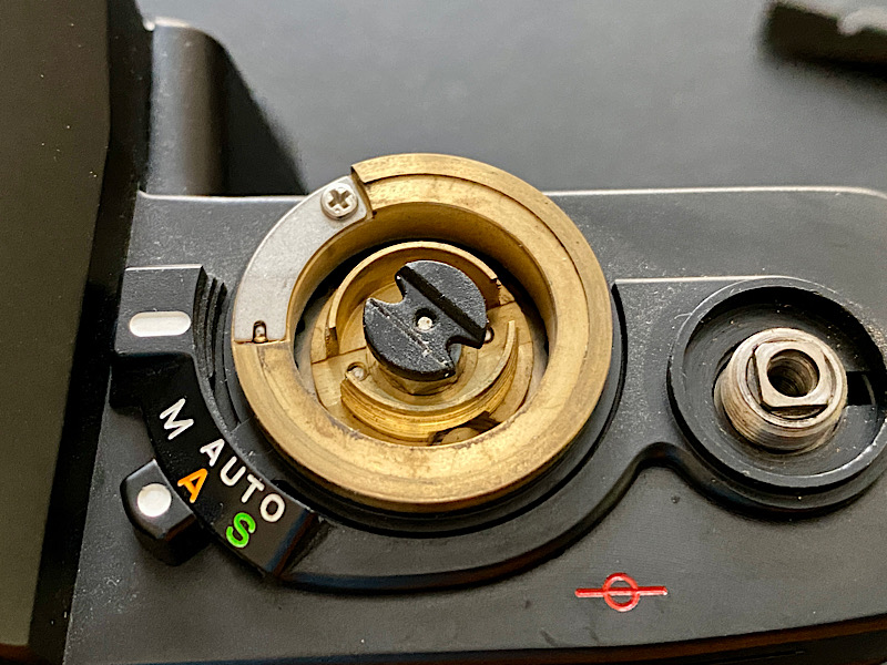

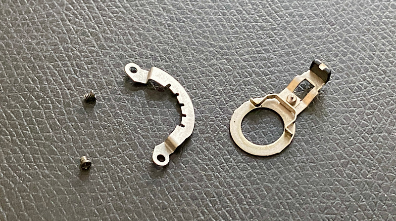

Further disassembly of the winding lever:

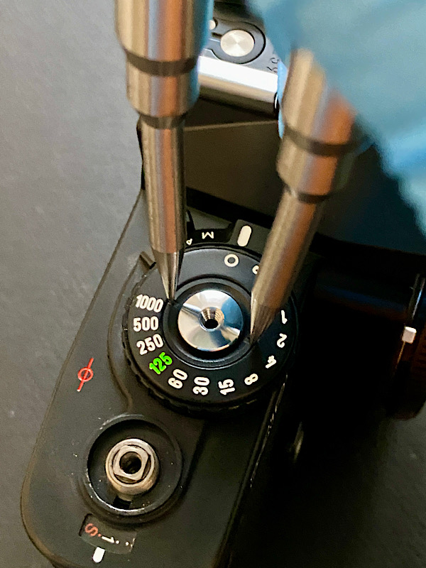

Shutter speed dial:
Rewinding crank:

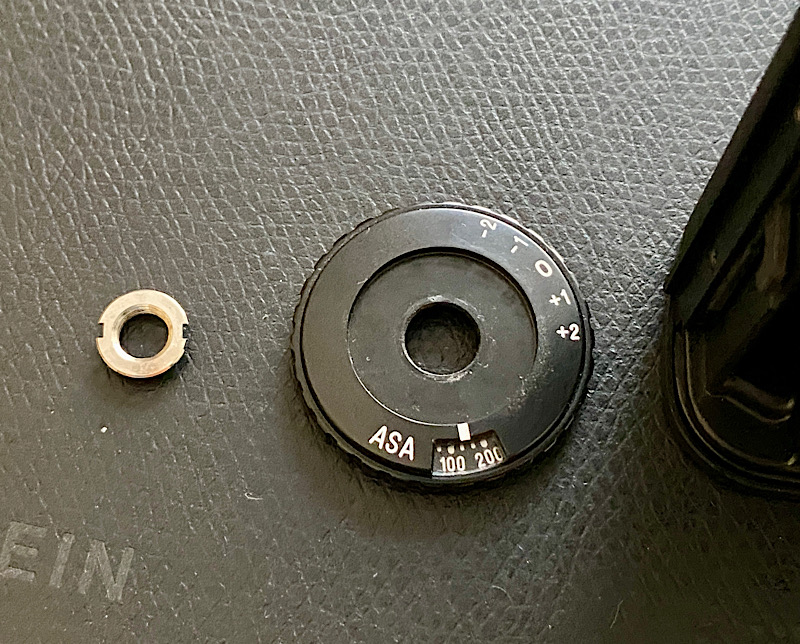

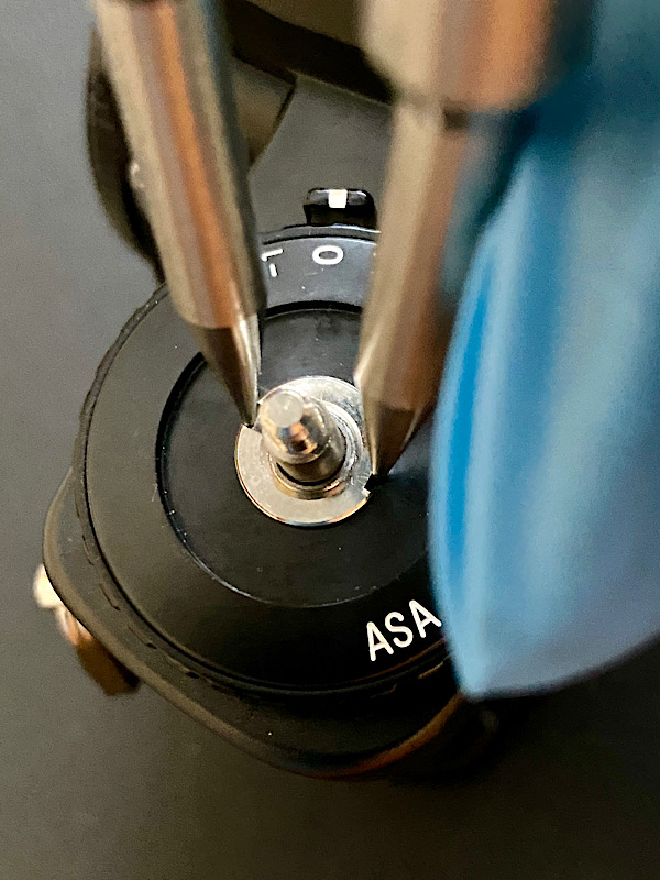

ASA/exposure compensation dial:
Front prism cover:

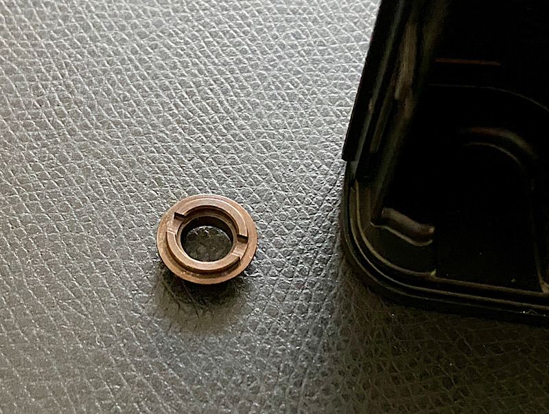

The plastic magnifying glass for the Aperture Direct Readout (ADR) for reflecting the aperture number on the lens into the viewfinder has come loose. I'll glue it back on later.

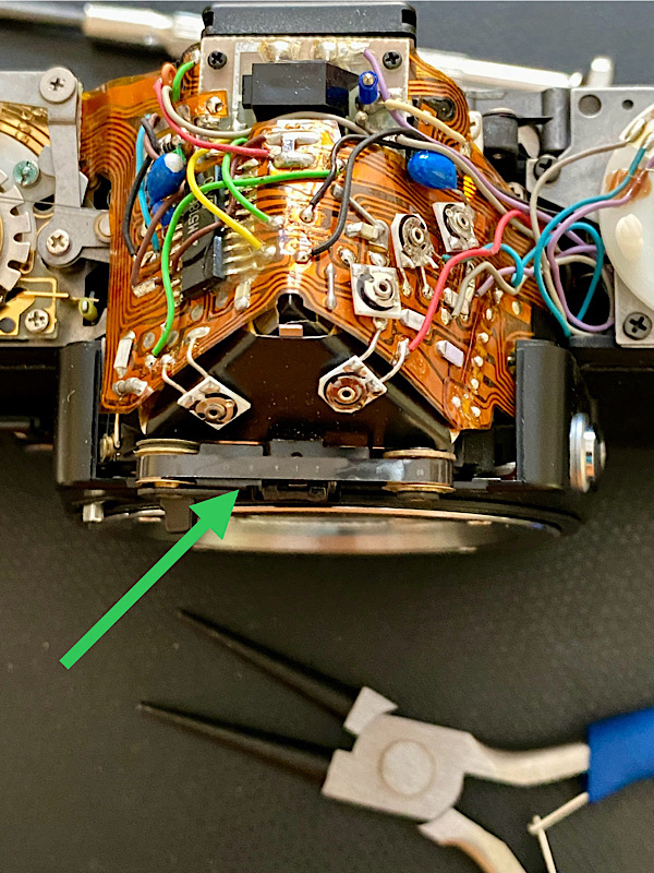

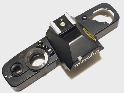

The top cover is not connected to the circuit board via cables. This saves you having to desolder it.

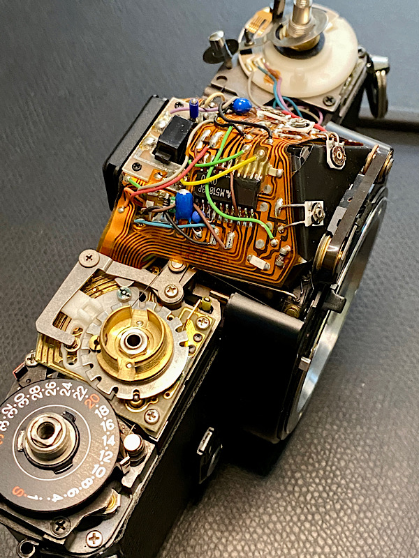

The electronics.

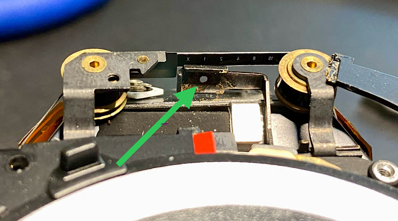

This movable band reflects the set shutter speed into the viewfinder illuminated by a light opening on the front of the top cover. The band is connected to the shutter speed dial via a cable.

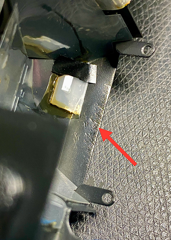

The dented top cover viewed from below.

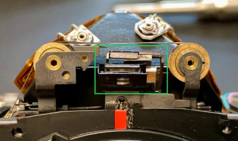

Not only the top cover is affected, but also the suspension of the shutter speed band and the ADR structure beneath.

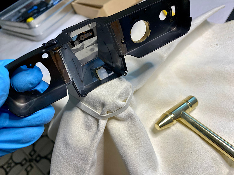

I use the copper hammer to knock out the dent on a small vice that I have covered with chamois leather. This protects the outside of the top cover.
I use both sides of the hammer and check the progress in between.
This looks much better now 🙂
I carefully adjust the band suspension with the needle-nose pliers.

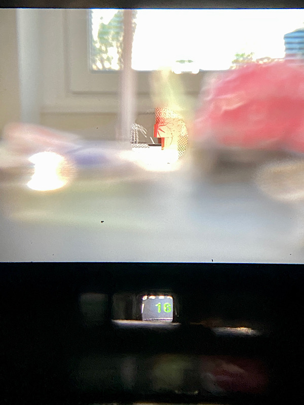

The height of the aperture reflection in the viewfinder is now correct, but it is still slightly tilted.

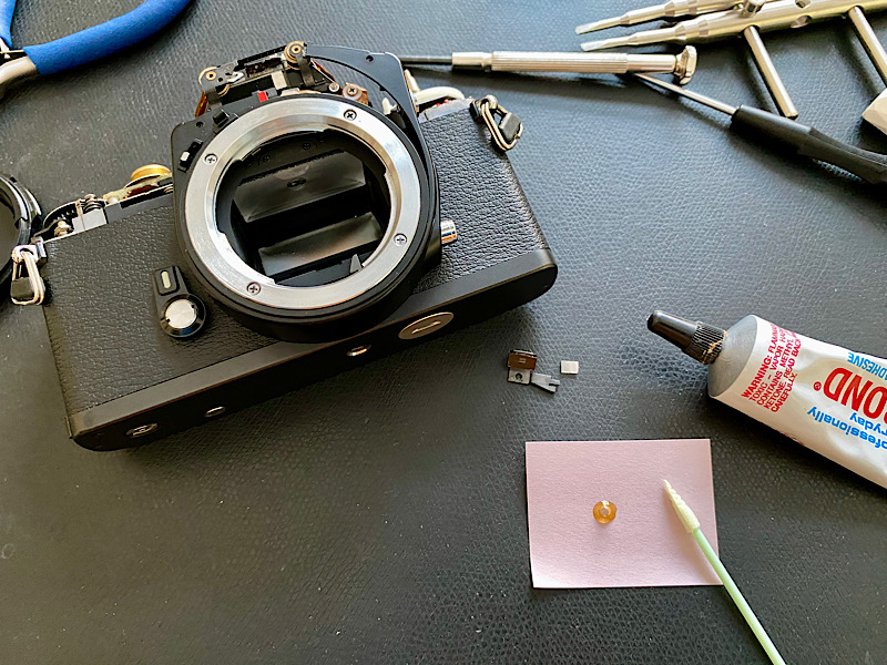

I remove one part of the ADR structure, fix the small mirror, which was loose, with Pliobond and adjust the mirror with the pliers.
Adjusting the angle of the small magnifying glass suspension located under the mirror.
Now I am satisfied with the aperture display. It sits straight.

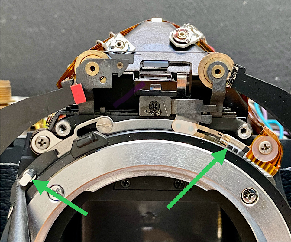

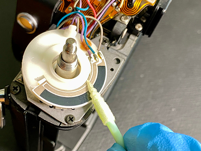

I clean the contact tracks and wipers of the switch for the smallest aperture on the lens with electronics cleaner.
This appliance allows the XD to implement shutter priority (S).

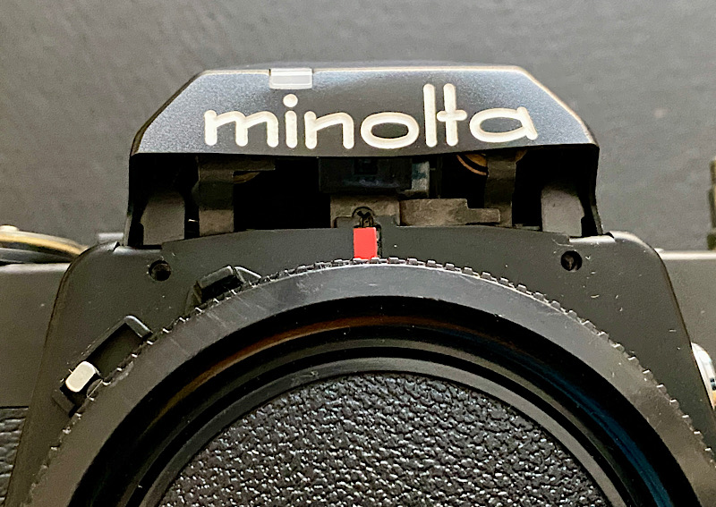

The side covers of the bayonet are made of plastic. I glue the ends with Pliobond under the red mark for changing the lens.
I remove any remaining Pliobond once the front cover of the prism is attached.

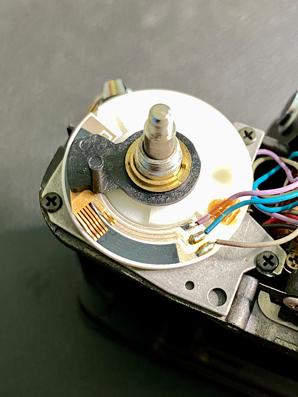

Cleaning and aligning the contacts of the ASA/exposure compensation wheel.

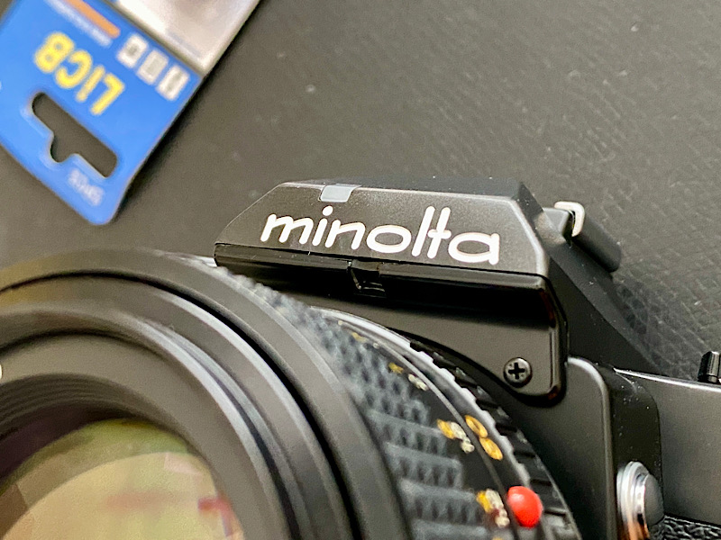

The marks of the hammer remain invisible after assembly.

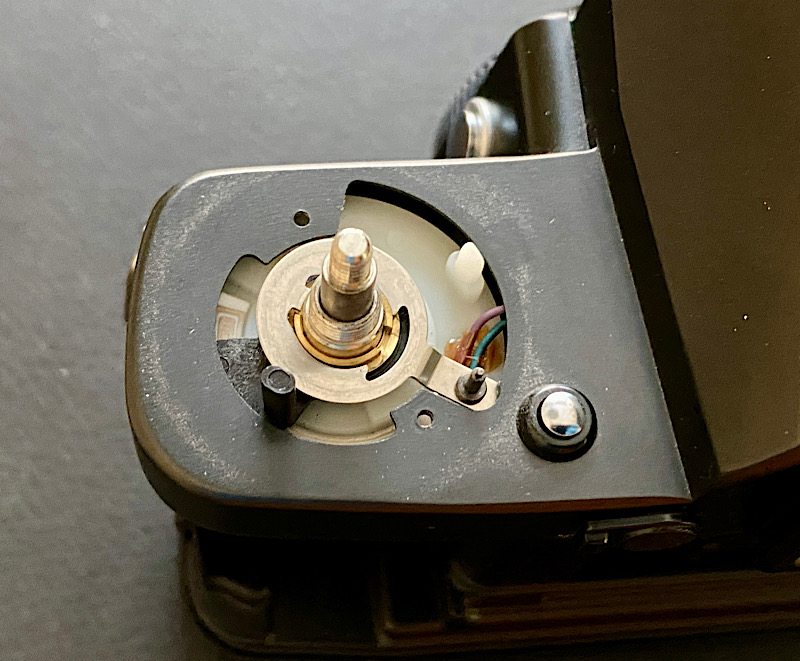

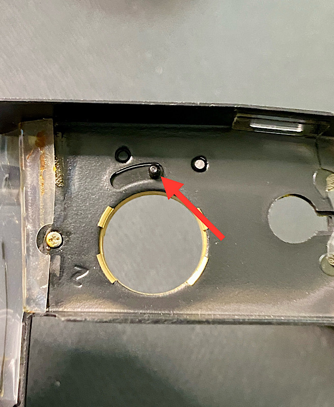

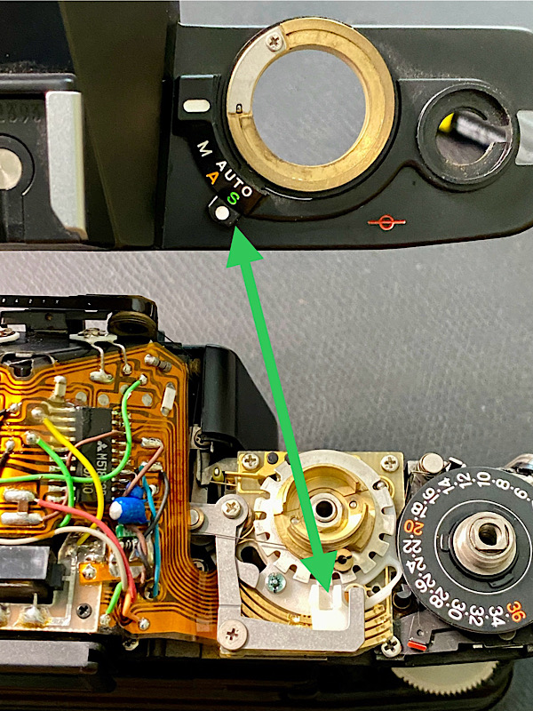

To couple the pin of the rotary ring to the main switch, I set both to position S.

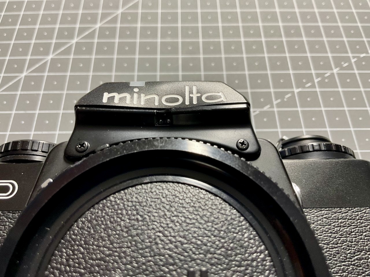

Fitting - the top cover can be put on easily.
Glue the cover cap with Pliobond.
Gluing the small magnifying glass into the prism cover with Pliobond.

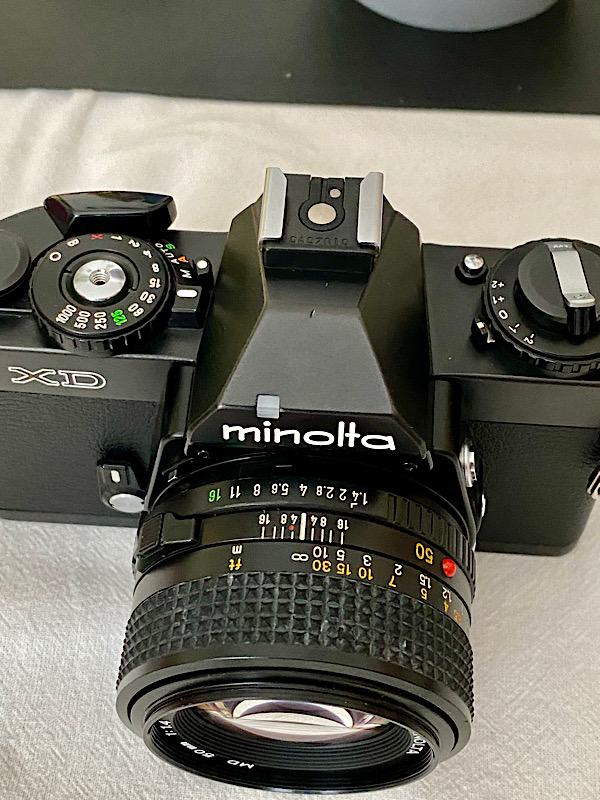

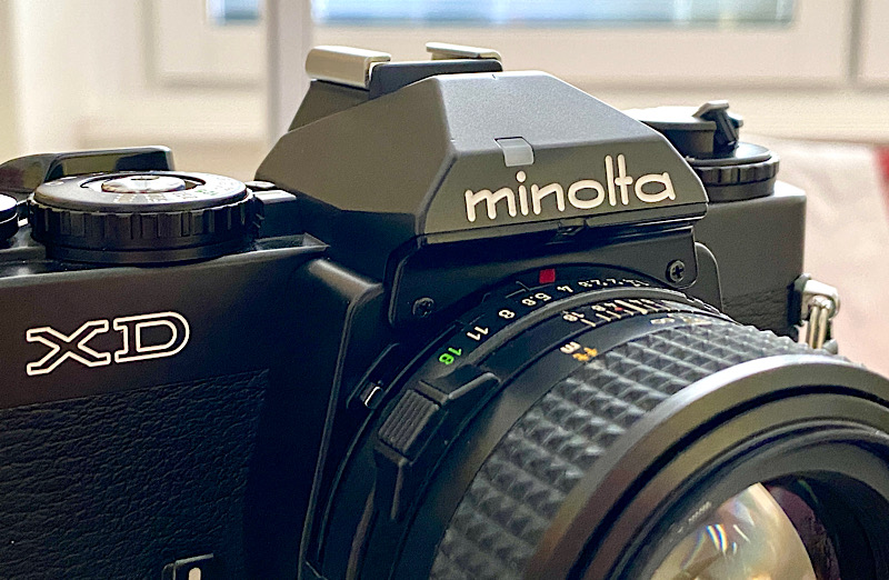

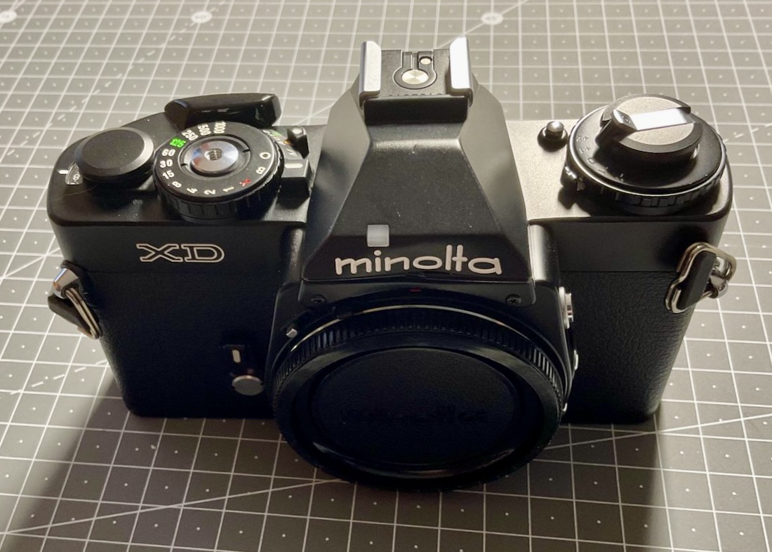

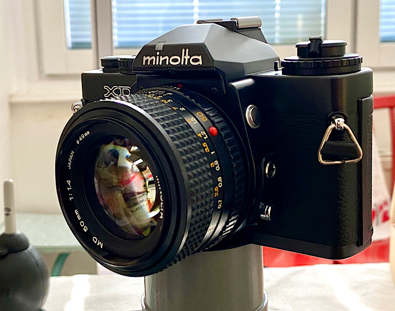

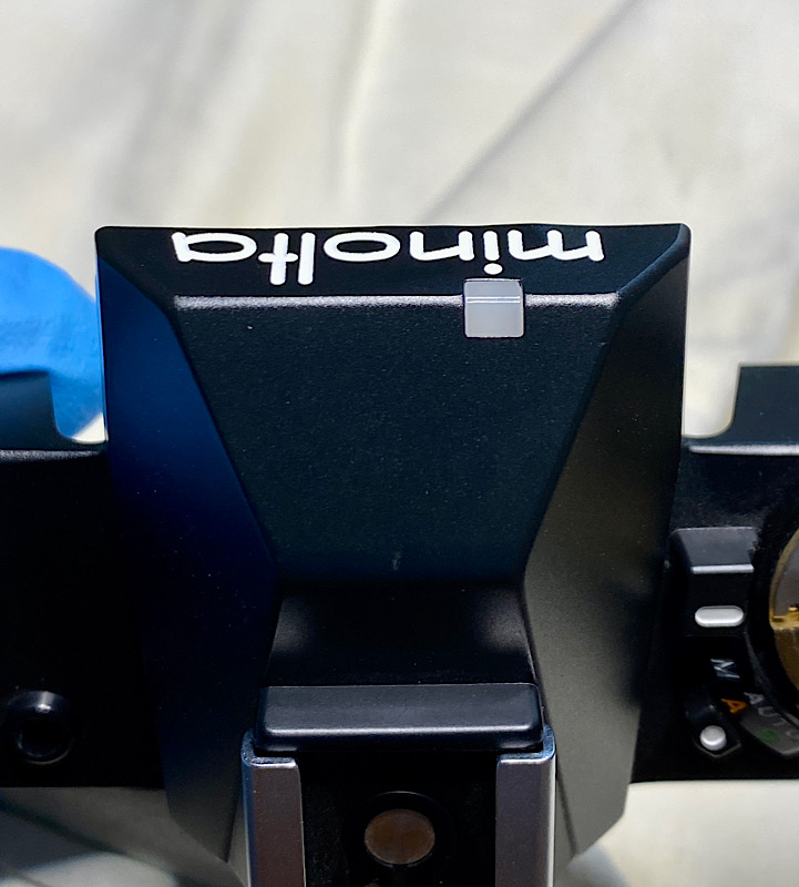

On the catwalk - before:
… and afterwards:
The result from different perspectives and lighting.
