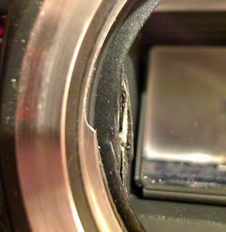

may have found the problem with the x-700
as i was cleaning i see this
<Wary of being sucked in again>
Is that foam or flocking coming loose or is it bent metal (result of a blow which undoubtedly also changed the alignment of the lens mount)?
If deformation from a blow, it's a wonder you got any kind of sharpish image at all...
If loose flocking, it shouldn't have a large effect, unless it really is seriously blocking the light path.
i really dont know what you mean by that comment
however back to what you said its some sort of canvas or flocking as you called it
i have not seen it show up in any photos maybe a bit of glue would fix it ???
Glue would probably fix it, but at this point I'd be wary of the camera's general condition.
The camera should really be checked over carefully.
The steps for a sharp photo which I gave a few posts ago should be repeated, but with the lens also => set at full aperture.
That would help show any lens alignment problems.
There are a whole series of tests which you can carry out using one roll of film; if interested, ask.

well the black part seems like some king of card the white seems like some kind of cloth ???
i thought maybe a little super glue would fix it
White cloth: Asbestos? :wink:
Seriously, a contact cement would be a better choice than superglue (mainly, much less brittle).
