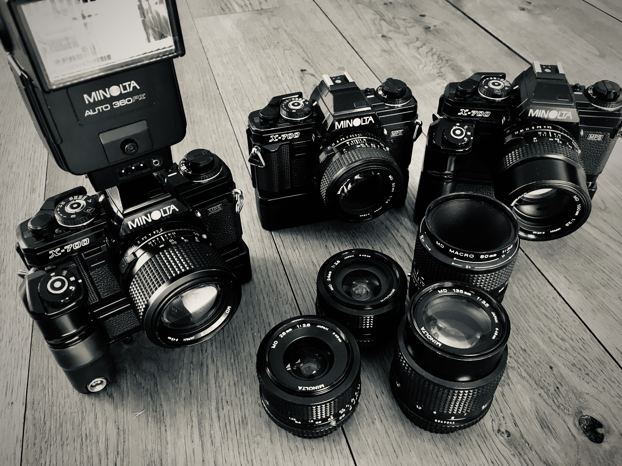

I have 3 x-700, 1 x-570 and 1 x-370. None of the meters have ever caused me a problem.
