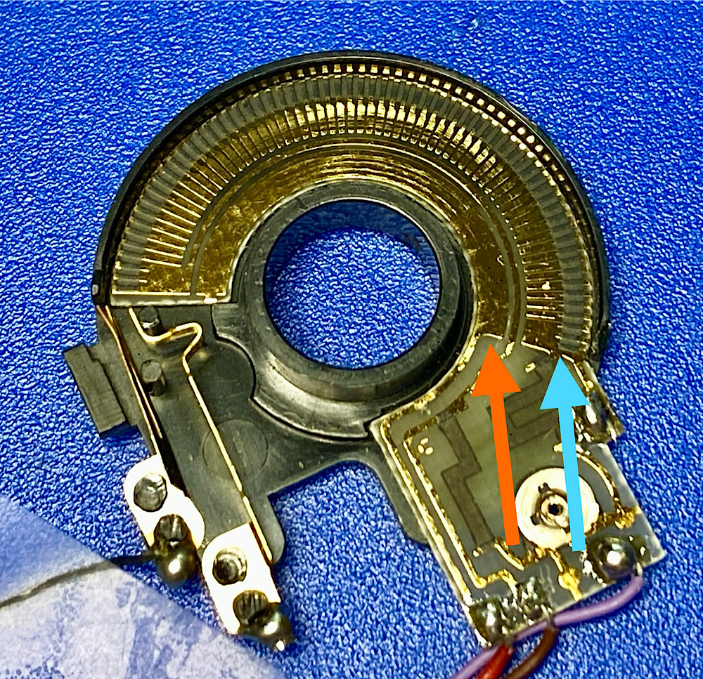

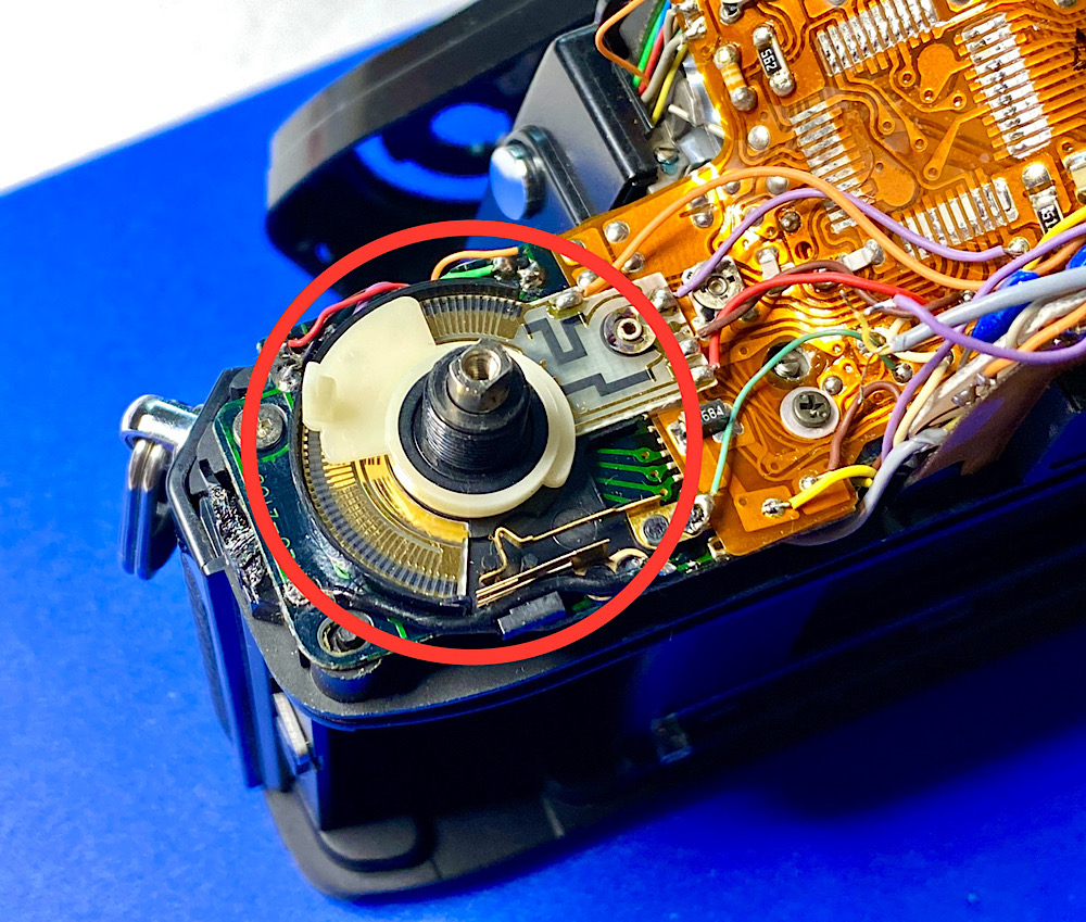

On the left side of the X-700 there is the rewind crank with ASA setting and exposure compensation dial which can be rotated:

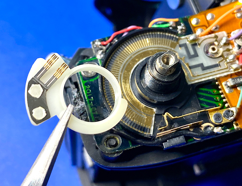

This is what it looks like under the top cover:
A ring with two wipers that are electrically connected to each other rotates on gold-plated contact tracks:
Here you can see the setup parted from the camera.
The arrow points to the two wipers, which run separately on both contact tracks:
The inner contact track is narrower and runs continuously without interruptions (orange arrow).
The outer contact track consists of individual, separate contact segments that are electrically connected to each other via a grey layer of resistance material (blue arrow).
Everything together including the wipers results in a variable resistor:
Variable resistor: changing voltage
A variable resistor allows you to alter the amount of current that flows through the resistor.
This also changes the voltage that drops across the resistor integrated in a circuit, e.g. 2 millivolts or 5 millivolts (2/1000 volt, 5/1000 volt).
And the circuitry of the X-700 can work with voltages.
Here, with the ASA setting and exposure compensation, the X-700 can distinguish between different voltage values.
Because when I turn the adjustment dial on the camera, the position of the wipers on the two contact tracks also changes. And since this is a variable resistor, the voltage values also change.
For example, the 2 millivolts could stand for ASA 100 and the 5 millivolts for ASA 400.
That's my assumption.

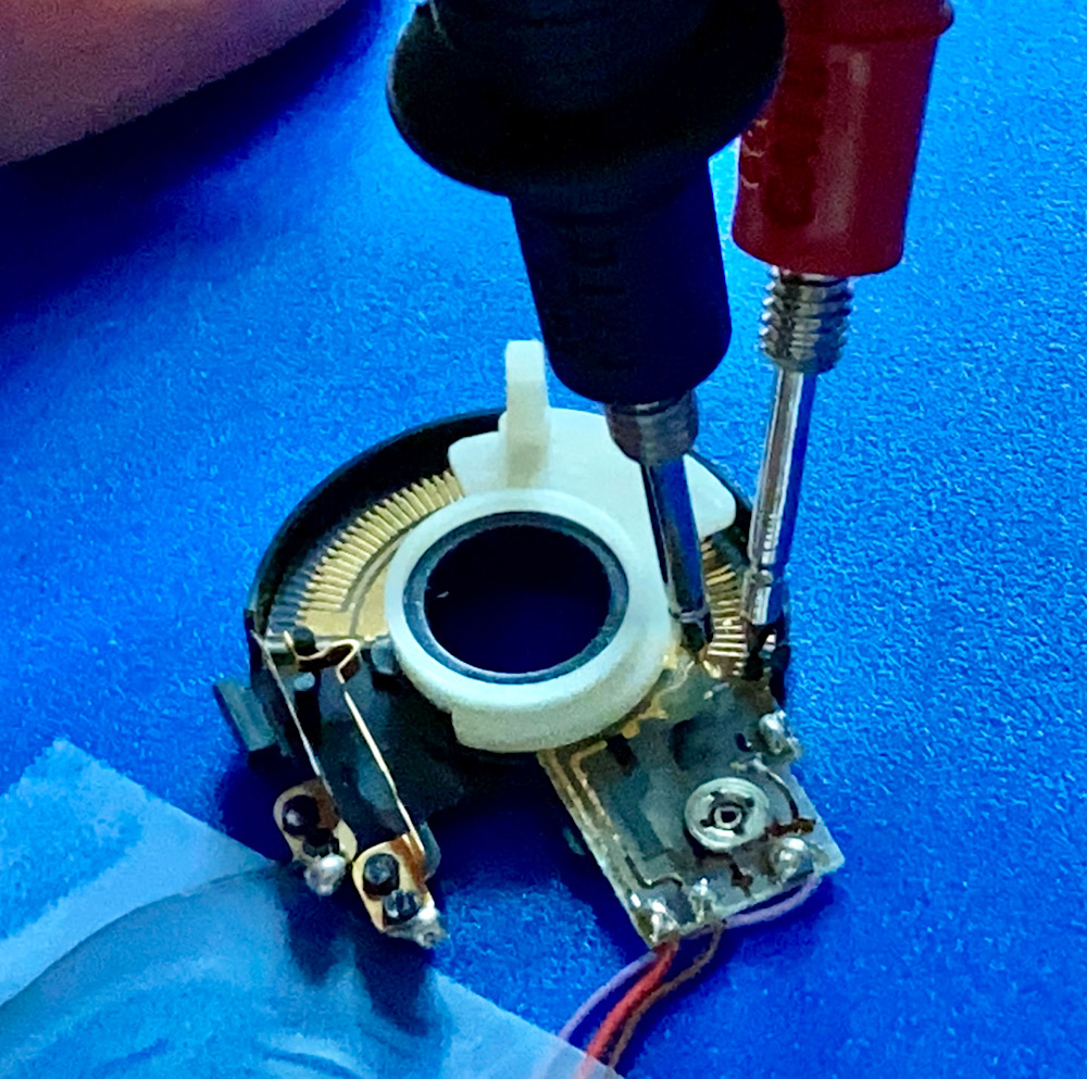

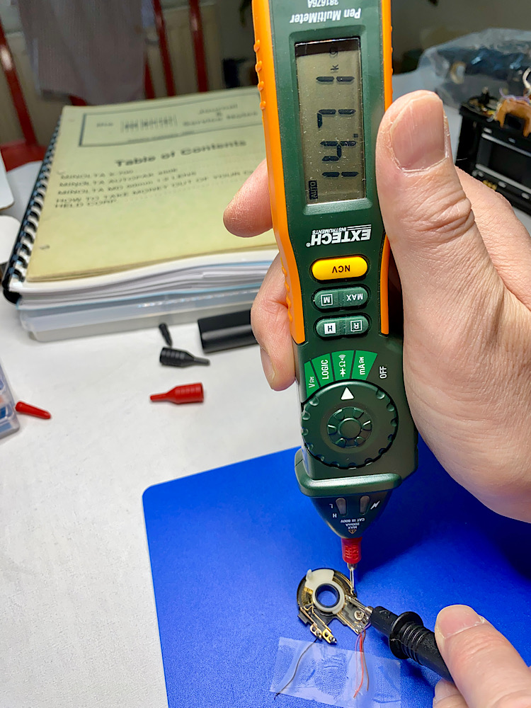

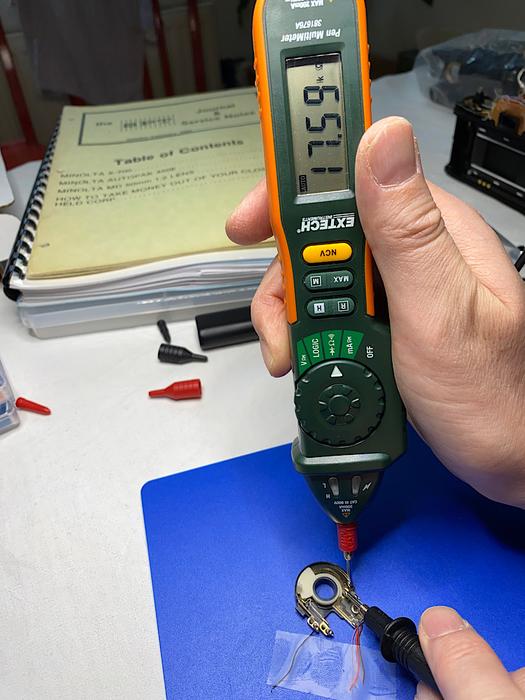

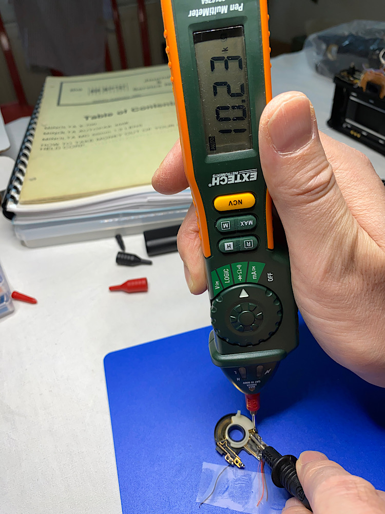

Multimeter in action
I wanted to determine whether this could be true by taking a closer look with my multimeter.
With a multimeter you can, among other things, measure the value of resistors. The higher the resistance value, the more ohms are measured.
Here the photo from before again:
I place one measuring tip of the multimeter on the grey resistance layer on the outer contact track and the other measuring tip on the inner contact track (purple circles).
Both contact tracks are connected to each other via the wipers, which act like a electrically conducting bridge (yellow bar).
When I switch on the multimeter, a measuring current flows through the grey resistance layer (+) across the bridge to the inner contact track (-) and back to the multimeter.
The further the bridge is from the measuring tips, the longer the resistance layer that the measuring current has to overcome.
This increases the resistance, less current flows and the voltage increases.
In a nutshell:
When I turn the dial on the X-700, the voltage values change and the camera knows which ASA value or exposure correction is set.
Measuring resistance
Here I measure different resistance values with the multimeter.
As already noted, the further away the two wipers (bridge) are from the measuring tips, the higher the resistance:
10.23 kiloohm (= 10,230 Ohm)
14.71 kiloohm
17.59 kiloohm
Confirmed 👍

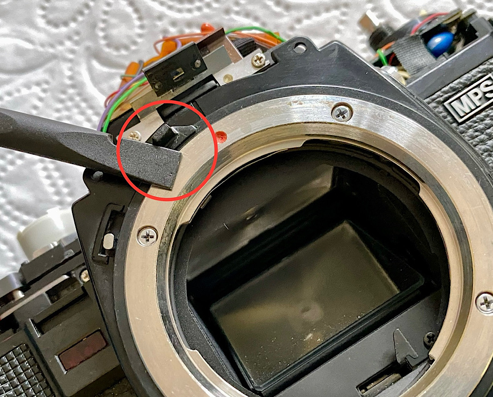

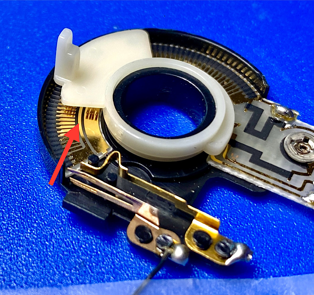

Aperture simulation

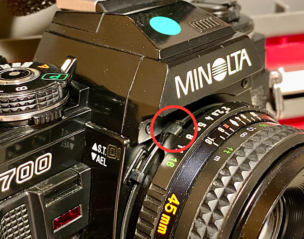

The aperture simulator on the X-700 with rotating ring and coupling for the lens should also work on the principle of a variable resistance.
In practical terms, this means that when you turn the aperture ring on the lens, the aperture simulator ring rotates and positions the wipers on two conductor tracks:

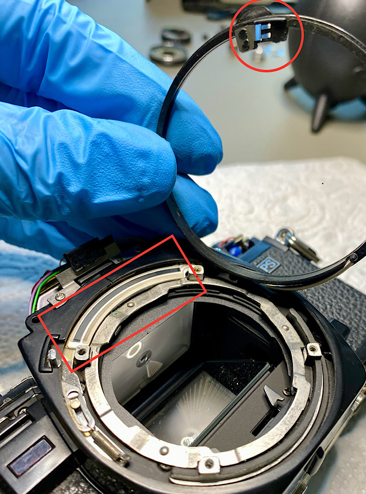

Here we see the two conductor tracks (which are located under the bayonet ring removed here), with the upper one being designed as a resistance track:
Two wipers are integrated in the ring and electrically connected to each other to form a conducting bridge:
Depending on the position of the wipers on the tracks, the current has to overcome different distances on the resistance path:
This results in different voltage values, which the X-700 interprets as aperture values and uses for exposure control.

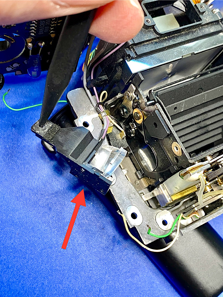

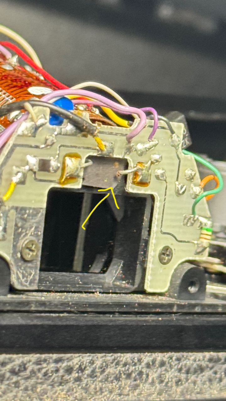

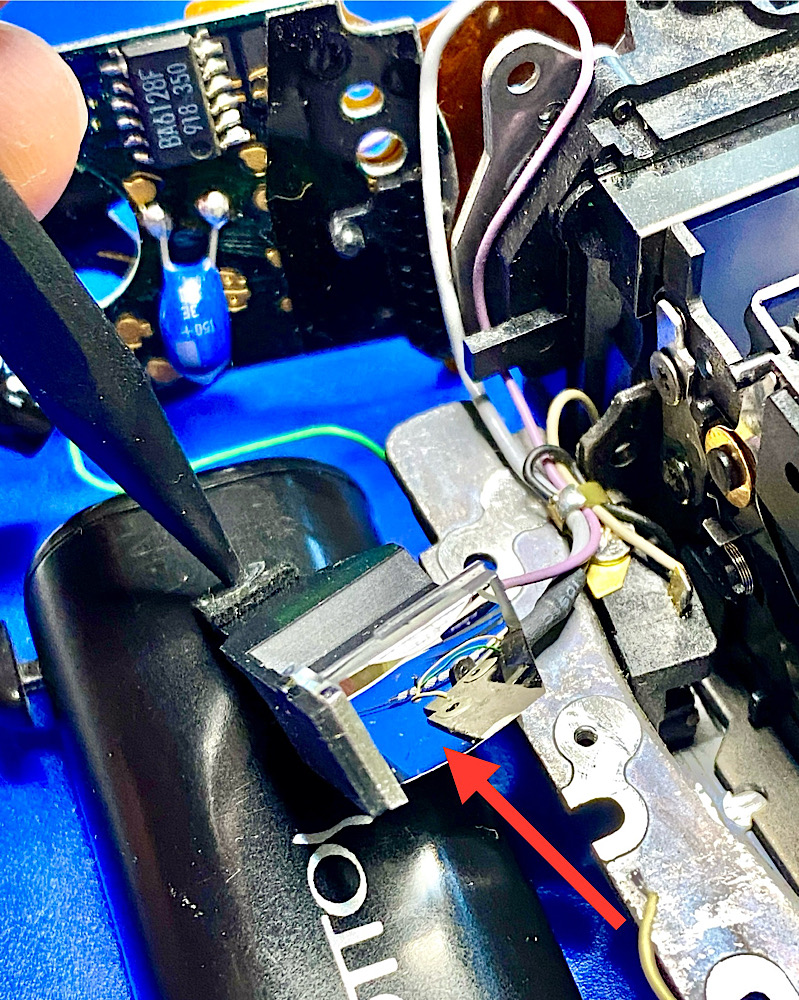

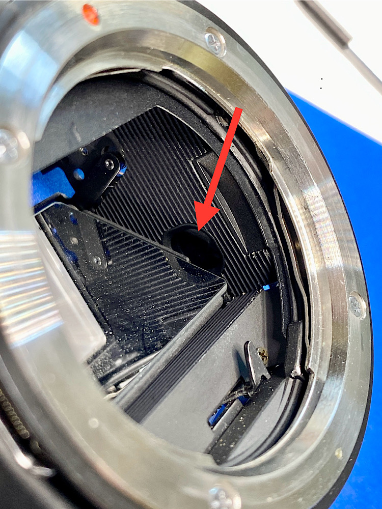

TTL flash measuring

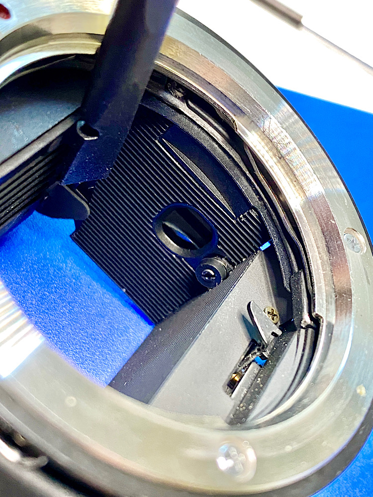

The photodiode responsible for flash measuring is covered by a slider in the mirror box:
If the mirror goes up when it is triggered, the slider releases the photodiode:

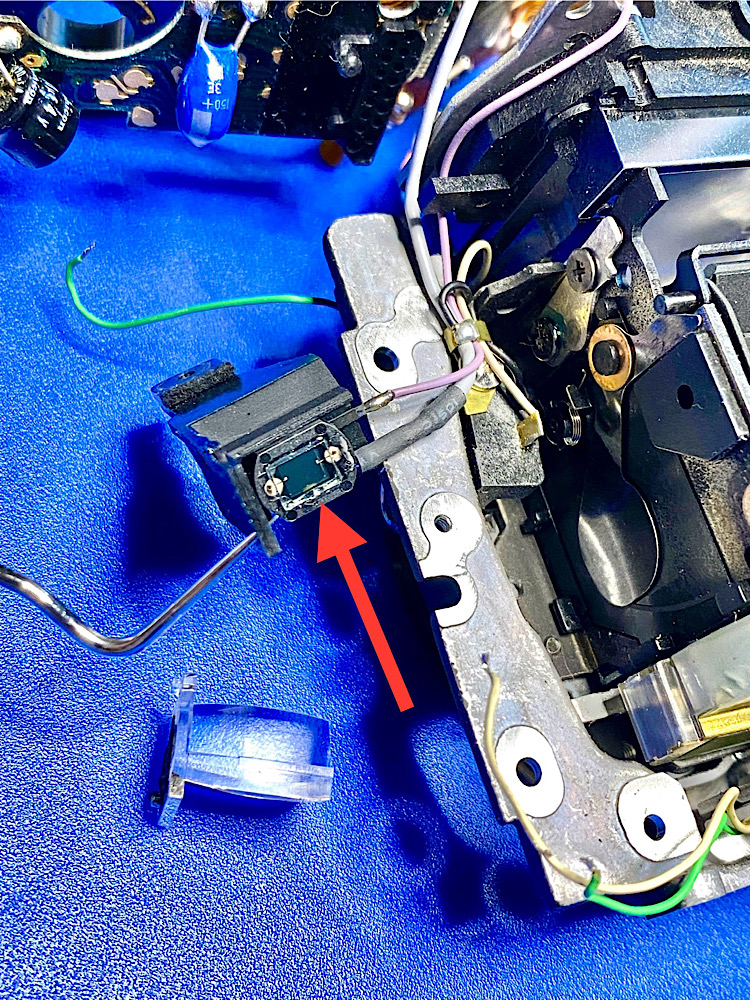

I took a closer look at the photodiode in the mirror box. It is held by a tab:
After removing the tab, the photodiode can be pulled out with a prism in front of it. The prism directs the reflected light onto the diode:
The prism is mirrored at its lower end:
After the adhesive has been released, the prism can be removed and the photodiode is exposed:

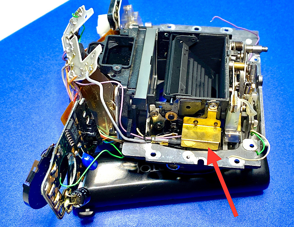

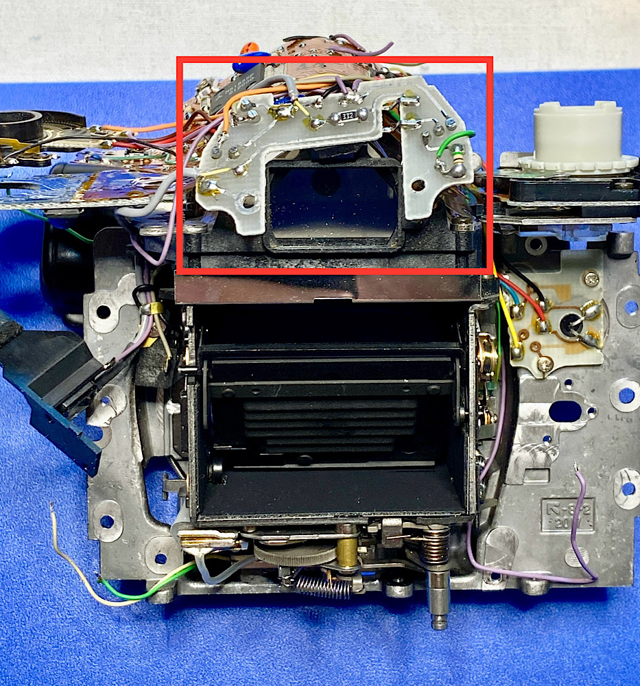

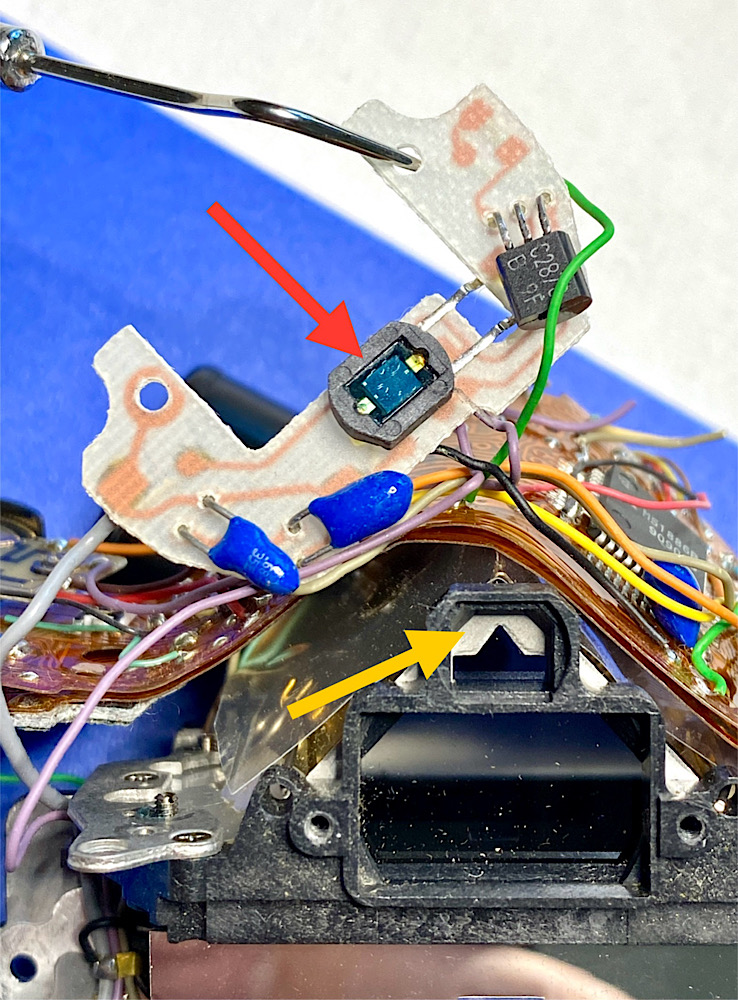

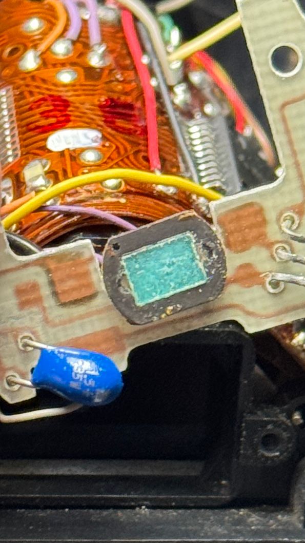

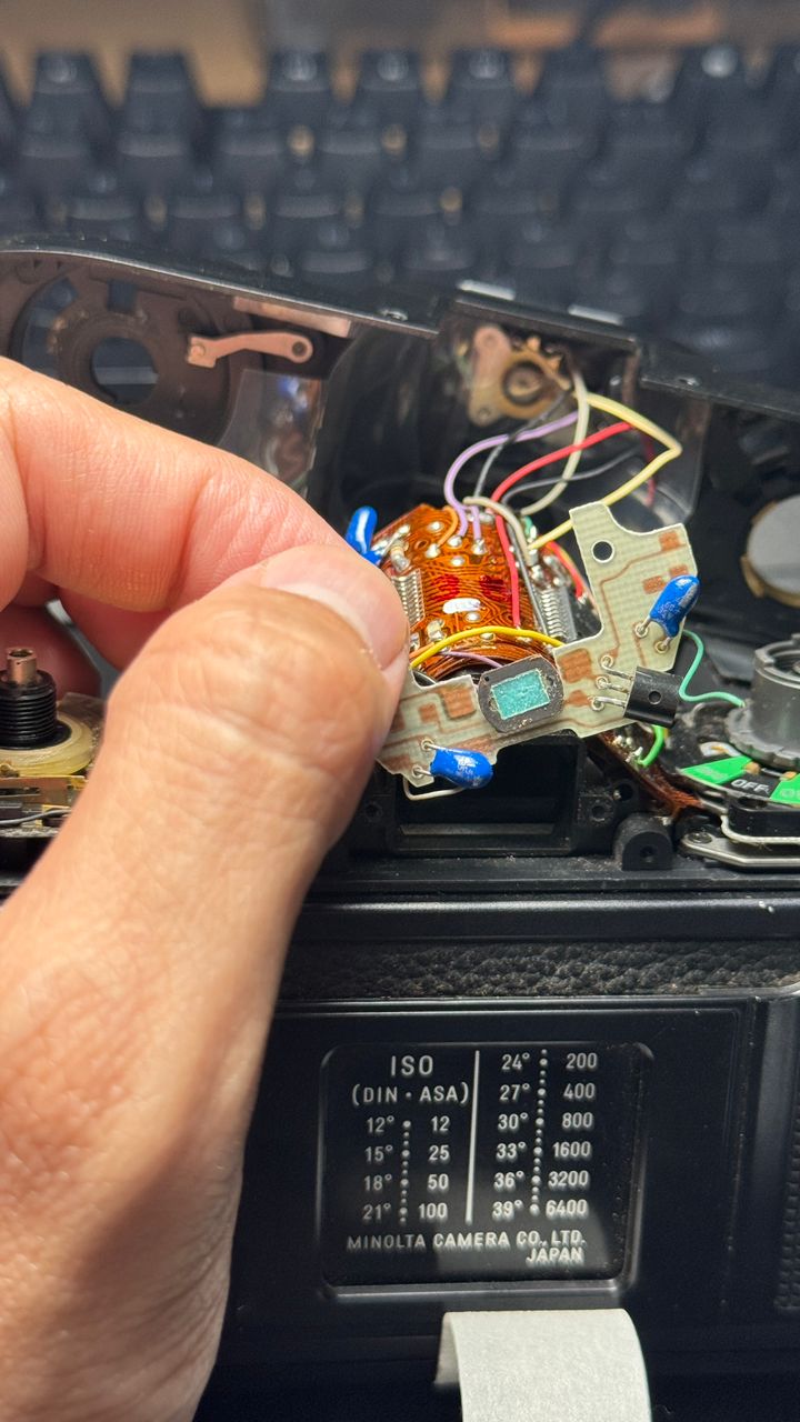

Measuring of available light

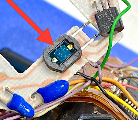

And here is the position of the photodiode for available light measurement:
After loosening the associated circuit board, the photodiode becomes visible (red arrow). The yellow arrow points to its housing above the eyepiece:
On the board you can see also two blue tantalum capacitors (C2, C3 on the circuit diagram) and a transistor (Q2).
According to the service manual, C2 is used for circuit stabilization, C3 works as a memory capacitor and Q2 switches the photodiode.

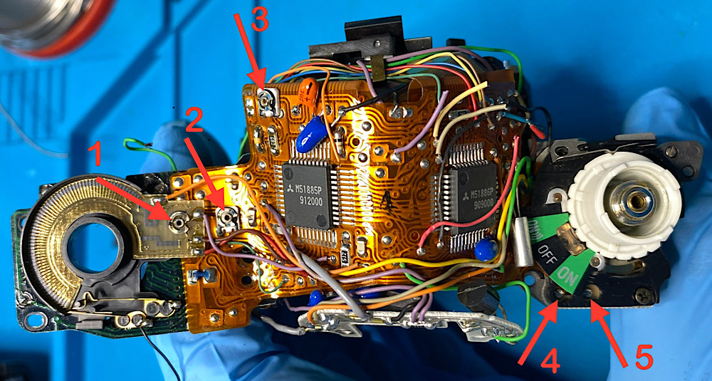

The already mentioned article about the X-700 in the SPT Journal
shows the places on the board where settings can be made. I've marked a few here as examples:
  1. Strobe level (shut off point flash unit)
  2. EV
  3. ASA inclination
  4. LED readouts
  5. Manual speeds
1, 2 and 3 are small adjustable resistors that can be used to change voltage conditions in the circuit. The settings are therefore made analog and can be adjusted with the tip of a screwdriver.
4 and 5 are adjusting screws whose connection to the circuit I don't recognize.
I know from experience that fine adjustments with adjustable resistors are not easy to do, as even the slightest turn with the screwdriver changes the values. Given the size of the potentiometers here, I imagine that setting them would be even more difficult. This will also require measuring devices that are not available.
Therefore, here it is best to follow what Thomas Tomosy says:
Most electronic circuitry is provided with some adjustment capability, usually in the form of small adjustable resistors (trim-pots, or pots, for short). It is a grave mistake to disturb the factory settings impulsively. In general, you should not disturb anything unless you’re absolutely convinced that that is where the problem lies.
Thomas Tomosy, Camera Maintenance & Repair, Book 1, Buffalo/NY: Amherst Media, 1999, Kindle edition, position 835.

TTL flash measuring
This information makes little sense on its own. As I conclude this series, I will attempt to provide an overview of the X-700's circuitry, greatly simplified.

Hi Sir. Good evening. I felt very appreciate on your great work and contribution. I found that my X700 have a broken photodiode at VF area.
I try to identify the diode model and buy online but i not sure what is the correct model .
which i found this online and i hope you can help me identify if you do have the info on hands.
Hope to hear from you soon.
I Took PIC of my X700, I fount the part is not same as yours shown in this post, i believe due to different generation or years of production.
I found several Photodiode online, but there is many models/specs/size. I read over the X700 service manual there is not specs and model info found which troubling me.
Or all the photodiode is same as long i get the same size will do? kindly advice.

Welcome to Photrio, @ColinEOS30!
I'm afraid not. They're all different, and even if the physical dimensions are the same, there can be big differences. I would not have expected a clear specification to be present in the X700 service manual; no surprise there.
https://www.digikey.my/en/products/...jHPR3b-pIFDZFucB-vQggXG9NQ80NXDNqCYIKS-Ia7VoP
This may be a suitable type. The spectral sensitivity seems appropriate, although there's no chart included and it's of course unknown what the spectral sensitivity is of the original sensor used by Minolta. As you may have noticed, the datasheet of the sensor you found lists two types (VTB8440BH and VTB8441BH), which have very different performance (the latter is far more sensitive). This illustrates what I said above about physical dimensions and performance.
I'm sorry to say that there's probably no reliable way to determine which photodiode could be substituted here, unless you get hold of a product type and accompanying datasheet of the original part used by Minolta.

Looking at some of the close up pictures the amount of dust in and around the lens mount and mirror box it is a wonder it works at all
It looks to me like that camera has been subject to conditions of very high humidity for a long time. I expect it'll be affected by this in several ways. It's a bit of a lost cause if you ask me, but I'm not a camera repairman.
