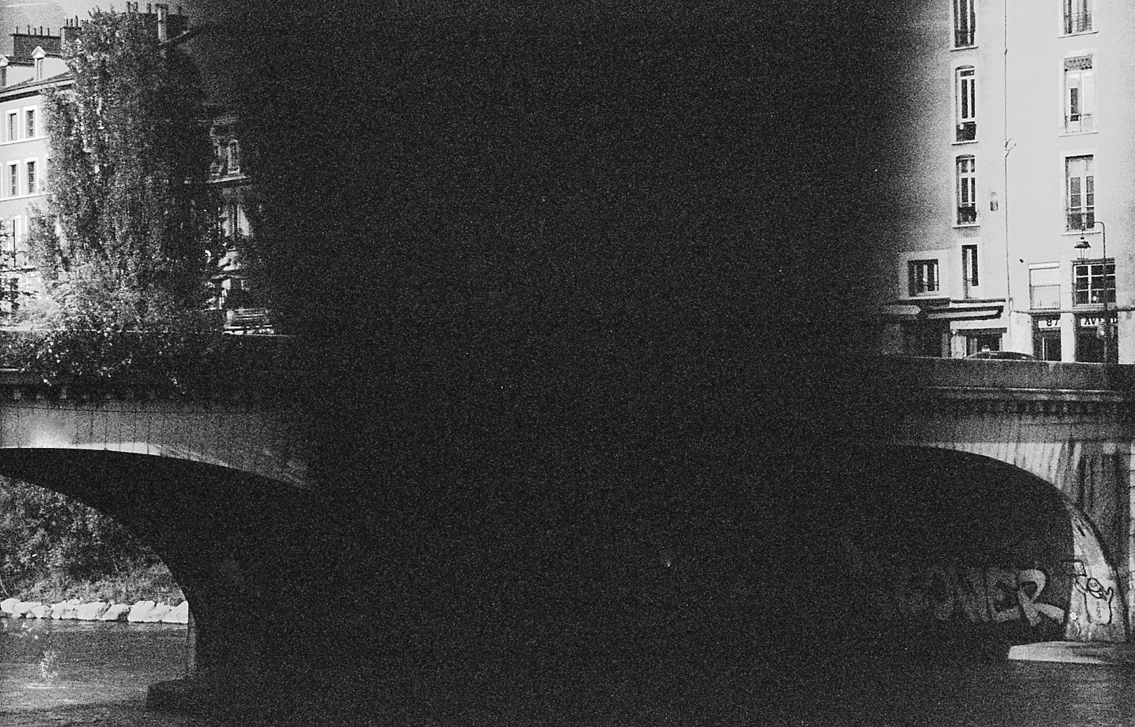

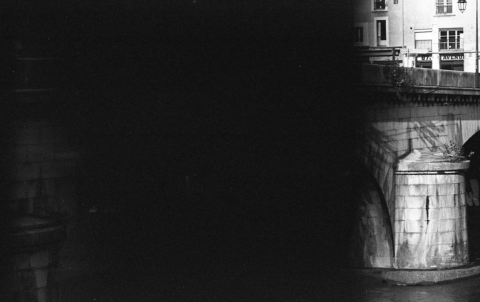

I was using HP5, at box speed. Near the end of the roll, four of the frames show a real problem during the exposure. Before those four and after, the negatives are fine. The lens used for these is the MD Macro Rokkor X 100mm. Please see photos for the problem.
The previous image to these four and the one after them were fine. The images are posted in the sequence in which they were taken.
I'm guessing it was some sort of shutter curtain problem, but can't fathom what, given that the unexposed part is sometimes in the centre of the photo. Any ideas? It also seems strange that this cropped up then sorted itself out - at least for the rest of the roll.
Sorry, these are enormous!

That looks more like a processing problem rather than a shutter problem.
Could you please elaborate on why you think it is a processing problem? Myself, I don't think it is but would like to hear what is behind your statement, as I'm not ruling anything out. Thank you.
Just a hunch, as most shutter drag issues I have seen tend to be just on one end of the frame or another, not in the middle of the frame, because a shutter doesn't tend to trip, decelerate and then get back to speed in that short of a distance.
Looks more like a developer starvation flow pattern to me, but I could be wrong.

Can we see the negatives?
Is the writing at the edge of the film - negative numbers et al - also affected?

There were two reels in the tank, both HP5, from two different cameras, and only the Minolta exposed film showed this problem. The film exposed on the other camera, a Leica MP is just absolutely fine.
Hence, going backwards from your questions, without further ado my replies.
My "general level of experience" is extensive, over 25 years of film related experience incuding doing ALL my own darkrrom developing, printing and so on, as well as teaching printing workshops.
No, there was no physical indication of a camera problem.
It was processed by me in a two reel tank in XTol 1:1 along with a second roll of HP5 exposed on a totally different camera which was absolutely beautiful and all images are fine.
The film was exposed by focusing, framing, taking into account the diaphragm and shutter speed and voilĂ ! The shutter was pressed.
The camera has been in my possesion for 10 years after a friend kindly gave me her deceased father's camera equimpent, knowing I would use it. Which I have done and up til now never had a problem, but which also indicates that there have been two users of this camera body.
Anything else I may have missed?
@matt, thank you for your question. Difficult to scan the nagatives including the rebate, but looking at them, no, the numbers in the borders are quite clear and not affected.
There were two reels in the tank, ..(snip)
No that suffices...
I would speculate that your trailing shutter curtain is sticking. I would suggest you place the camera on "B" and examine the curtain track carefully for debris. I would also suggest you check the mirror bumper foam as a potential source of this debris.

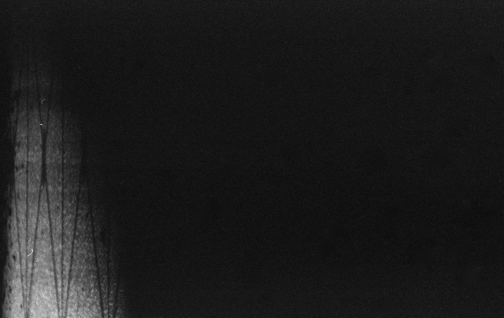

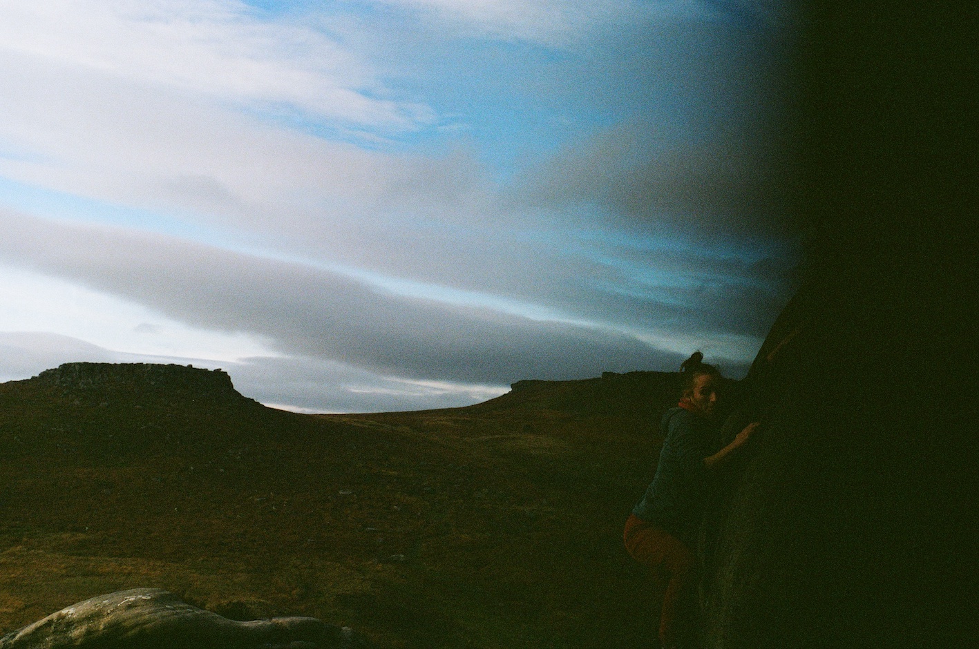

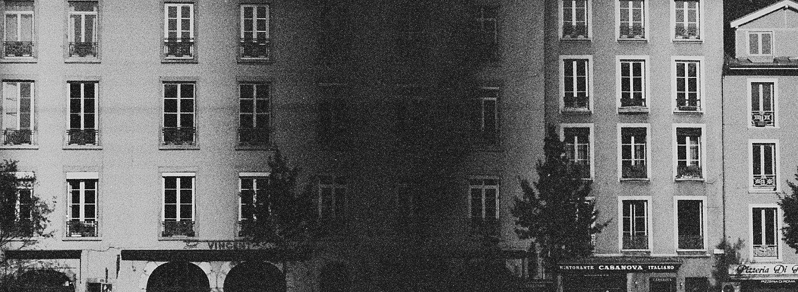

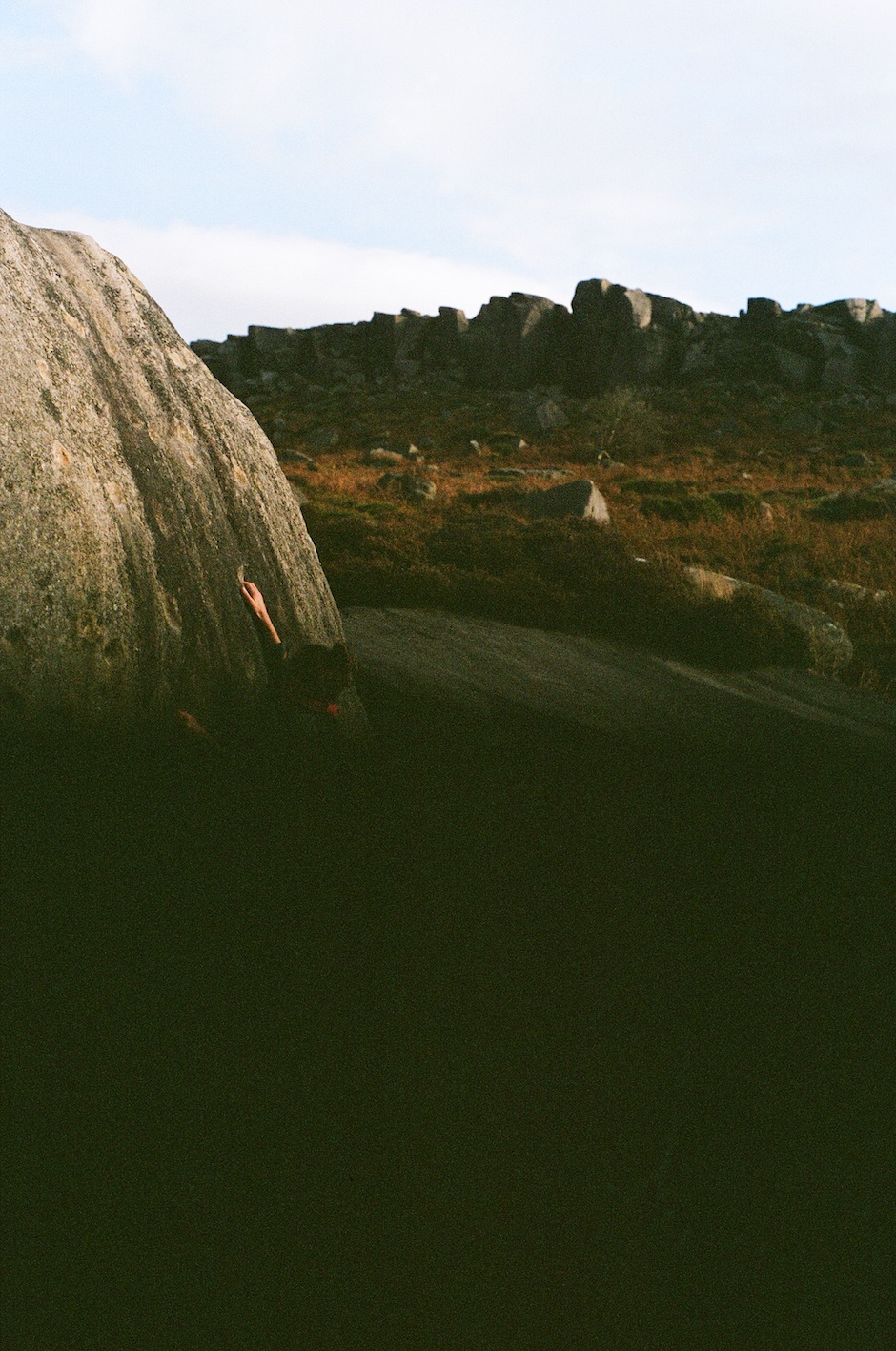

Hiya! I'm currently experiencing a very similar issue with my X300, I've uploaded a few offenders. Just wondering if you ever got to the bottom of what the issue was? This is my first roll on this camera (in my fact my first roll full stop) so I'm not really able to comment on whether the camera feels any different to usual. Thanks in advance!

Oooooh. Debris from old foam... That rings several bells for me. I have experienced this on several rolls (I don't process everything right away so a problem can go unnoticed for a while) in a couple Minoltas that I have found to definitely be needing new seals and bumpers.

More info needed: are frames shown successive frames on film, or completely random, or is the entire roll like this? Really need to see a scan of actual negative including perforations, just like @foc had shown back in his post from 2019
Stupidly I didn't hang onto the film - only 6 of 36 frames are ruined like this, they seem to come in pairs
