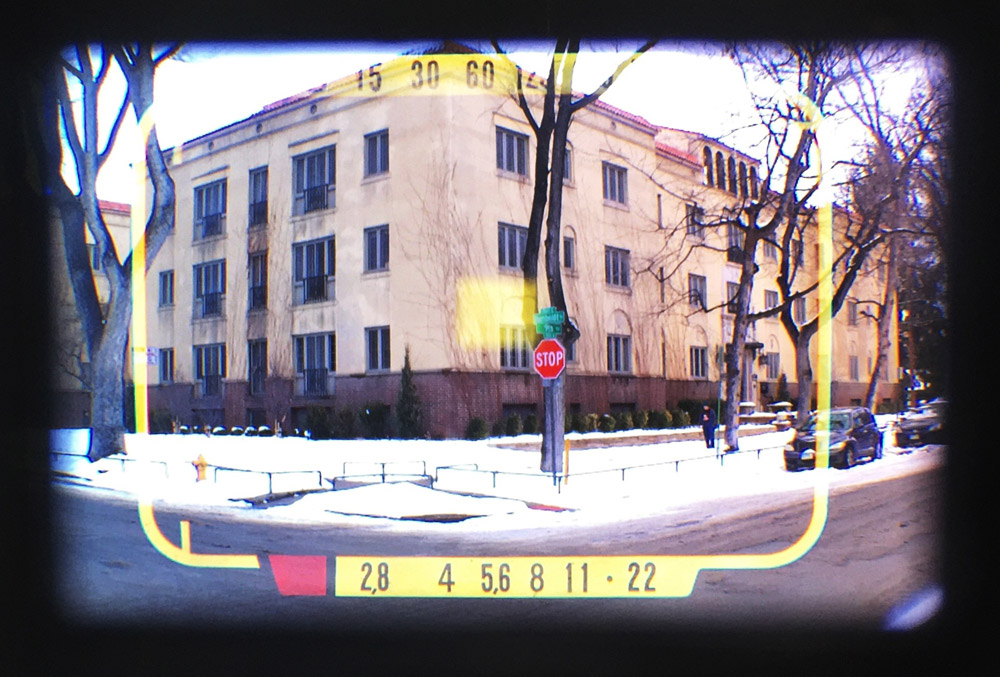

There may have been pro cameras that displayed shooting info in the viewfinder earlier, but the comparison is like apples and oranges...
A Nikon F2 photomic sold new for about $650 in the early 70s, while the SRT101 cost about $180 new.
As far as consumer cameras go I still believe this little Minolta was in the lead (but I just saw in another reply that Konica may have done it earlier).
I know that once one manufacturer came out with something awesome, the others rushed to copy it.
Butkus does have a manual for both - T1 and T2. T1 doesn't appear to have full readout (it only seems to have the aperture scale), while T2 already has aperture + shutter indicator.
I have T, T2, which is not labeled as T2, T3 and T4, the T, T2. T3 show the aperture scale on the right, on the bottom is the shutter speed readout. The T4 does not have a shutter speed readout. Not sure about the later electronic versions or the TC. The A, A3 do not have a shutter speed readout.

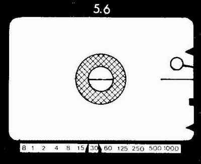

I'm curious if this 1973 camera was the first one or if there were earlier examples, SLR or otherwise.
This example only has the shutter speed in the display, and an indication of under or over exposure, but no indication of lens aperture set on the lens
The Canon E F that came out also in 1973 had both the shutter speed in use and the lens aperture set in the viewfinder.
The Canon E F that came out also in 1973 had both the shutter speed in use and the lens aperture in the viewfinder.
Yes I have 2 EF's but it only display automatically set aperture or recommended aperture. Not manually set aperture.
