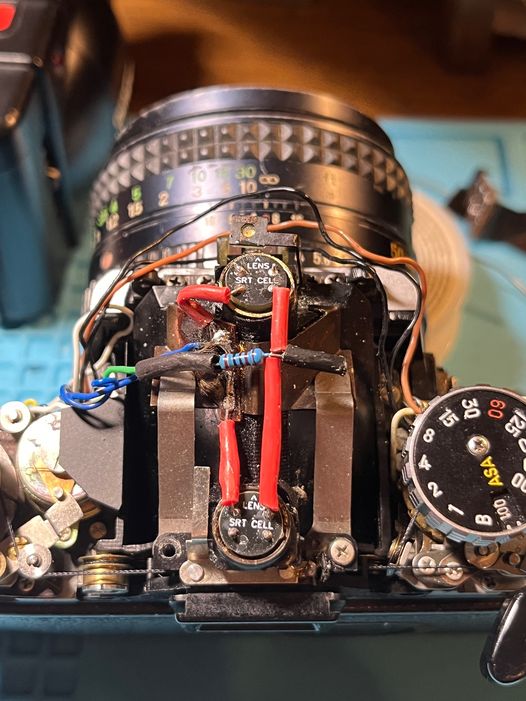

I ended up spending 2 years trying figure something out and arrived at what may be the closest we'll get. I'm making new cells. An Initial test in my SRT shows accuracy from 5-15EV. This is inside the original 3-17EV, but I have to look at it as a win. The only time you'll be off is if you meter in the sand or snow and manually compensate. Those scenes are about 17, but since the meter caps out at 15, you'd underexpose if you meter the snow and compensate. But under normal conditions, it's pretty rare to see over 15 in the real world. I generally set my meter for sunny scenes to the blue sky anyway (or my open palm filling the frame in the same lighting conditions, then open +1 from there), so if you meter for a blue sky that would make snow/sand expose correctly.
The cells will be about $22 for the pair, shipped in the US, but I'll be happy to send you a pair for cost, which is $15 shipped next time I put a few together. I'll attach a rough photo, but ignore the extra resistor, though you do have to do a slight rewiring--and you can't replace only one, unfortunately. I don't have a photo of the final build as I have PTSD thinking about taking the lid off again now that it's working. But I'll get to that and create a guide - eventually.
Let me sign off by asking: are you sure the cells and the prism wedges they're attached to are clear and secure? Often, the glue yellows and they come loose. But you may already know that.
