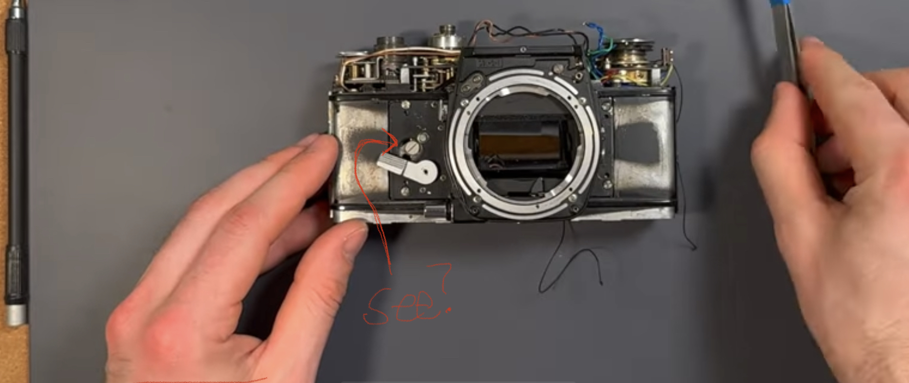

I have what I believe is a mostly good SRT. I decided to start learning repair by restoring/fixing this camera in full. There’s a video that I’ve been using to handhold me, it’s amazing and available here (3 parts):
Anyway, I haven’t run into anything I believe is broken. I currently just mounted the focus screen, but stopped just in case I messed something up and need to undo the mirror box again.
My main concern is the self timer. I’m being pretty cautious to make sure everything is working as illustrated in the video.

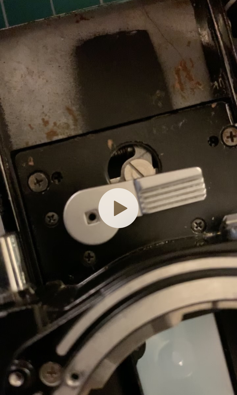

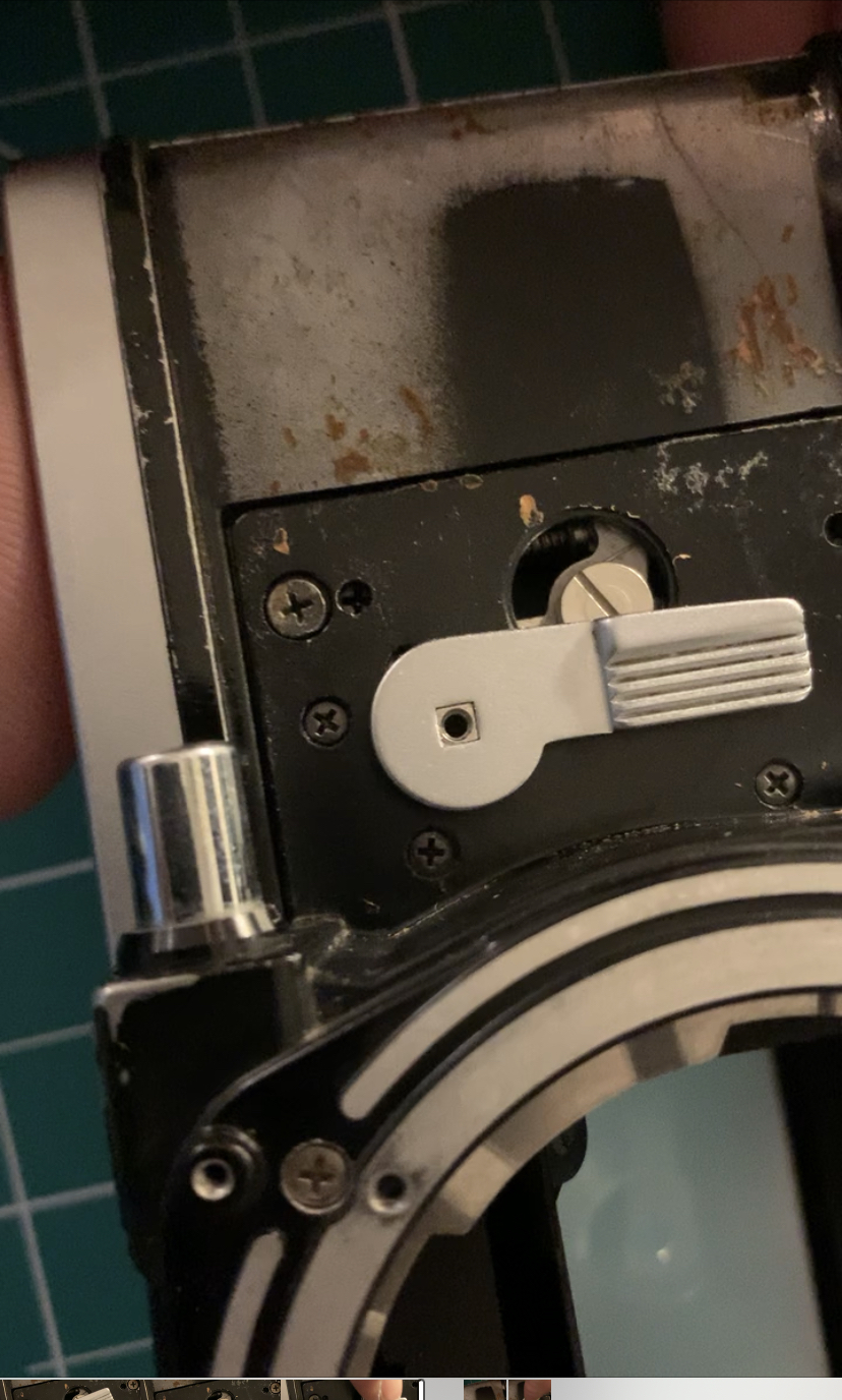

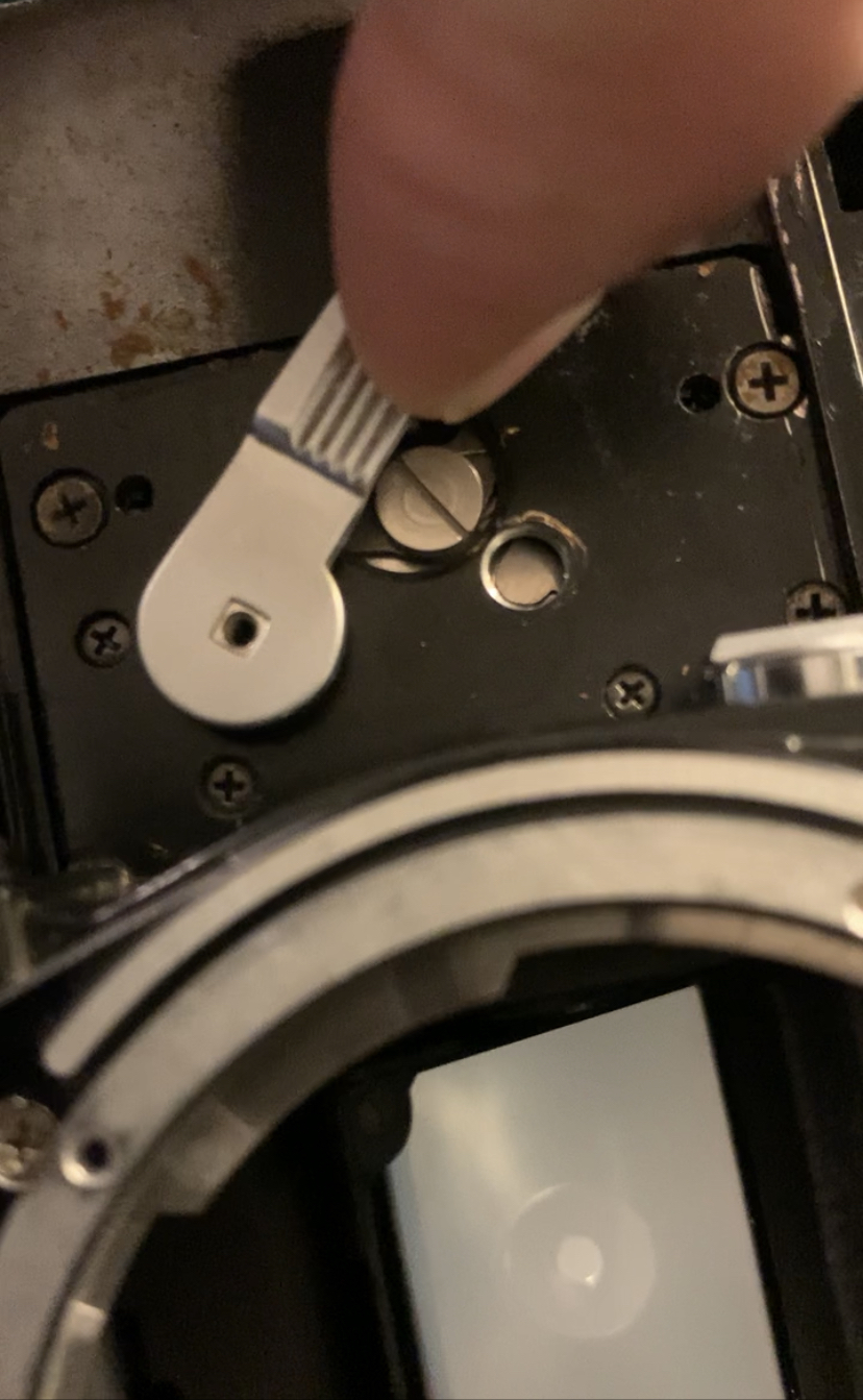

So when I mounted the face plate and mirror box, I had to engage the self timer in order to get it to sit flush. As illustrated in the video. Then, once the faceplate/mirror box is mounted, he illustrates the self timer working one more time in full. I tried the same thing and mine just got stuck at 45* and would not budge back to normal position. That’s when I noticed in the video, the metal trigger you lift to engage the timer and make the plate sit flush is actually reset in his video so it isn’t slightly lifted anymore. Mine is still set higher and when I try to push the self timer to start, if I start it past a certain point it just gets stuck at 45* and I have to re-engage it by unscrewing the faceplate again.

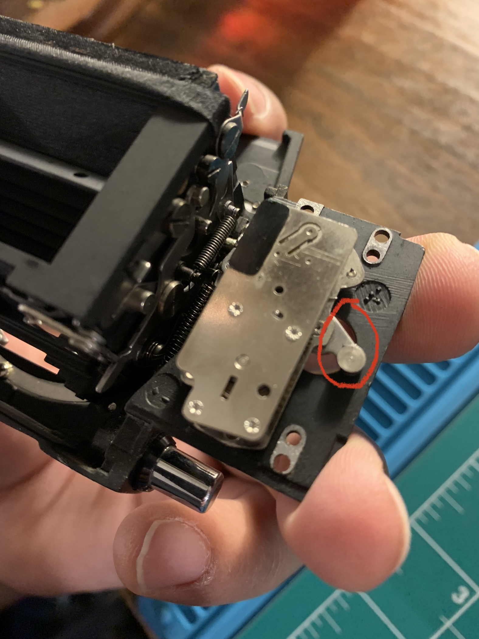

Attached are 3 photos of my camera. I also took a snap of the tutorial video showing his camera’s self timer and the trigger position I’m speaking about (and how his is different than mine and works).

It's been awhile, but I suspect that the self-timer mechanism isn't properly engaging with the shutter release. If it were my camera, I'd probably remove mirror box, study how self-timer and shutter release are designed to interact, and try again. It's possible that simply loosening the mirror box screws will allow the parts to fall into place more easily.
I agree, it sounds like how the self timer attaches to the shutter release plunger is either above or below it's right position.
Might take some playing around with position as you remount the mirror box to get it right.

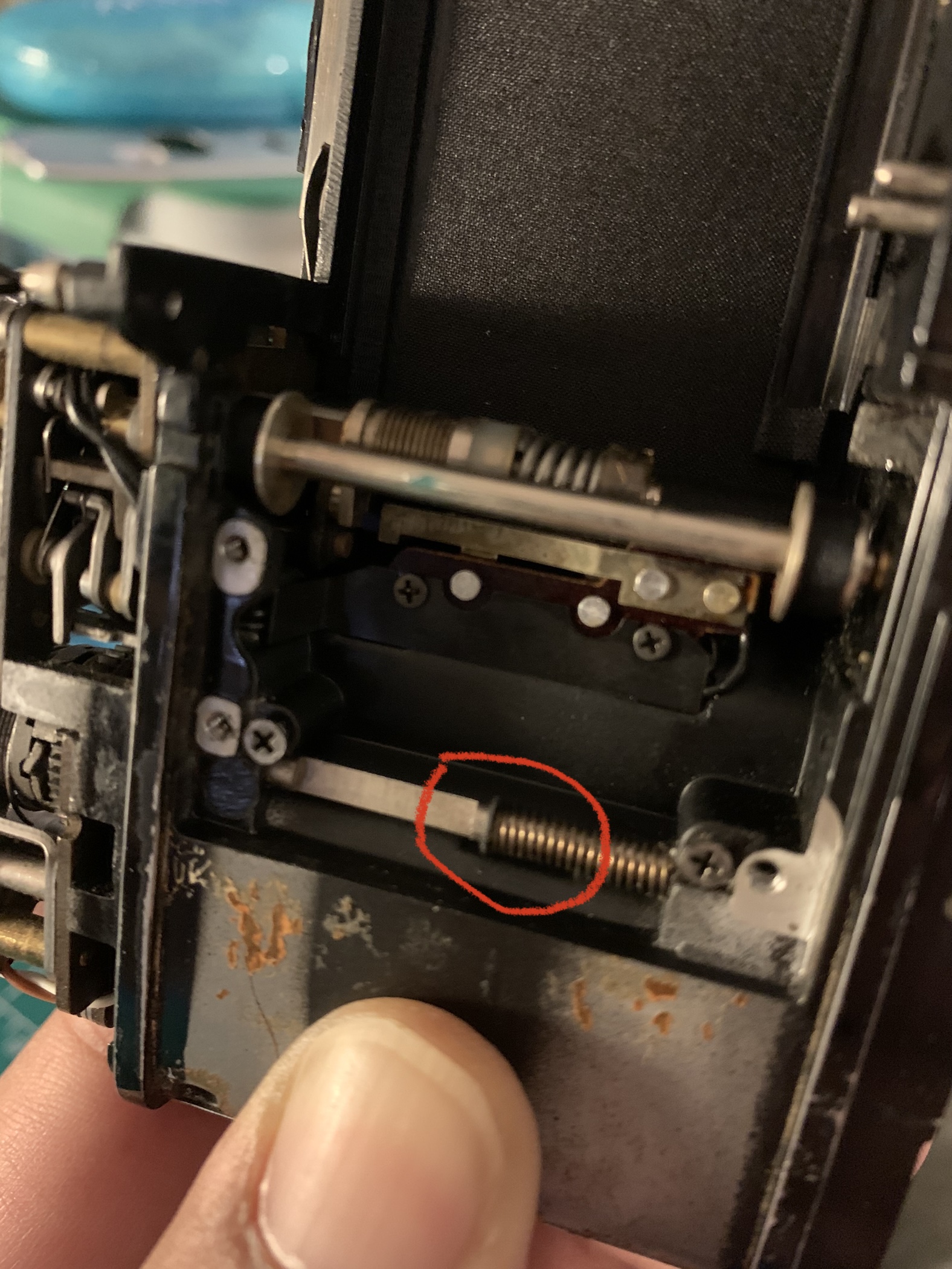

Thanks for the reply!
So I did some tinkering and i believe I know what the issue is but dont know how to fix it.
The shutter shaft is pictured below and at the spot circled where the self timer rests.
The circled disc on the self timer is what rests on the shaft where I circled.
When I engage it I lift it up so it can rest on the shaft and allow me to install the base plate and mirror box assembly flush with the camera body.
So what I’ve concluded is that when it’s engaged, the disc arm on the self timer is supposed to push down on the shaft as it unwinds, allowing for picture to then snap.
But the shaft isn’t moving from that position at all. It seems to be all the way down too. I can see the bottom of it pushing down on a metal tab on the camera frame. So not exactly sure what’s going on or if there is some mechanism preventing it from doing what it has to due to the fact I’ve disassembled it and am putting it back together. But then how did the guy get it to work only partially assembled???
Going to keep tinkering but would love any help to get the process moving. Thank you!

I think you're on the right track, but without it in my hands, I'm pretty much unable to help.
Just keep messing around with it and tracing levers; you'll get it eventually.
One thing I have learned, when you get tired, put it down and come back to it later. It will wait.
