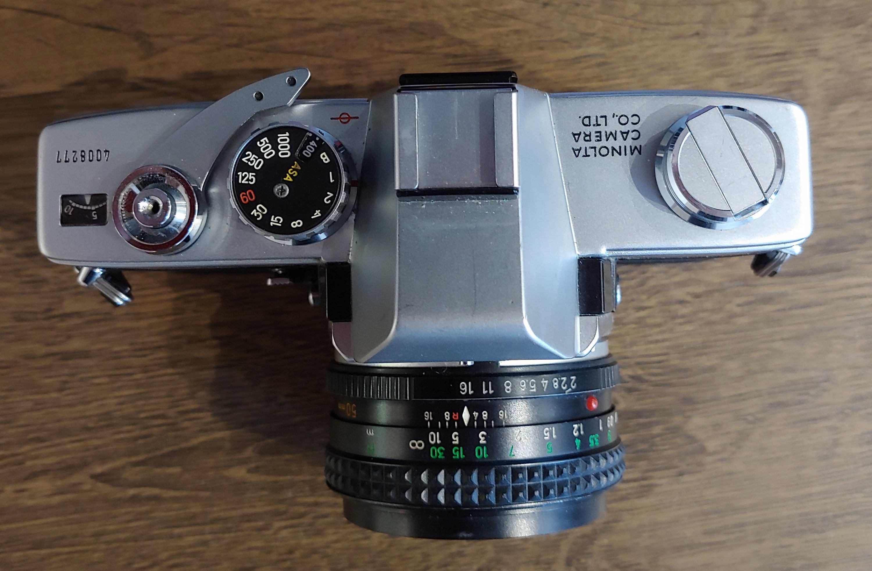

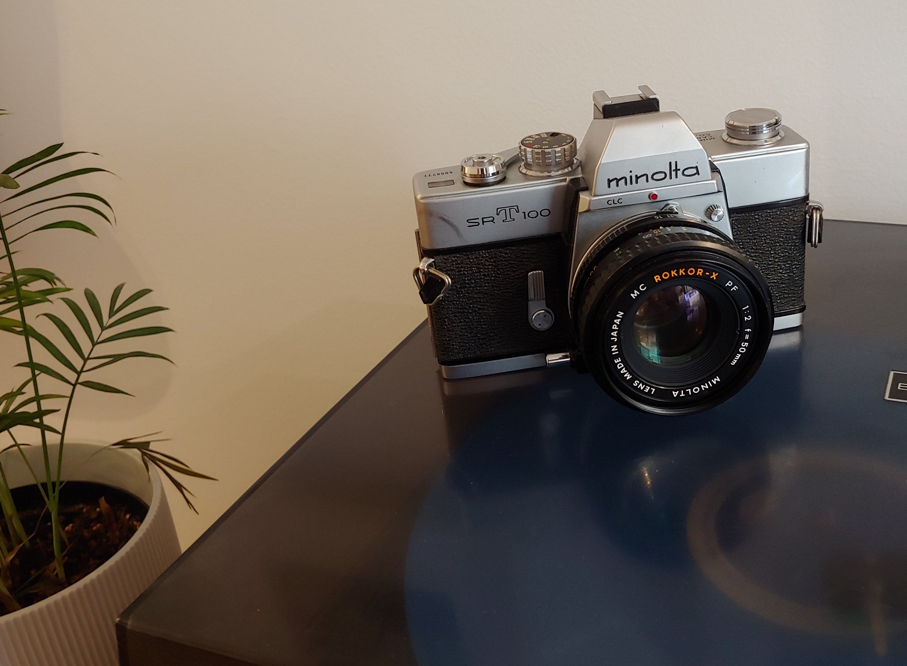

I picked up this camera and am a bit confused as to the model number. It is the srt-100 but has a top shutter speed of 1/1000s which is like the srt-200 or srt-100x. It also has ASA range of 6-6400, and the self timer.
Anyone know of this camera having these features?

http://www.subclub.org/minman/srt100.htm

Your 100 was the last model made in 1975, it was an upgraded basic 100 with extended ASA range and the noted top speed of 1/1000.
Ok thanks, all. I suspected it must have been an updated version of the original 100.
