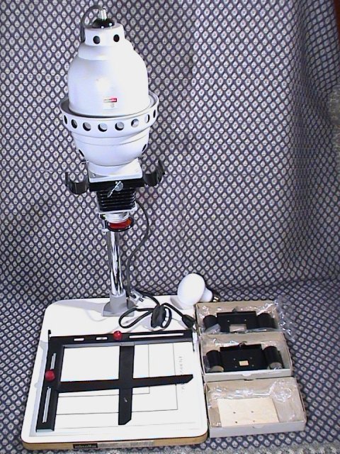

Well, I didnt buy the Minolta enlarger since it only came with the 16mm neg holder. Here is a an image:
Thanks for the replies!
Is it the actual enlarger or just a image? The enlarger as shown looks like it has the 35mm carrier.
Yes, I know, but the seller said he only had the 16mm holder.
