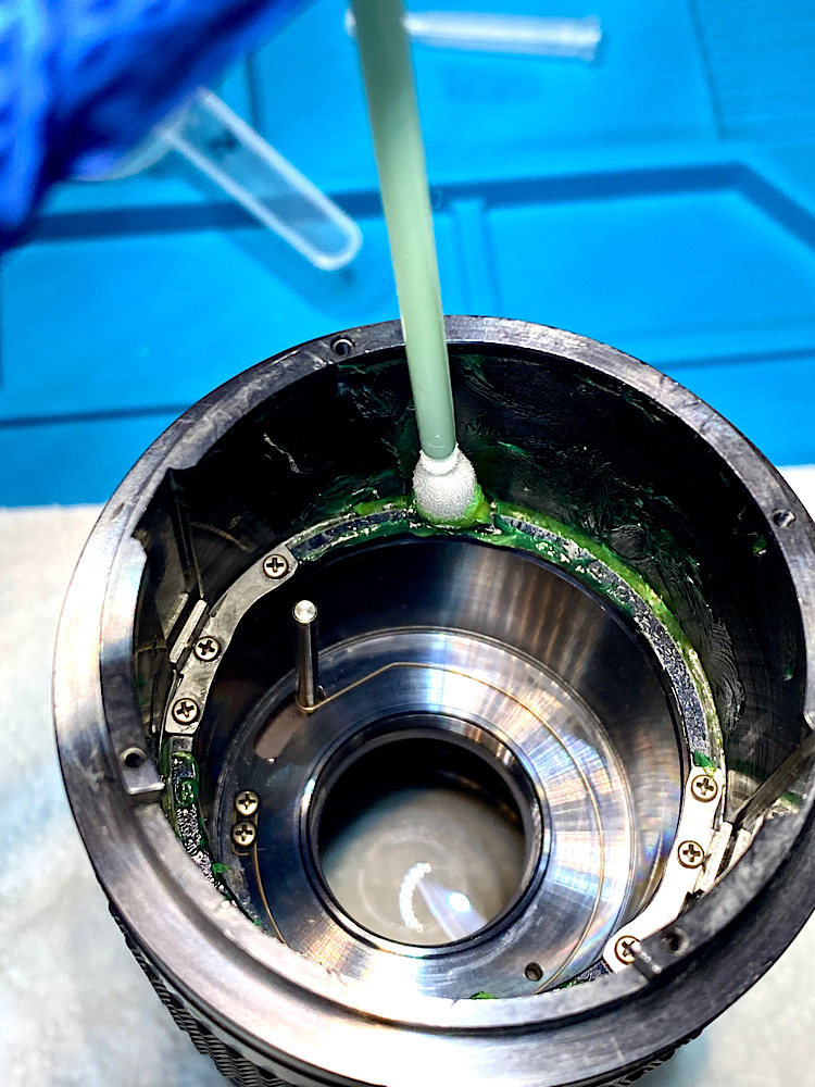

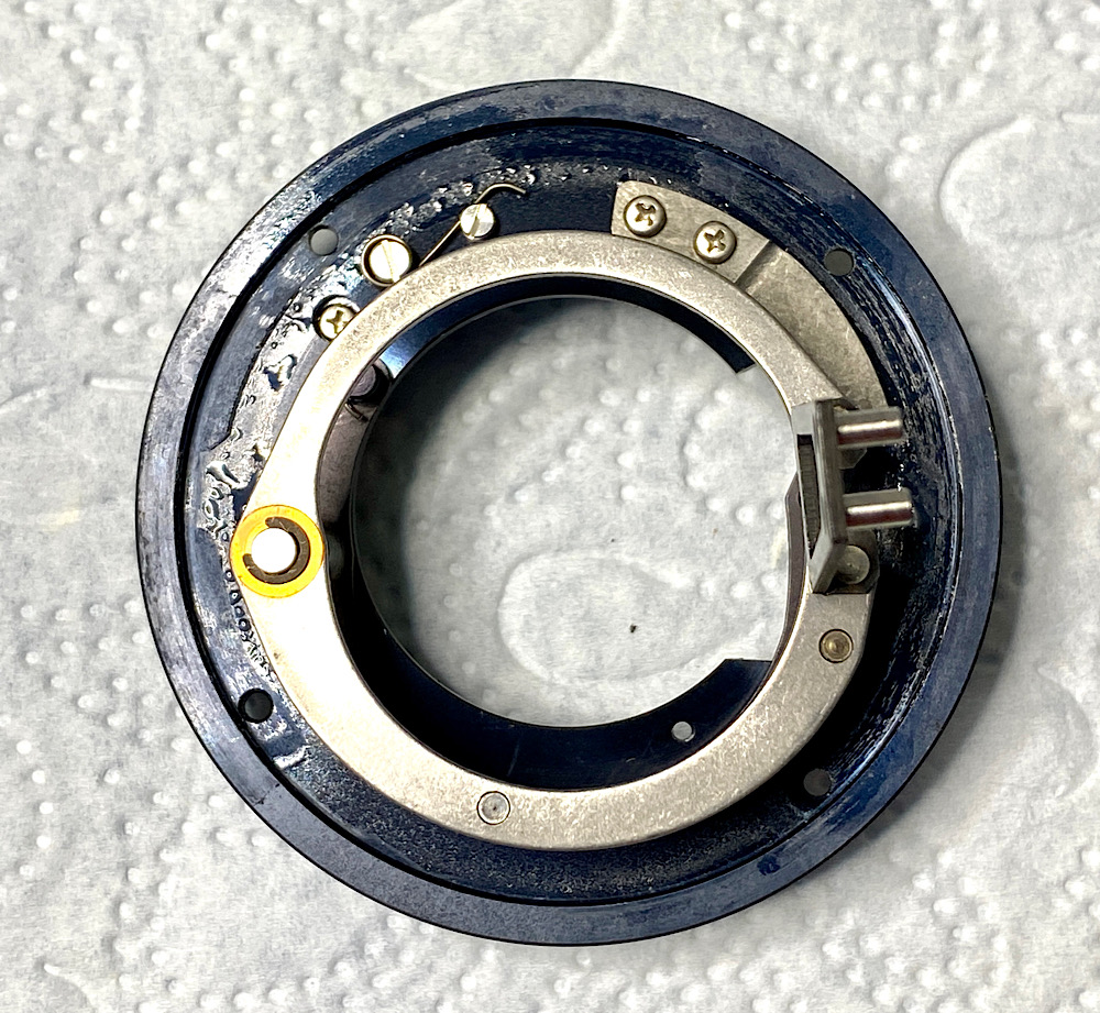

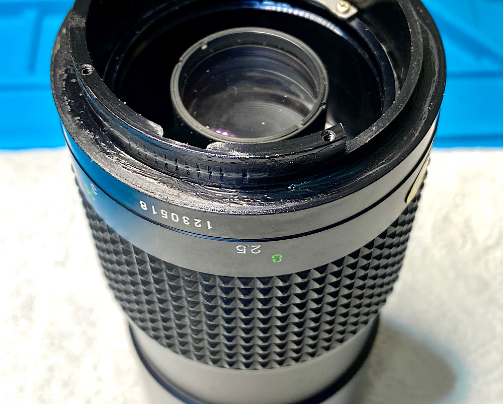

Heavy oil pollution can be seen.

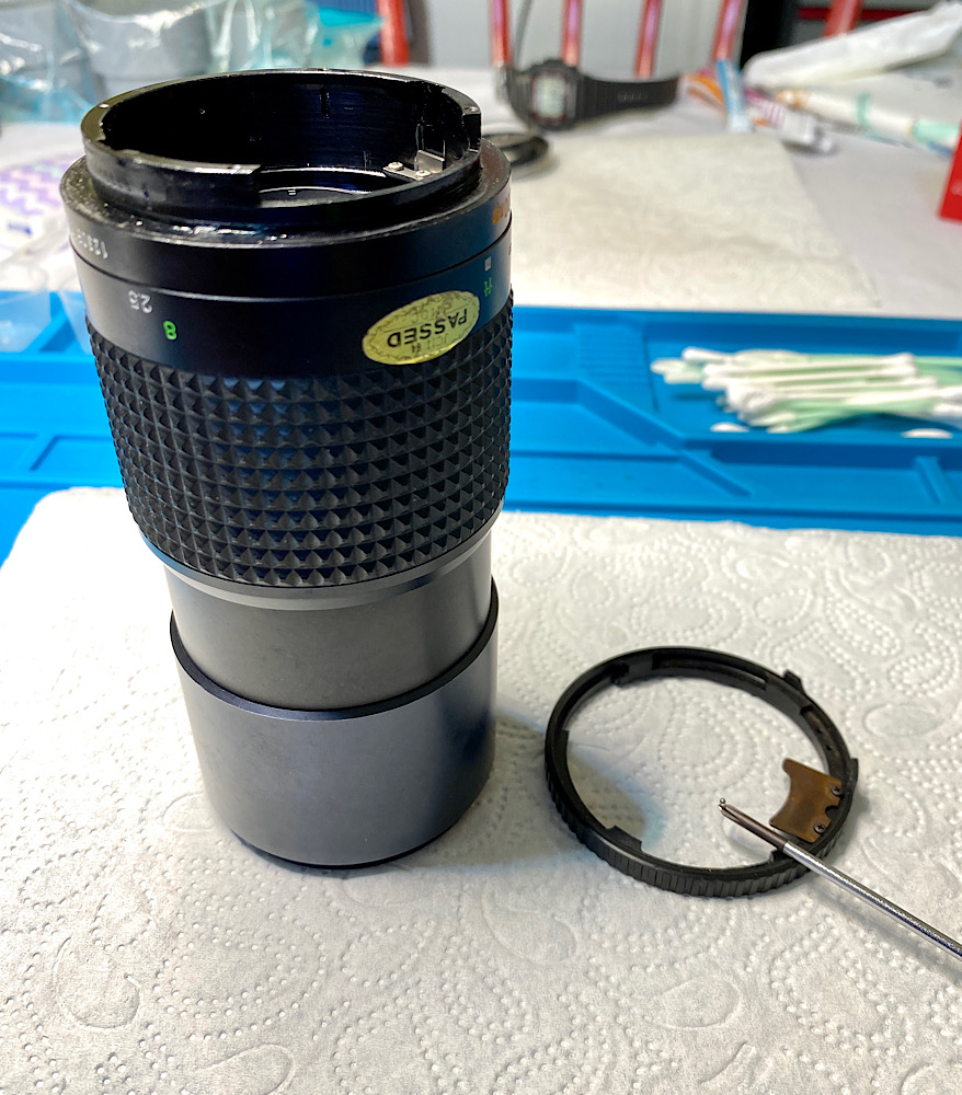

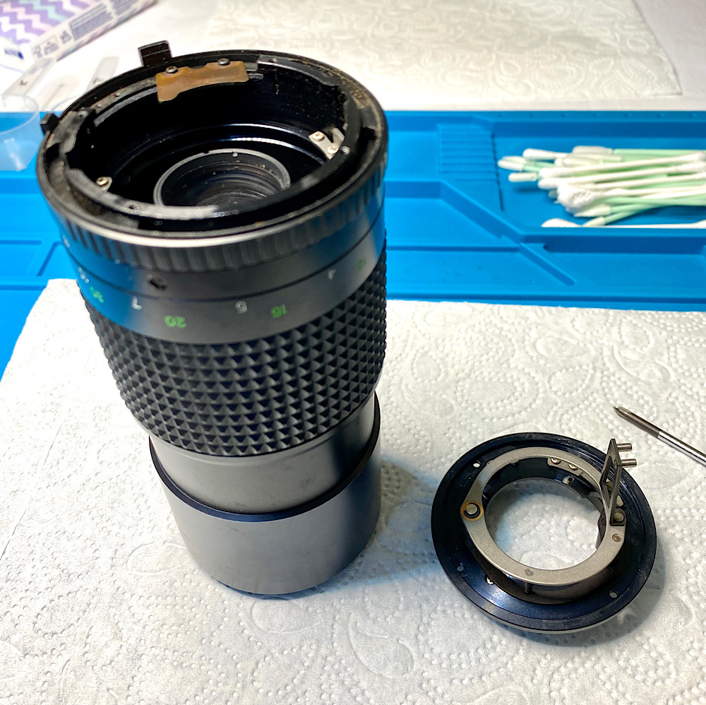

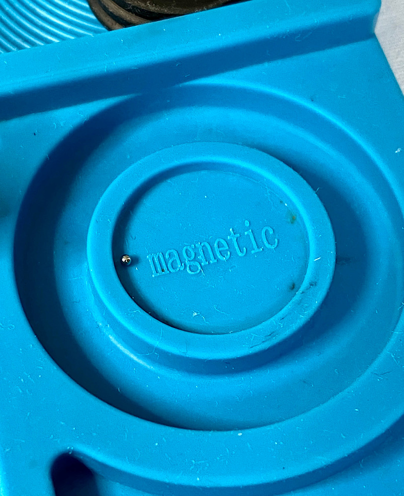

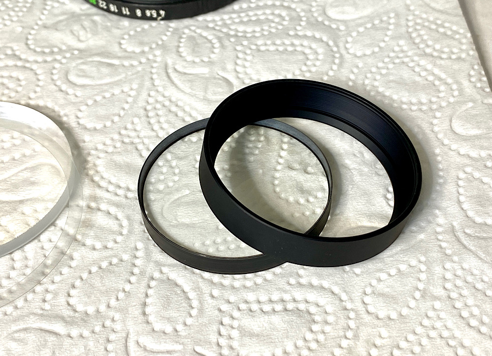

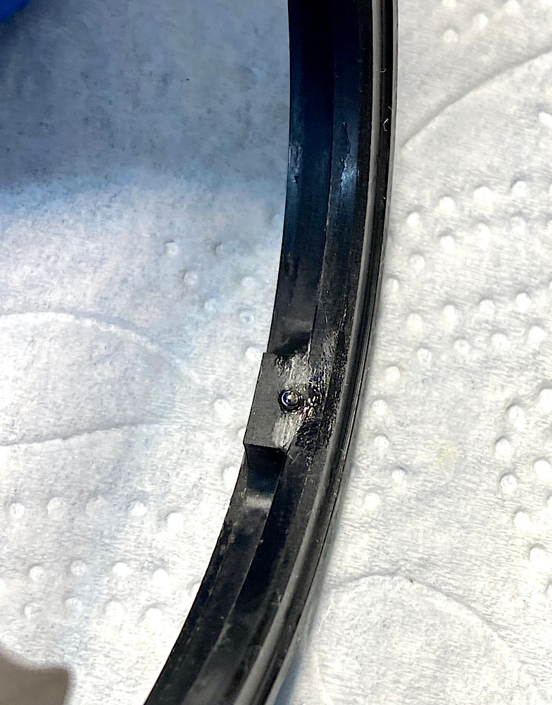

Removing the aperture ring, the locking ball is secured, oil pollution again to be seen under the ring.

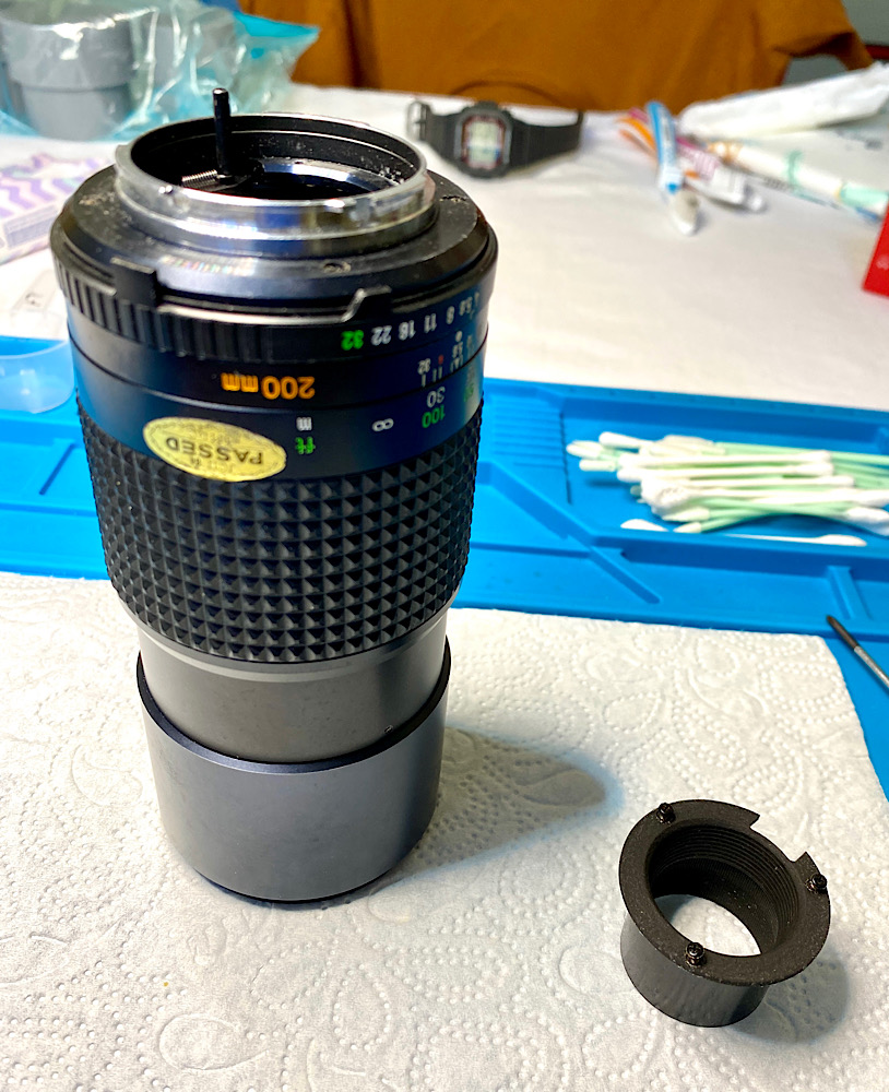

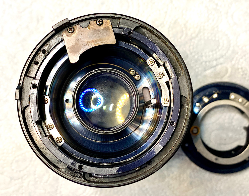

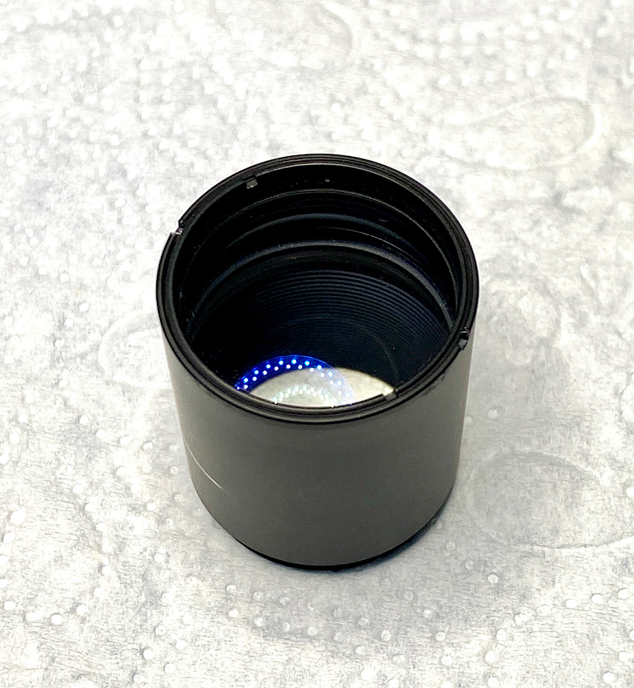

Removing the rear optical assembly.

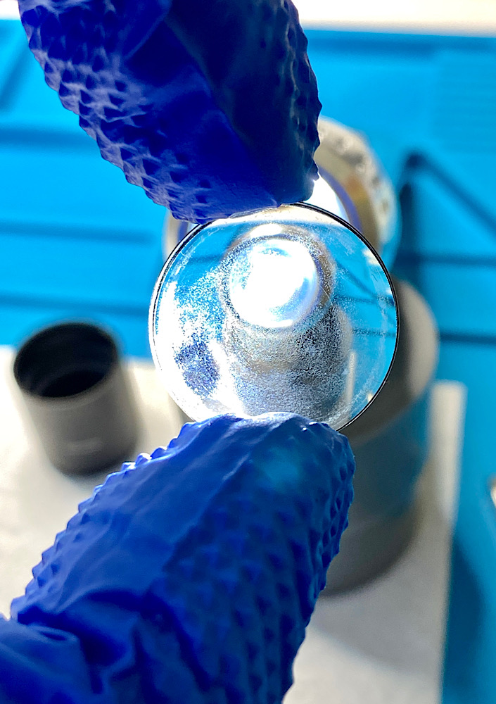

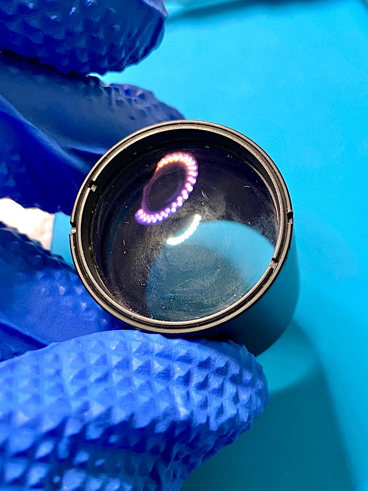

The contamination of the lens can be clearly seen even without LED illumination.

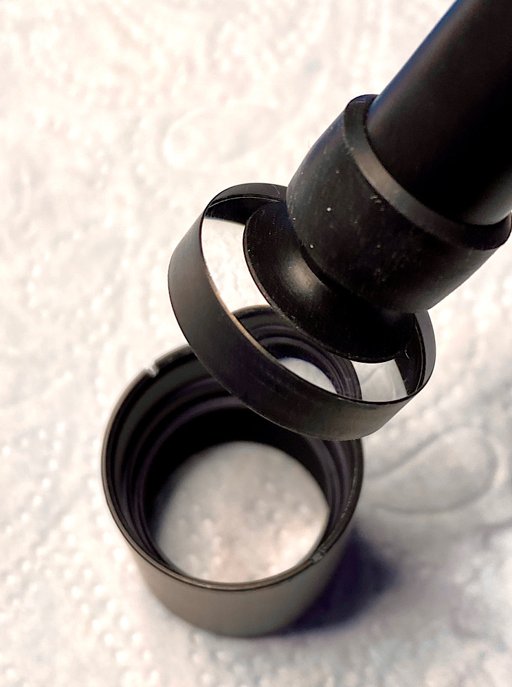

The components of the rear optical assembly.
X-ray (LED light) check of the affected lens 😉
Cleaning the lens
The sequence isopropyl alcohol - lighter fluid - acetone had no effect.
Even careful scratching with the probe did not help; the contamination remained unaffected.
Only Aqua Purificata finaly removed the stubborn stuff.
Who would have thought that the weakest remedy would work best!
I have no idea what caused this heavy contamination.
Occasionally, fine traces of cleaning can be seen. But compared to the previous situation, these don't matter.
Actually, this shouldn't happen when cleaning with a damp microfiber cloth.
But maybe it wasn't me, because some fine scratches were already visible beforehand.
The assembly of the rear optical assembly went smoothly.

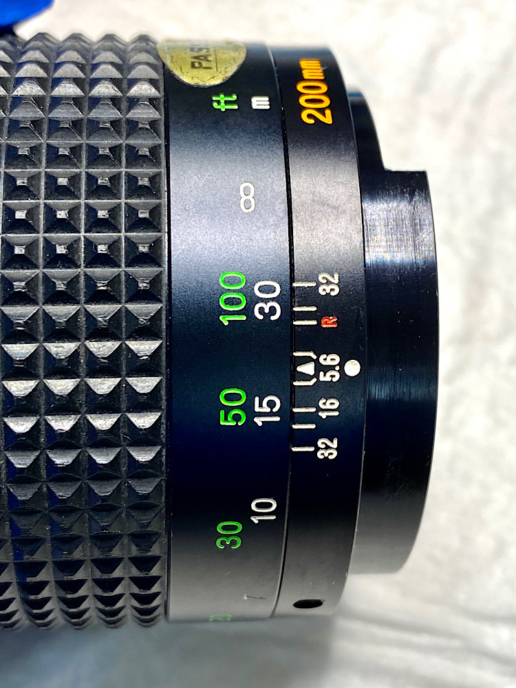

The focus ring became stiff from this position.
I suspected gummy grease in the worm gear and decided to clean and re-grease the helicoids while they were installed.
This saves having to disassemble the helicoids and the associated adjustment problems afterwards.

As always, the rest ball got some of the good, fresh grease 😎

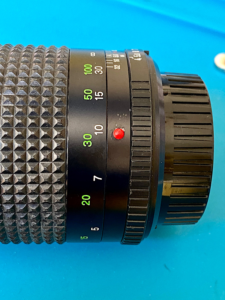

Finally, I noticed that the red marker for inserting the lens into the camera was missing.
Replacement provided an irreparable 135 mm Minolta lens that donated its point after applying isopropyl alcohol and lifting with the probe.
The Minolta 200 mm now in fine condition 🙂
