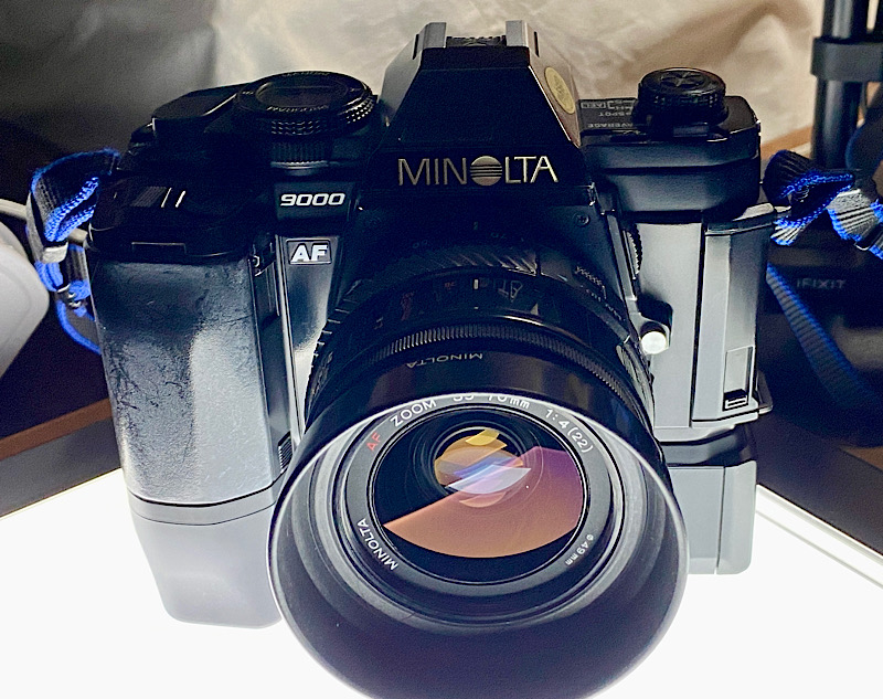

Today I had a good day: I was able to put the first 9000 AF from my repair collection into service 🙃
It's the 9000, whose shutter I accidentally and irreversibly misaligned. Today I installed a replacement.
I had previously also replaced the counter base plate because the switch contact for the AEL measurement memory was defective.

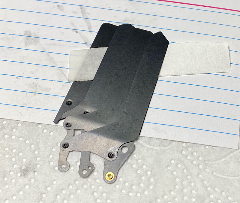

I had already cleaned this shutter with acetone from the outside as a first attempt, but didn't disassemble it, which is absolutely necessary for that. Remains of the sticky damper still needed to be removed.
I cleaned the individual parts with acetone and cotton swabs, and I also bathed the shutter curtains in acetone.
Using blotting paper strips soaked in acetone, you can clean gently and thoroughly between the slats.
To replace the rotten damper, I put narrower cut pieces of a rubber band into the bottom of the shutter housing. Glued with Loctite 401. This is where C2, the closing curtain, is cushioned.
Rubber dampers are installed for C1, the opening curtain, and they're in good working order. A rubber washer also serves as an additional damper for C2.

The shutter mechanism is delicate overall, but the aluminum alloy slats of the curtains are tough and elastic. When handling and cleaning them, you just have to be careful not to bend anything.
I only touch the shutter mechanism where I'm sure I understand its function. Here I learned from my mistakes 😬

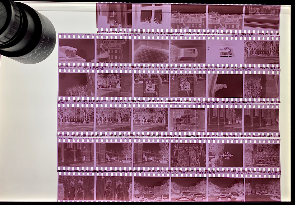

Final test on film
Today, the project was completed with the usual test on film.
Here are some shots taken around the Votivkirche in Vienna's 9th district and at home.
  • Lens was the Minolta AF 35-70/4.
  • Winder Minolta AW-90.
  • Minolta Program Back Super 90 for imprinting data.
The negatives are evenly exposed, the autofocus is accurate.

  • Ilford XP2 Super (400 ASA)
  • Nikon Coolscan 5000 ED
  • VueScan
  • Adobe Lightroom Classic
  • NegativLab Pro with default settings
  • no further processing

  • The cleaned shutter, fitted with a new damper, and adjusted, works perfectly.
  • Exposure errors caused by a rotting damper that clogs the shutter blades can no longer occur.
  • The exposure metering system works as it should.
