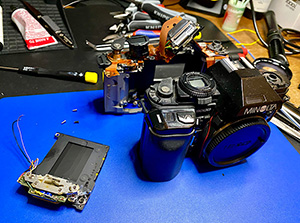

1. Malfunctioning shutter caused by a sticky damper
Problem:
At the bottom of the vertically moving Copal focal plane shutter is a damper for the rear curtain (closer), which rots and becomes sticky over the decades.
The remnants of this damper are absorbed by the shutter blades and impair the shutter action. The result is incorrectly exposed or even unexposed images.
In my estimation, every Minolta 9000 AF today is affected by this problem. This makes the camera unreliable.
Solution:
Since the shutter cannot be adequately cleaned from the outside, it must be removed, disassembled, cleaned, the damper replaced, and reassembled.
To access the shutter, the mirror box must be removed.
When the shutter is removed, it also offers the possibility of mechanically adjusting the curtains travel times. This is an option and not a must; a camera tester is required.
Difficulty level for DIY:
Medium to high
There are numerous soldered connections and cables to loosen, components to remove, and the shutter is delicate, requiring a steady hand. But it's doable with the instructions.

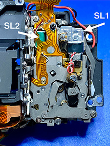

2. Malfunctioning aperture control, probably due to defective magnets
Problem:
With this issue, the aperture doesn't close, even though it's displayed correctly on the LCDs. This results in overexposed images.
I assume this is due to malfunctioning aperture magnets, of which the 9000 AF has two.
Solution:
You can try cleaning the contact surfaces of the magnets.
A more effective solution would be to replace the entire aperture control, which houses the magnets. A 9000 AF for spare parts, which has a functioning aperture control, must be available for this purpose.
To access the aperture control, the mirror box must be removed.
Medium
Disassemble the camera according to instructions.
See

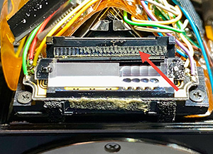

5. Defective LCD in the viewfinder
Problem:
The LCD in the viewfinder no longer displays all digits, displays only partially, or has completely failed.
This is caused by a faulty connection between the connector pins on the circuit board and the LCD.
Solution:
The connection must be removed, the contact surfaces cleaned, and then reconnected.
If the connection between the circuit board and LCD is not secured, e.g., with adhesive, a loose connection may occur when the top cover is replaced.
Medium
Disassembling the LCD unit.
See:
(Here I show a solution for the LCD of the Minolta 7000 AF which should also be applicable to the 9000 AF, as it is largely identical in construction).

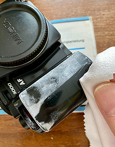

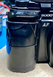

6. Plastic parts on the handle and back panel crack or fall off; whitish coating
Problem:
The plastic on the handle and back door is disintegrating.
Some 9000 AFs are more severely affected, others hardly at all.
Solution:
Cracks and broken parts can be repaired or replaced with Sugru.
Alternatively you can take the intact parts from a 9000 AF for spare parts and replace them.
See
A whitish coating, which often occurs, can be temporarily wiped off with isopropyl alcohol.
See
