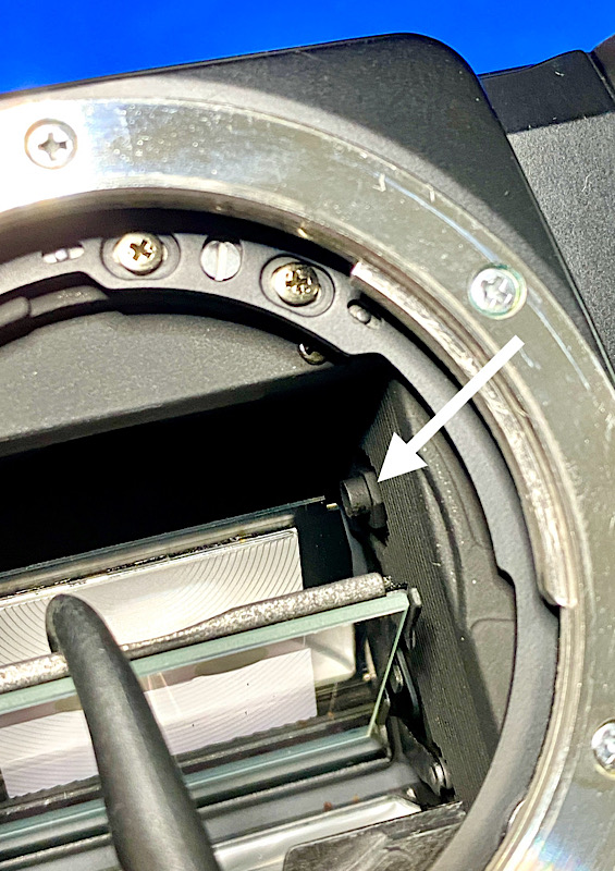

I suspected the blockage was in the mirror box area, as the process flow there was interrupted.
I could tension the aperture mechanism, the mirror mechanism was already tensioned, but I couldn't trigger the mirror to flip up. The armature of the mirror magnet wasn't holding and was loose.
So I looked to see if I could get to the mirror magnet by removing the aperture mechanism on a spare mirror box. That worked, but when I reinstalled it, the aperture mechanism no longer tensioned. So I abandoned the idea.
When I then carefully pushed the mirror upwards, the submirror stayed folded out. And then I saw that a small metal plate was blocking it.
The simplest of all possibilities!
After I removed the plate, the mirror box and aperture mechanism worked perfectly again. I'll tested it several times.
Hopefully the service manual will tell me where the plate comes from.
This gives me a good chance of getting this 9000 AF working again. As soon as I have it installed, I'll know.

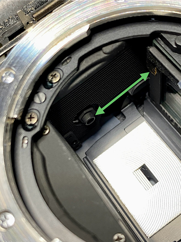

Here's the location of the metal plate under the mirror. It was glued on and had come loose blocking the underlying submirror.
It forms the stop for the eccentric that adjusts the mirror height.
And this leads directly to another weak point of the 9000 AF: a partially blurred viewfinder image if this stop, to which the mirror is adjusted, is missing.
To compensate, the mirror can be readjusted using the eccentric if the plate got lost.

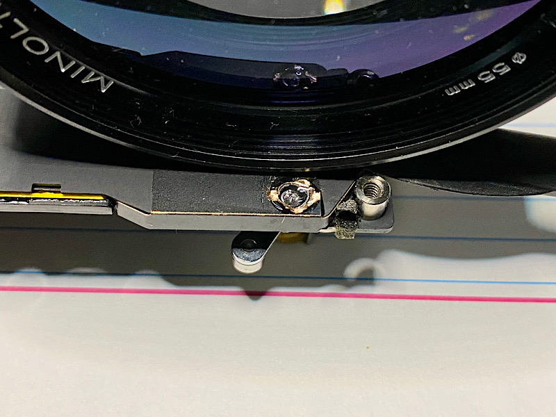

Once again, one of the four flat-head screws securing the frame for the shutter won't come off. I was able to loosen the other three screws by turning them clockwise and then counterclockwise.
This is particularly annoying because applying the screwdriver exerts pressure on the unit, which I can't directly compensate for with a counter bearing at this point; it's all very narrow and sensitive.
So I'm going back to my Dremel and this time I'll flatten the screw head with the cylindrical diamond cutter.
To protect the shutter, especially its mechanism with the two magnets, from metal abrasion, I've wrapped it in food-grade plastic wrap.
That worked. The screw head is removed, and all the components underneath can now be removed.
The damage around the screw hole is only cosmetic and does not affect the function of the shutter.
I did the fine work with a narrower and conical diamond burr.
The rest of the screw remains in the thread, flush with the bushing onto which the parts are mounted. The parts are then secured with epoxy.
The sticky damper residue has been removed. There were only a few sticky spots on the closing shutter curtain (C2), which is cushioned by the damper. I cleaned them with acetone and a cotton swab.
Everything's clean, now I replace the damper with a piece of rubber band, which I cut to size and glue with Loctite 401. Then the shutter is assembled and the curtain travel times are set on the camera tester.
For details see
Of course, non-destructive removal of the screw would be preferable.
Perhaps it would be possible to drill out the screw and tap a new thread, but since the steel screw sits in a bushing (made of softer metal?), that would be difficult.
Since I don't want to subject the shutter further to mechanical stress, and I don't have a precision mechanics workshop, I'll stick with the method shown.

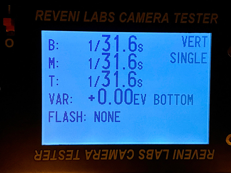

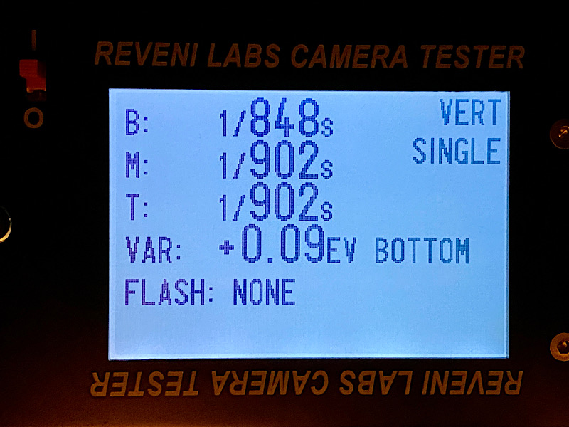

First measurement of the curtain travel times on the Reveni Labs Camera Tester. C1 is slower than C2.
Since an increase in time requires resetting the respective curtain, I adjust C1 to match C2.
I don't know the reference curtain travel time; following Minolta, it's around 3.3 milliseconds. I will go for 3,18 milliseconds.
Perhaps this will shorten the shutter speeds, but as long as the speeds series shifts in parallel, that's secondary. The first priority is that both curtains travel at approximately the same time to prevent uneven exposures.
After a few adjustments/tests, the curtain travel times are almost identical. I'll leave it at that.

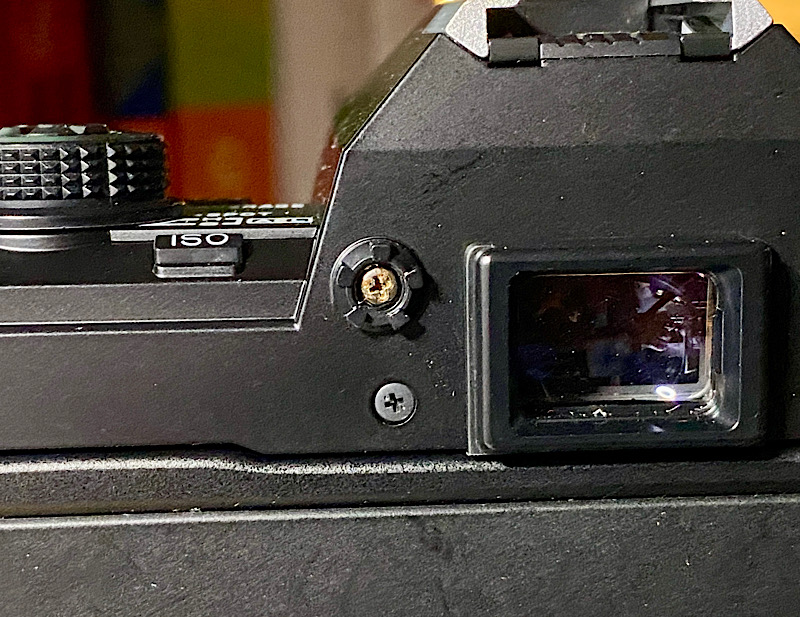

The missing screw has been replaced with epoxy, which is now drying.

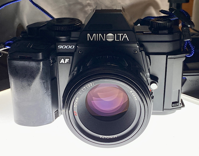

Mission achieved 🏁
The repair was successful; the aperture - mirror - shutter sequence now works as intended. The blockage has been resolved.
The shutter is also stable after cleaning and delivers consistent exposure times.

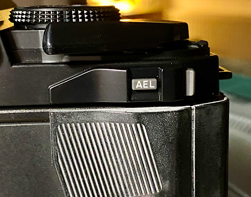

As with the 9000 AF before it, the AEL button for saving the measured values doesn't work. I suspect a defective switch on the counter base plate. I'll have to wait for a replacement part, then I'll take a look. Maybe I can repair it.
I'm also looking for the small cover plate on the dial for the diopter correction with the +/- label.
The fact that the base plate is held in place by only two screws instead of three is due to a stubborn screw that involuntarily lost its head 😌

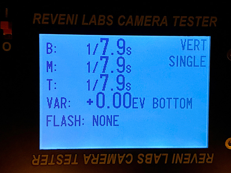

Measurement results on the camera tester
1/4000 second
The fastest shutter speed isn't reached, but the exposure is almost even.
I think I'll set the curtain travel times a bit shorter next time.

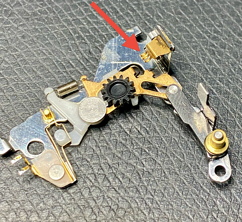

This time it was just a contact fault and not a defective switch. The AEL button is working again.
The switch with AEL button and contact on the top cover
The mating switch is located on the counter base plate, which is marked here with an arrow.
In order to remove and examine it, the dial above it must be removed.
The underside of the counter base plate. The arrow points to the contact actuated by the AEL switch.
The contact on the plate …
… and the mating contact on the circuit board.
Electronics cleaner solved the problem.

The aperture and mirror mechanisms are interconnected. By going through these processes, you'll understand the connections.
This determines the solution to a problem with the aperture mechanism or the aperture magnets:
  1. Cleaning the magnets,
  2. if unsuccessful, replacing the complete aperture control base plate from a donor 9000 AF, whose aperture mechanism and magnets are functioning.
All processes shown are described in detail in the Minolta service manual starting on page 87 (reader) „Mirror Box Assembling 2“.
All information provided without guarantee and use at your own risk.
Blur in the viewfinder: Reattach the mirror stop
One of the known issues of the 9000 AF is blurriness in the viewfinder, even though AF and manual focusing via the LED light balance produce sharp images on the film.
This is caused by a small metal plate attached to the underside of the mirror frame as a stop, which has since come off.
The height of the metal plate is part of the adjustment. If it's missing, partial blur occurs in the viewfinder because the mirror is no longer perfectly parallel to the focusing screen.
The metal plate rests on an eccentric screw in the mirror box, which serves as a support for the mirror.
The metal plate that is glued on is stressed by the mirror impact and after decades the glue can loosen and the plate falls off.
This plate was blocking the submirror on my 9000 AF and thus the camera.
If the plate is lost, you can adjust the mirror using the eccentric screw while looking through the viewfinder.
I still have two plates and reattached one of them today.
The remaining old adhesive on the mirror frame can be removed with acetone.
Two metal plates that have come off. You can see the stop point on the eccentric screw as a bare spot.
After a bath in acetone, adhesive residues can be completely scraped and rubbed off the plate.
The plate must lie flat on the underside of the mirror.
The plate is back in its position, glued with a double application of Loctite 401, which dries quickly.
The submirror can be carefully spread slightly away from the mirror to get better access.
Adhesive tape and the spudger from iFixit with hook fix both mirrors against spring tension while working.

Loctite 401, highly fluid, didn't hold; there are probably minor bumps on the two bonding surfaces.
So I'll try Loctite Gel.
