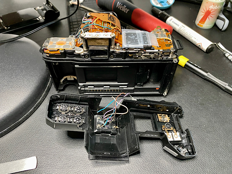

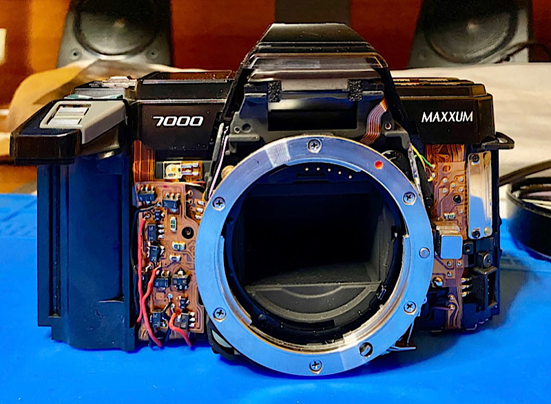

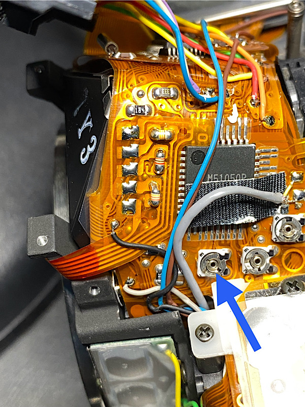

1. Preparation for checking/adjusting (p. 121)

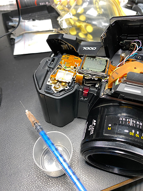

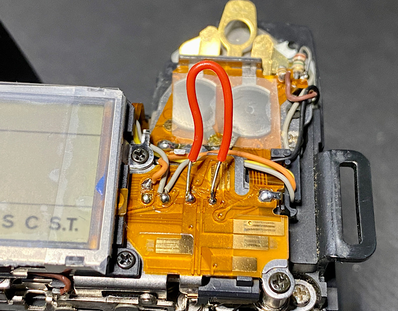

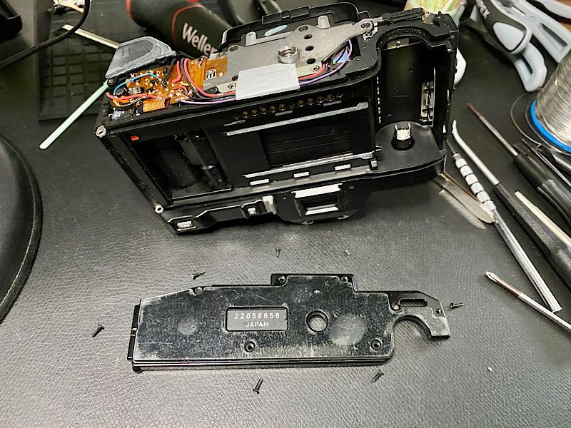

To do this, the top cover is removed and the connecting cables for the flash shoe are desoldered from the circuit board.
The bottom plate is removed.
The power supply is provided via the battery holder.
Since the main switch is also gone when the top cover is removed, the corresponding switch contacts are bridged with jumper wire so that the 7000 is ON.
Now you have access to most of the board with potentiometers for adjustment and test points for measurements.

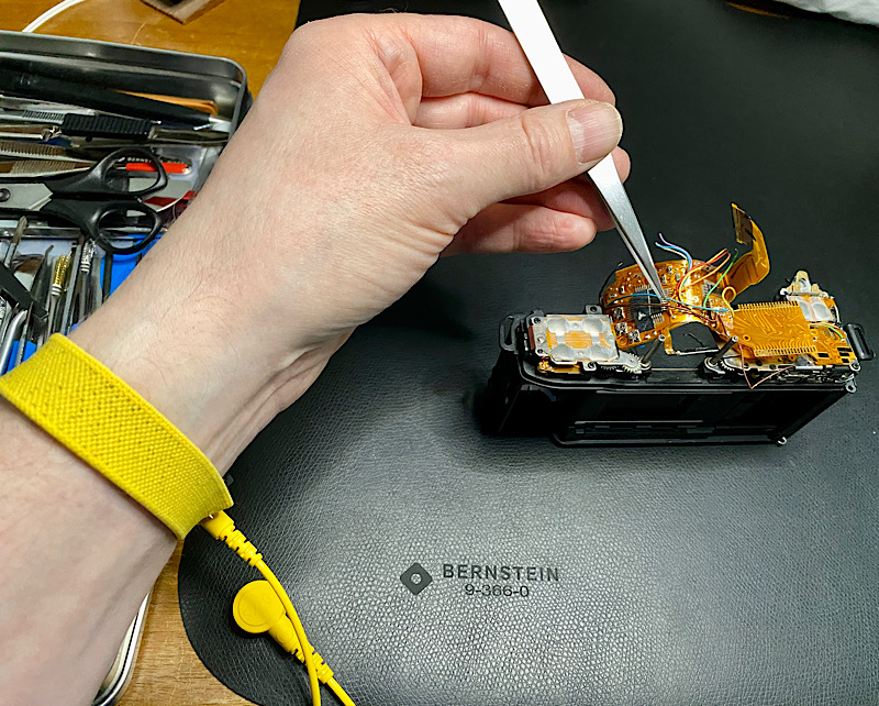

Since the ICs of the 7000 AF are susceptible to electrostatic discharges, ESD (electrostatic discharge) safe work should be carried out, see:
Post in thread 'Minolta (Maxxum/Alpha) 7000 AF: Aperture issues resolved/shortcut; LCDs, aperture ring, shutter unit replaced; aperture solenoid cleaned'
https://www.photrio.com/forum/threa...aperture-solenoid-cleaned.211422/post-2867118

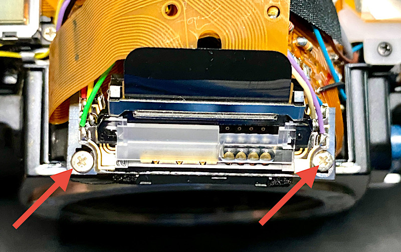

4. In-finder display position adjusting (p. 124)
This adjusts the reflection of the LCD and the LEDs for AF and flash into the viewfinder.
To do this, loosen the two screws securing the in-finder display unit to the prism and adjust the viewfinder display according to your vision by pushing back and forth and tilting.
The goal is to position the display parallel to the lower edge of the viewfinder in a freely selectable area.

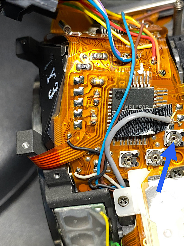

5. Exposure adjusting (p. 125)
The AE level is set as a voltage value using a variable resistor (VR2).
This should allow the light meter to be calibrated using a camera tester.
I'll look into that soon.

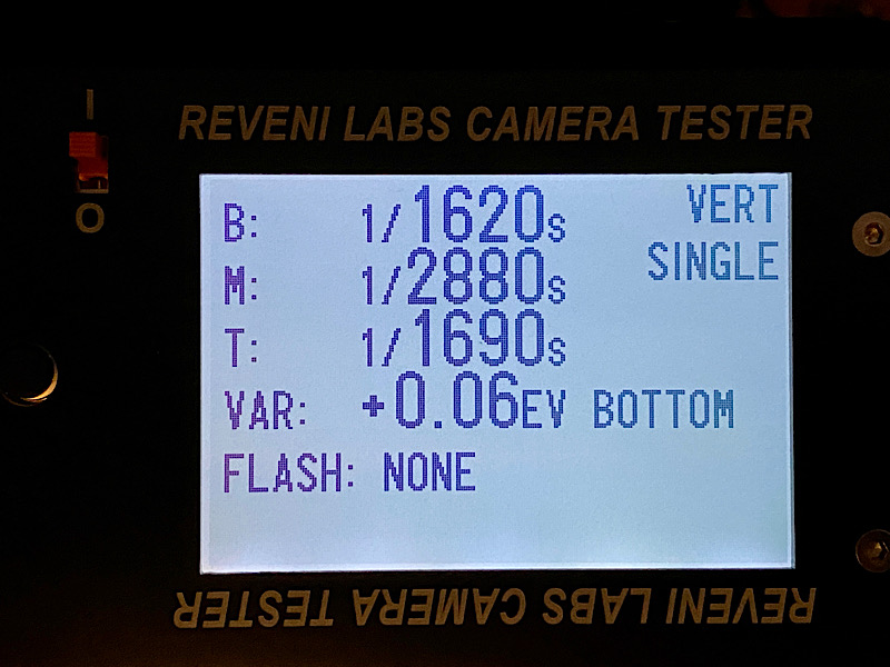

6. Manual shutter speed, X delay time checking (p. 126)

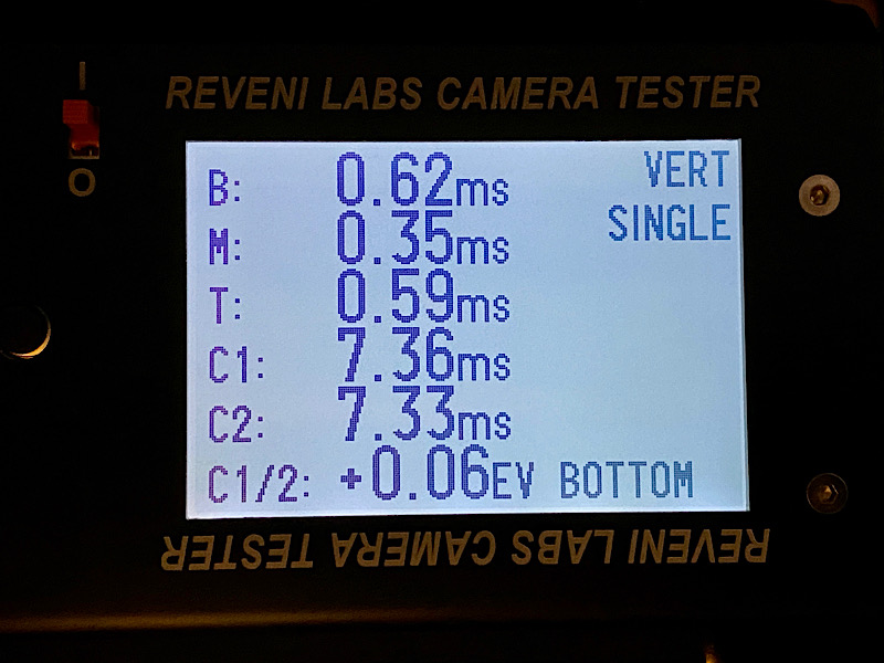

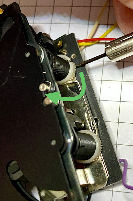

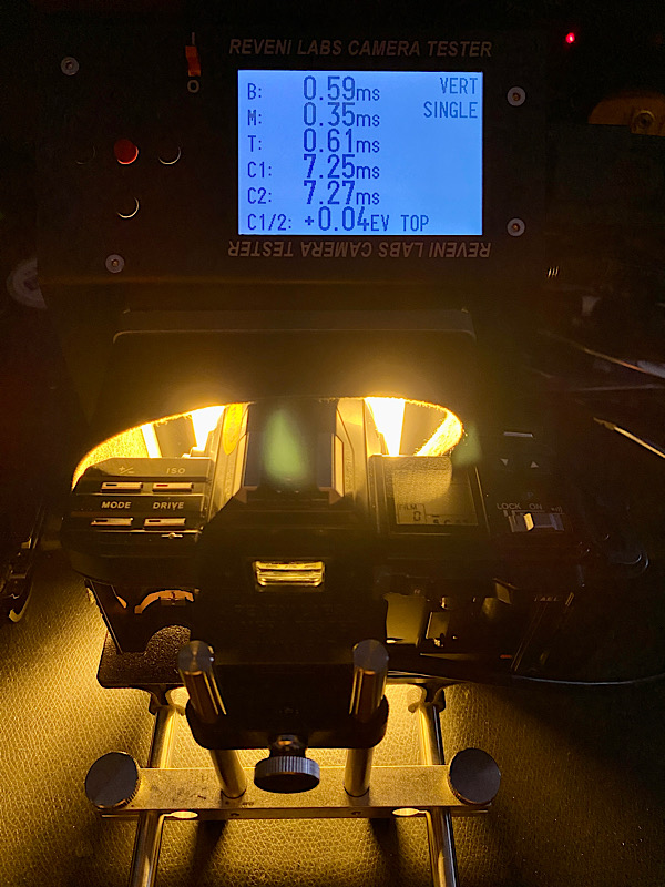

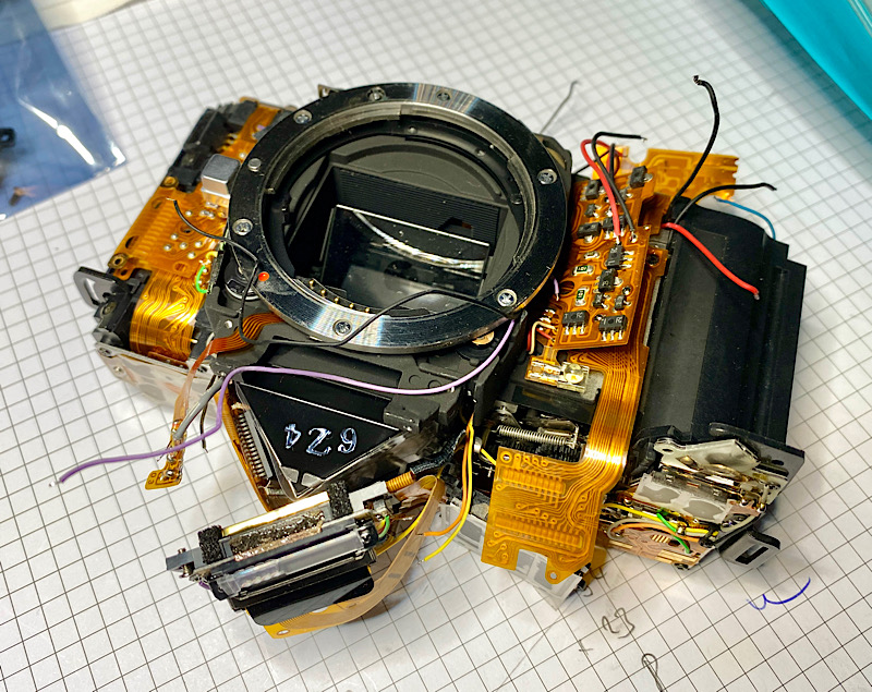

The travel times of the two vertically moving curtains (curtains travel times) are set to a target value (7.2 milliseconds) using two ratchet wheels. This changes the tension of two coil springs built into the Copal S shutter.
For this the mirror box of the 7000 AF has to be removed as well as the shutter.
If both curtains (C1, C2) move at approximately the same time, the image is evenly exposed.
The target value ensures that the shutter speed times are correctly maintained.
A shutter tester capable of displaying the curtains travel times is required for measurement (eg. Reveni Labs Camera Tester as shown on the picture).

As far as I understand, the X delay time, including all other shutter speeds, is set correctly when the curtain travel times are adjusted.
The electronics of the 7000 AF control the release of the curtains at the correct time interval; I am not aware of any separate setting option.
7. A/D conversion reference voltage adjusting
As a SLR with a clocked computer system, the 7000 AF converts analog values into digital signals for further processing.
These analog values are voltage values generated by sensors (eg. silicon measuring cells for brightness detection) or potentiometers translating a switch position.
Voltages are an analog quantity with any number of subdivisions; digital values are fixed, graduated ranges into which voltage values of a specified magnitude fall.

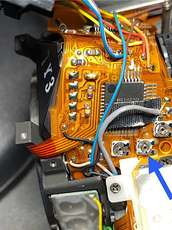

This conversion from analog to digital is the task of the A/D converter, which requires a fixed voltage supply. It is set as a target value via the variable resistor VR1 using a multimeter.

8. AE adjusting (p. 128)
This adjusts the camera's exposure metering system.
The setup shown in the service manual is no longer available. Fortunately, there are new devices that can assist with this task, as the camera testers from previous decades are also unavailable.
The service manual describes the target values for the EV (exposure values) 6, 10, and 15, which are set using the variable resistor VR2 (see above 5. Exposure adjusting) for aperture priority, shutter priority, and program.
I will perform the procedure on the Reveni Labs Camera Tester and report back.

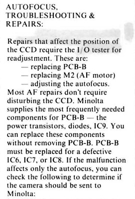

10. AF checking/adjusting (p. 132)
This is about the heart of the then-revolutionary 7000 AF.
Minolta used its exclusive I/O tester to adjust the AF, which is no longer available and was presumably only operated by Minolta itself. Special AF targets are also required for testing.
But the SPT Journal puts this into perspective:
SPT Journal, 1987
An interesting alternative procedure for adjusting the AF is described by Larry Lyells in the C & C Troubleshooting Guide for the 7000 AF.
This should make it possible to adjust the AF as accurately as possible without special equipment.
I'd like to look into this soon and report on it.
Further information on the topic „checking and adjusting“ can be found in the SPT Journal and C & C Associates Troubleshooting Guide, see below.
