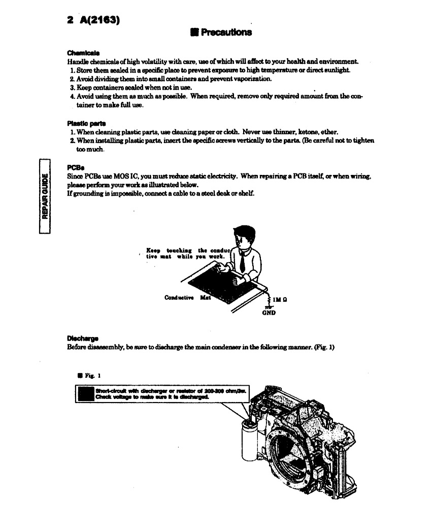

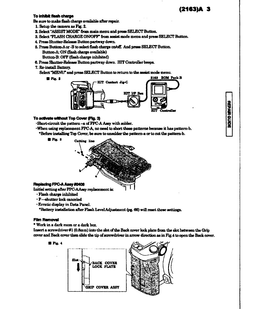

I looked through the repair manual:
  • No information about the problem (troubleshooting).
  • The camera contains a capacitor for the built-in flash, there is a procedure for discharging it. Without more detailed knowledge of the circuitry of this capacitor, I strongly advise against opening the camera (risk of electric shock).
  • As with all cameras of this generation, the electronics dominate the field. Only the Minolta service could make settings. The inner workings are complex.
  • I therefore think it is not advisable to open the camera to look for problems.
I would not touch it.
That's one way of dealing with the risk.
Another way is to not use the flash so the cap doesn't charge, leave the camera alone for maybe an hour or so and only then open it up.
Note the flash cap only charges when needed. Otherwise it would be a massive waste of batteries.
There is also the possibility of electrostatic discharge, which can damage components, and then you have to bring the system back up again.
But everyone has to know what they are doing as always 🙂
