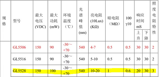

It ought to be possible to determine the range of resistances needed by temporarily installing a potentiometer, but I have not tried this. Instead, I've simply taken my best guess. In the case of a Konica S3, my first attempt was wrong (20 megohm dark resistance was much too high for that camera). But once we eliminate the parts which are too large, or which operate outside the spectrum of visible light, the selection process becomes easier.
https://eu.mouser.com/c/optoelectronics/optical-detectors-sensors/photoresistors/

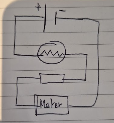

However, I had an idea. The only indication in the manual is that at EV11 the meter needle is in the standard position. So if I gradually power the meter using a test power supply, I should be able to determine at what voltage the needle reaches this standard position.
Since lux ≈ 2.5 × 2^EV, then 2.5 × 2^11 = 2560 lux. It should therefore be enough to find a CdS cell of the right size with a resistance curve corresponding to about 2560 lux. Then I could subtract this CdS resistance from the 1.3V battery voltage and adjust the remaining voltage with a resistor to reach the standard needle position at 2560 lux.
So the idea would be:
standard position voltage = 1.3V − CdS resistance at 2560 lux − adjustment resistor.
From an electronics perspective this seems simple enough, but I don’t know whether this reasoning actually applies to photographic exposure systems. Since you have more experience in this field, what do you think?

Safe path would be to insert a potentiometer instead of the CdS, adjust to get the reading for EV11 in the meter, and use that resistance to look for a CdS cell matching it at 2560 lux.
Don't forget that when it's installed in the camera, that CdS cell sits behind a variable mask or slit which reduces the amount of light reaching it. That's why I felt some trial-and-error would be involved.

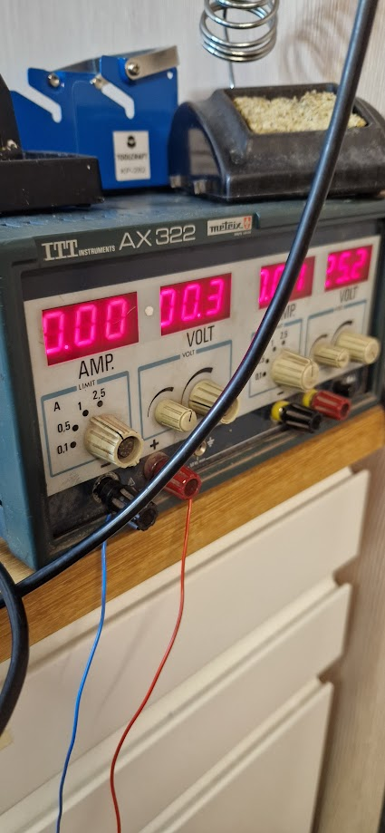

Hi guys, thanks for all your replies — I really feel well supported on the forum!
I’ve carried out the first power supply tests on the galvanometer. Based on the needle reading, at an exposure of EV11 the galvanometer should be supplied with a voltage of 0.3V, so I decided to follow your advice.
I bought a box with various resistors and a CDS cell. To run my tests, I’m planning to sit in a dark room and use a Raleno LED panel. I’ll calibrate the distance to obtain EV11 using my phone’s light sensor. Once the EV11 area is validated, I’ll just need to position the new CDS inside the lens to account for the attenuation from the ISO setting mask. With the output value measured, I’ll then fine-tune it by adding a resistor to obtain 0.3V at the output.
