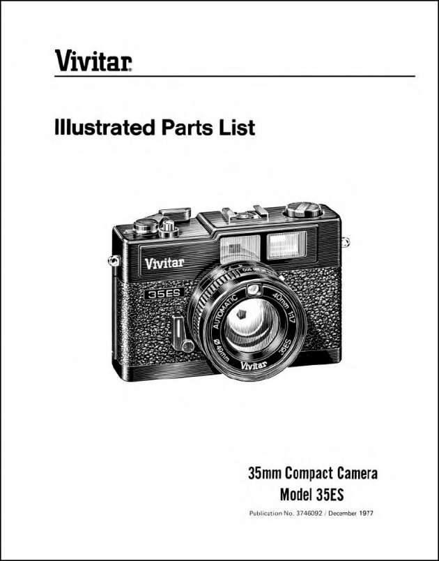

I just opened up a Vivitar 35ES which I believe is virtually identical.
There should be 2 screws under the rewind knob; the advance lever screw has a normal thread.
One the top is free, watch for the flash wire and the shutter button which will be loose.
There is a cover glued on the VF/RF unit, with the meter wire taped on it.
As said, be careful with the silvered beamsplitter. The front section of the VF has two lenses, with the gap covered by a piece of tape. The inside surfaces are hazy on mine and I wasn't able to properly clean them.
My camera had a very wobbly lens. All the screws front and rear holding the shutter were about to fall out. The meter needle was sticking. I think the helicoid needs tightening as well, and the aperture feels a bit sluggish. How snappy is it on yours?

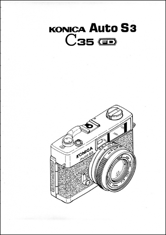

And I agree, the Hi-Matic 7sII (there were actually TWO, slightly different versions) is basically the same as the Vivitar 35ES, as well as the Revue 400 SE & Revue 400 SE 25 -- and maybe the Konica Auto S3!
Yes I believe the the Konica Auto S3 and its twin the C35 FD are the same as the others. The Minolta is the odd one out with a manual aperture control, vs. the auto flash aperture of the others.

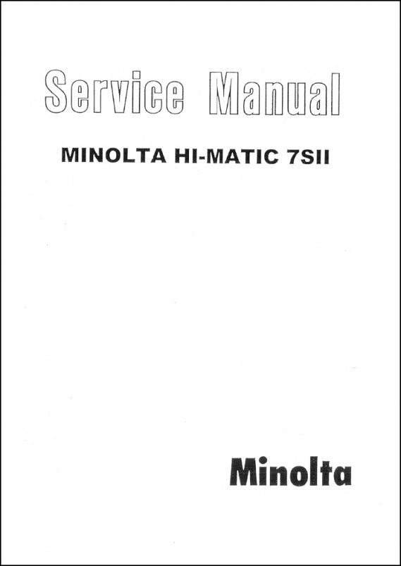

Eugene Pate has a scan of the Himatic 7sii factory service manual at
also a tutorial showing work of that model
he wants about 3 dollars per file, which partly covers the bandwidth to keep the site up.
the factory manuals often are Just exploded views of each part of the camera, BUT that will show you EXACTLY where the screws are.
I have an account at LEARN CAMERA REPAIR. I should have thought of that. I'll also see if they have an Olympus RD35 service manual -- I have TWO that have a stuck shutter releases.

Oh, and there's this guy's great comparison that shows that the Auto S3 does not in fact seem to be the same camera as the 7sII/35ES/Revue 400SE family.

For what it's worth I ended up servicing the aperture and helicoid on my Vivitar. I used the service manual for the 7Sii. Pretty much interchangeable apart from the manual aperture system (plus the Minolta switches off the meter in manual mode).
The helicoid system has a design flaw which makes it difficult to adjust axial and radial play. I cut notches in the helicoid keys in order to expand their width, for a better fit in the rails of the translating helicoid. You would need a special washer to eliminate the axial play.
I got the idea from the Konica Auto S3 service manual. The Konica is indeed different as was pointed above, and a more refined camera than the Vivitar.
