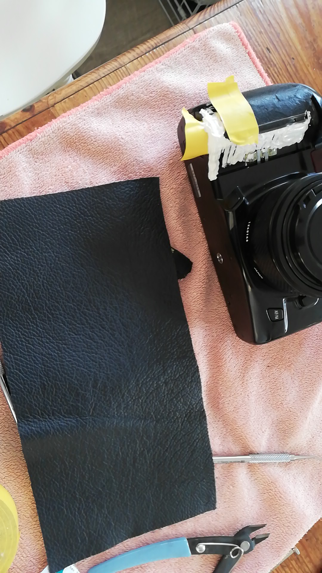

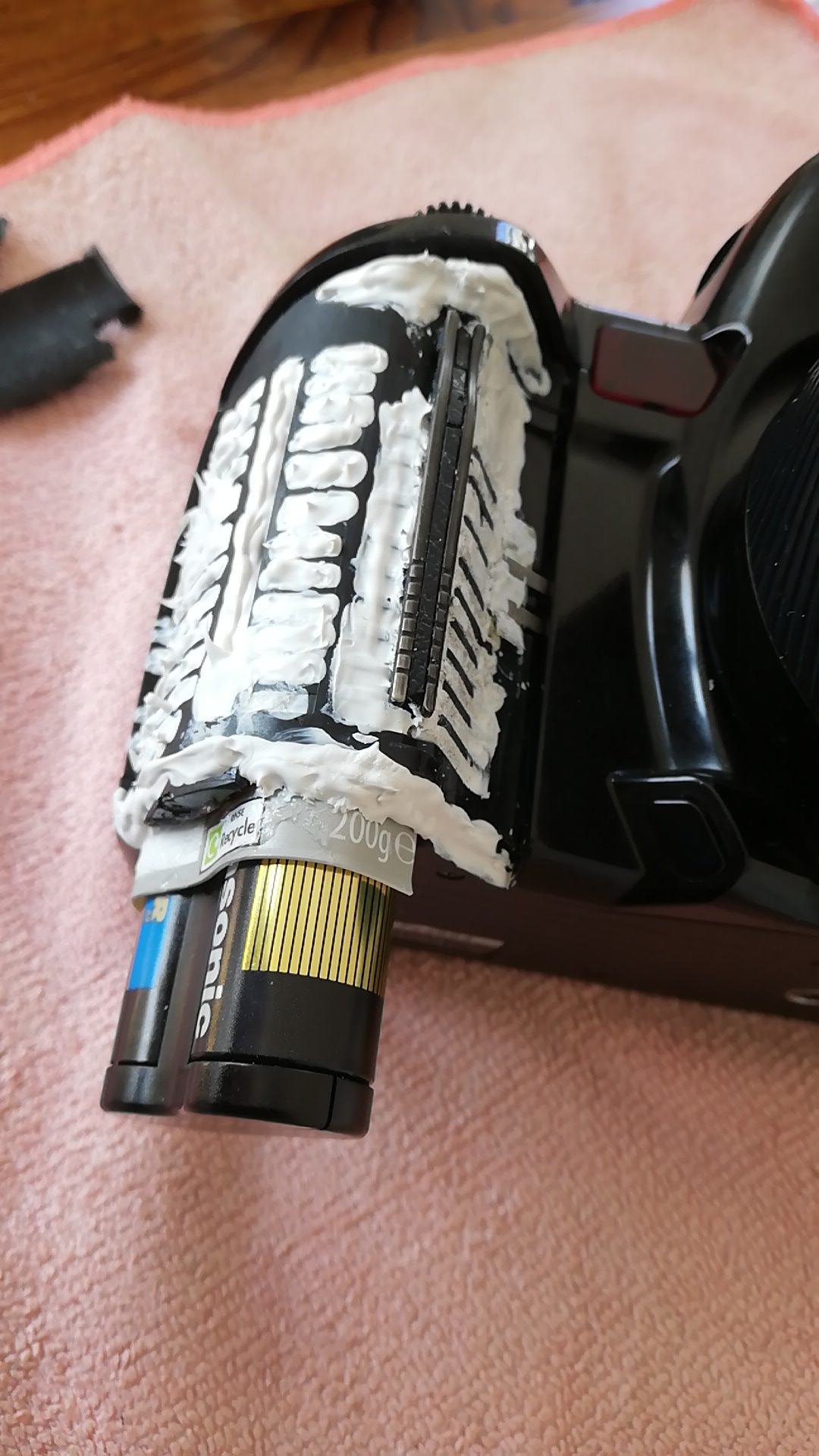

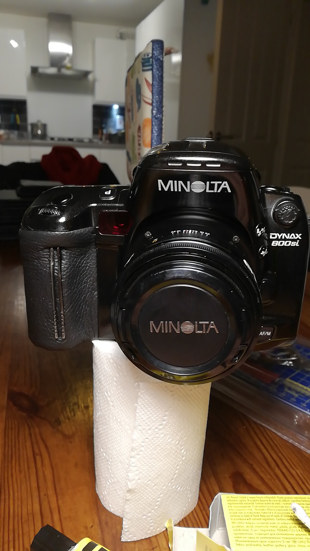

Repaired my Minolta 800si with leather. Removed old grip, built up base with plastic putty, carefully filed that down to correct level, glued on leather tucking it in at top and two sides and neatly trimming at bottom. Worked really well. Started leather by fitting neatly around eye start sensors and slowly worked in top and lens side, then outer side, and finally the base. Hope this may prove helpful to others.

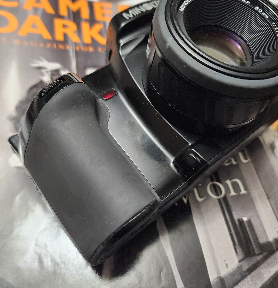

I used Sugru on my 600si. The grip was toast so I removed it, taped it off and started molding using fingers, popsicle sticks, a dowel and anything else I could find.
Final touches were with fingernail to clean lines between plastic and Sugru.
This was my first time using the stuff and really like the way it looks, feels ever so slightly soft.

Looks fantastic! I think it is great that others who face the same problem will have a variety of choices to repair their camera. 📸🙂
Repaired my Minolta 800si with leather. Removed old grip, built up base with plastic putty, carefully filed that down to correct level, glued on leather tucking it in at top and two sides and neatly trimming at bottom. Worked really well. Started leather by fitting neatly around eye start sensors and slowly worked in top and lens side, then outer side, and finally the base. Hope this may prove helpful to others.View attachment 377609View attachment 377610View attachment 377611

Where did you get your leatherette?
I got a bag of scrap leather material from Amazon.uk. Cost about €10 delivered. There are lots of suppliers if you search under "scrap leather material" on amazon.
There were three bits in black or dark grey, enough to do several cameras, and I have two 700si's and and an 800si to do unfortunately.
There were lots of other coloured bits in the bag if you fancied something doing a bit of bling on the camera.
Martin
Hi, sorry for the late reply. Got the leather (real leather not leatherette) off of ebay. It's quite easy to find inexpensive off-cuts.
Hi Andrew,
Which glue did you use to stick the leather ot the camera?
Many thanks
Martin
Hi, sorry for the late reply. Glue was UHU but any regular contact adhesive / glue will do.
